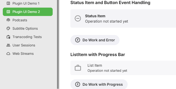

softworkz 5133 Posted January 7, 2025 Posted January 7, 2025 Updating the UI is demoed in the new Plugin UI Demo project - when you press these buttons:
