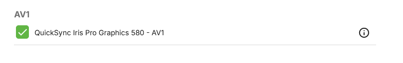

Oldjuju 4 Posted August 5, 2025 Posted August 5, 2025 On 14/05/2025 at 14:23, Sparxle said: I noticed and checked out the new option to always trancode AV1 on the Shield and it is working fine. Thank you! Hi, I'm running the nvidia shield with Emby for Android TV 2.1.23g. When I play one of these files, my server's fans prepare for take off. The video playback is fine, but the fan noise is nuts. My server is a NUC6i7KYB with Intel Iris Pro Graphics 580 integrated GPU and 8GB RAM. Where is this option? On the emby client on the shield? I have this option on the server. thanks, Cam
ebr 16354 Posted August 5, 2025 Posted August 5, 2025 50 minutes ago, Oldjuju said: Hi, I'm running the nvidia shield with Emby for Android TV 2.1.23g. When I play one of these files, my server's fans prepare for take off. The video playback is fine, but the fan noise is nuts. My server is a NUC6i7KYB with Intel Iris Pro Graphics 580 integrated GPU and 8GB RAM. Where is this option? On the emby client on the shield? I have this option on the server. thanks, Cam Hi. That app already transcodes AV1 as evidenced by your server machine working harder. Try searching for our standard android app (Just "Emby" on Amazon and "Emby for Android on Google) on the same device's app store and see how that compares? Thanks.
Oldjuju 4 Posted August 6, 2025 Posted August 6, 2025 Thanks for the reply. You'll have to excuse my ignorant questions here... I thought that if the server's GPU could handle the transcoding, the CPU wouldn't run as hot and the fans wouldn't be noisy. So if the "Emby for Android TV" already requests AV1 videos to be transcoded, it should all be nice and quiet. I did install the "Emby for Android" on the shield and played the same video. The fans didn't kick into gear, but the video was choppy.
Neminem 1630 Posted August 6, 2025 Posted August 6, 2025 Have a look at you GPU, it look like it does not support AV1 in Hardware transcoding. The reason for you CPU coolers ramping up, is the Emby will then fall back to CPU to transcode it. Intel Iris Pro Graphics 580 Benchmarks & Specs 1
