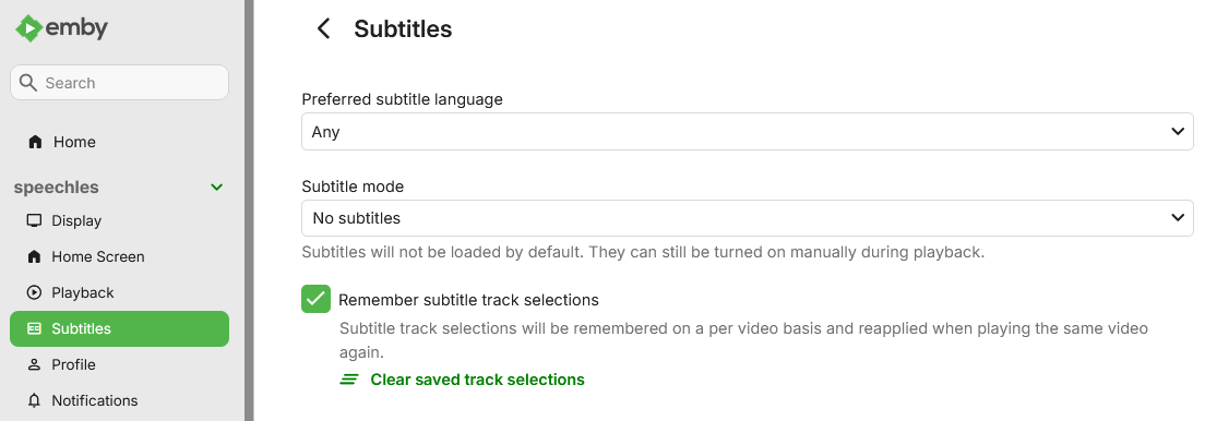

speechles 2062 Posted January 5, 2025 Posted January 5, 2025 (edited) What do you have set for the subtitle mode? Emby must change the Roku caption setting when you choose to enable or disable captions/subtitles. If you choose "OFF" on subtitles from the Emby Roku OSD it turns them off and "off always" in the Roku global settings. It you choose a subtitle from the subtitles menu it will enable subtitles "on always" in the Roku global settings. Otherwise you cannot see them. The Roku will respect your Emby settings. It sounds like you want to choose "No Subtitles" for your subtitle mode. Also clear the saved track selections if previously you played any with subtitles and wish them ALL to be disabled. When "No Subtitles" is used Emby will always turn off subtitles when an item starts to play on the Roku unless you have turned them on before for that item and used a subtitle before. It will remember what has occured before with your files and present them that way for next time. Edited January 5, 2025 by speechles

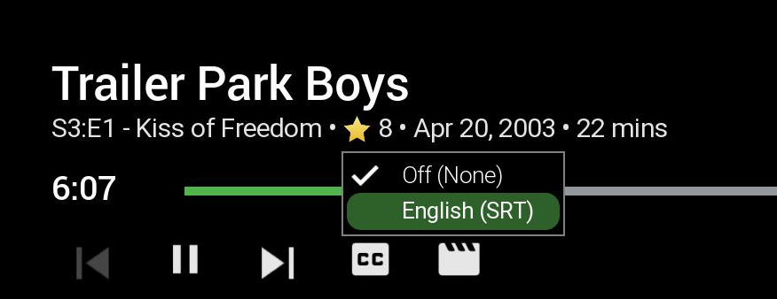

pwhodges 2033 Posted January 5, 2025 Posted January 5, 2025 As far as I can tell, it is Roku doing this, not Emby. My problem is the opposite, though - I set the Roku subtitle setting to "On always", and a while later I notice that live TV (it's a Roku TV) no longer has subtitles and I have to go through the star menu again. In fact, thinking about it, the Emby subtitle settings are as stable for me on the Roku as they are on other clients. I don't use the star for subtitles in Emby, though - I use down-arrow and scroll over to Emby's CC button, if my server settings are not already giving me what I want. Since I often have multiple subtitles I need to do it this way to be able to choose. Paul
Gilgamesh_48 1243 Posted January 5, 2025 Author Posted January 5, 2025 (edited) No matter what Emby should NEVER touch the chosen subtitle mode on my Roku or, if it really has to, it should change the setting back when exiting the playback. (I could live with that as it would really be no impact for me) But if I have subs off and i play an MKV file that has subs on and I turn them off in the playback using the down arrow and then go to another app that has subs as a possibility then I find that subs on the Roku are set to on. This is simply wrong. NO APP on the Roku should ever change Roku's settings and then leave them that way. If I generally do not want subs, but do from time to time, I should always find Roku's setting upon exiting any app exactly the same as they were when I entered the app. I set the Roku up the way I want it but Emby thinks differently so changes my settings. This is a BUG and should be fixd. If it is the way subs on the Roku are designed to work then it is a major design flaw. BTW: The apps for ESPN or paramount+ or Peacock or any other app I use do NOT make any permanent changes to my Roku even if I turn subs on (Which I sometimes have to do even for Spanish or German broadcasts those are languages I understand, because the announcers get too fast for me to follow. When I exit the apps my Roku's setting are always the way they were when I entered. That is if subs are off when I enter Paramount+ with subs turned off on my Roku and watch an event that causes me to turn them on inside the app, if I then exit Paramount+ I find my Roku settings exactly as they were upon entering, I am not asking for Emby's Roku app to do anything special for me I am simply asking that, if something must be changed inside the app while I am using it, that it get changed back upon exit. Other apps can do that, why can't the Emby Roku app. I get very tired of fixing what Emby messes up in my Roku settings even if I don't actually use subtitles in Emby. I do not want to turn subs off in the server's settings because, if I do the, then the very movies/TV shows that I need subs for cannot turn them on until I o into the server and set the back on. Please just put things back as you found them after exit. I have had to tell my kids that several times but I should not have to tell professional developers such obvious behavior things. Edited January 5, 2025 by Gilgamesh_48
