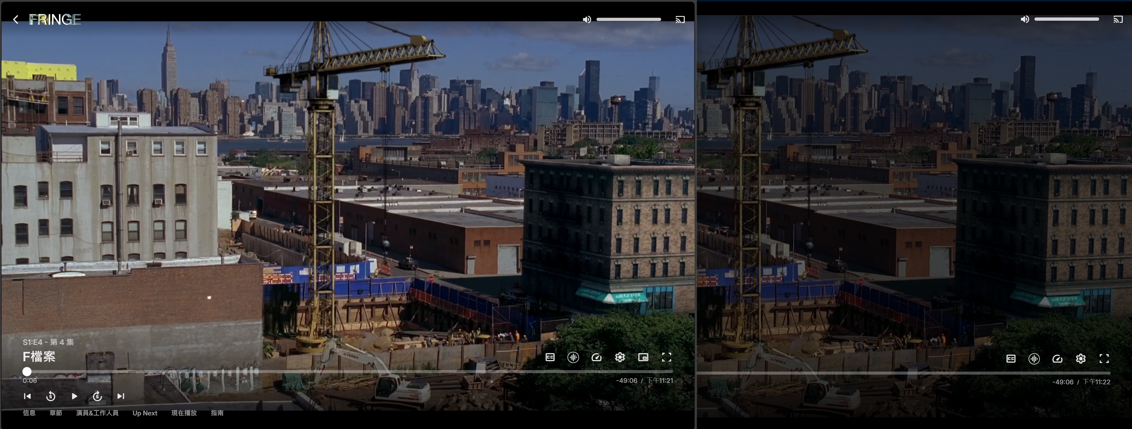

In the image embyWindowsDull.png, the left one is from the Emby Web 4.8.10.0 and the right one is from Emby Windows 2.207.2.0.
The Windows app look very dull.
Did I set something wrong for my Emby Windows?

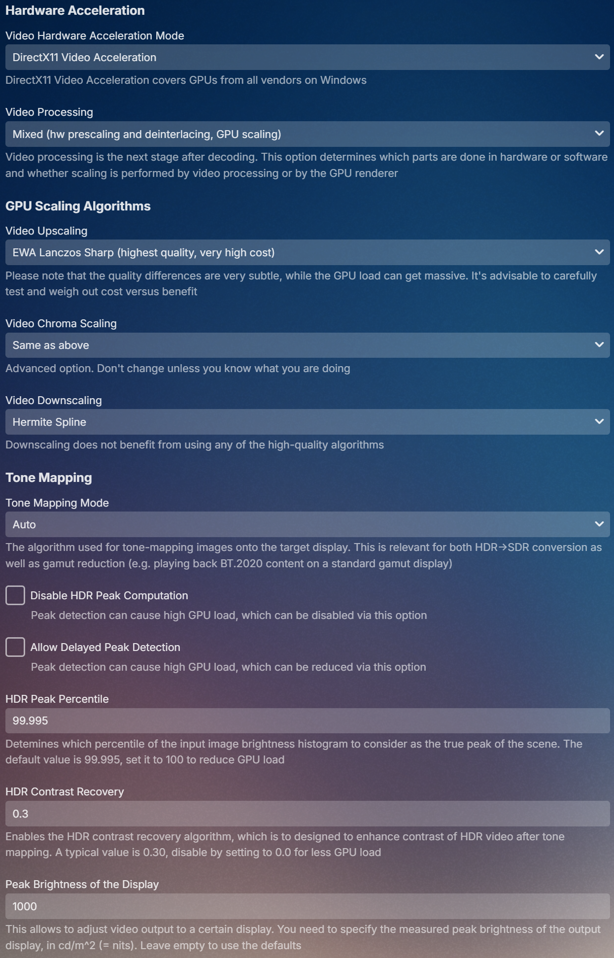

What video settings are you using?

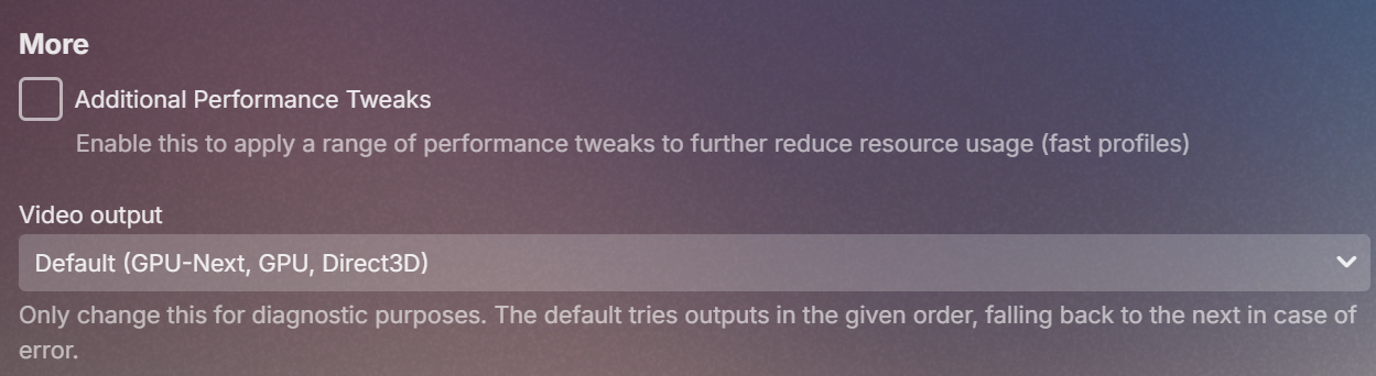

I can't find anything special about the video setting which may cause the issue.
  • Solution
You have peak brightness set to 1000. Unfortunately, this also effects SDR media. If you remove that and leave it blank, the picture will be bright again
