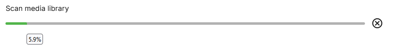

guill69f 17 Posted January 4, 2025 Posted January 4, 2025 Hi, I have a large movie library, 8000+ files. I have renamed them all outside Emby, using Tiny Media Manager, and i was counting on Emby identifying the changes and doing a proper remapping. I have forced a library scan, but now it has been several hours that the status bar has been stuck on 5.9%. Should i think there is an issue and that Emby is stuck, or should i just continue to wait? Or is there a better approach (if so, which?) like wipe all movie data and library in Emby, and then rebuilt libraries from scratch?

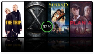

guill69f 17 Posted January 4, 2025 Author Posted January 4, 2025 Thanks, then I will wait, i understand it will take some time, just got a bit surprised that in the dashboard the task library scan has been stuck at 5.9% for at least 2 hours, but fine, i'll wait In the Library view i have another indication, but doesn't seem to move either: Anyway, i'll rest my case for now and will continue to do the monitoring. I'll post here again when scan completed to confirm all went well, or if it is still stuck by mid-week

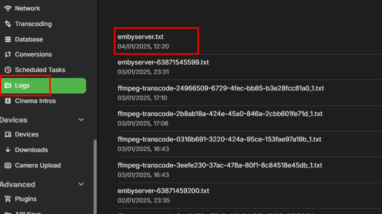

Solution Neminem 1623 Posted January 4, 2025 Solution Posted January 4, 2025 You can also follow progress in logs. Then you can refresh and scroll down and seen where it is in the process. 1
guill69f 17 Posted January 4, 2025 Author Posted January 4, 2025 Fantastic, i did not know that. I have checked a couple of logs now and i see at the bottom of the logs that the most recent ones always have new movies that the other logs don't, so i guess things are progressing as they should. Thanks! 1

guill69f 17 Posted January 6, 2025 Author Posted January 6, 2025 (edited) Thanks, will check later today. Can you clarify what you mean with rescanning the library please? On my install it looks like scanning is still active (progress bar at 6% but i am not sure it is really reliable, as it took 2 days to move from 5.9 to 6.00, while i could monitor in the logs more and more movies where analyzed), and on the library itself it shows the scan is 93% completed (here again, doubts on the reliability of the info, took 2 days to increase from 92 to 93). Should i stop the emby app to kill all processes, and then manually retrigger the task "scan library", after I have done the other suggested verifications? Thx Edited January 6, 2025 by guill69f

Carlo 4561 Posted January 6, 2025 Posted January 6, 2025 Think of the percentage shown as the number of overall steps that have been done vs overall number needed to complete. Do not think of the percentage shown in a time format. For example, 50 steps could be completed in 5 to 10 minutes and account for 90% of the steps needed to complete the scanning job. The last 5 steps (10%) could take 1 or 2 days to complete. Some steps take longer than others and might be best to turn off or differed until after the initial scanning is complete. I normally turn off these two options on all libraries until they have been initially scanned into the library. Video Preview Thumbnails & Subtitle Downloaders Checking the log file IMHO is the best method to see what Emby Server is doing while scanning. It's also a great way to quickly scan through the log to see if any errors are showing. Carlo
