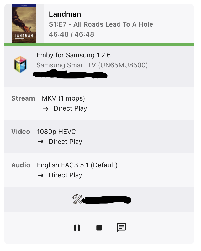

sbrindley 3 Posted January 2, 2025 Posted January 2, 2025 Hi guys, just wanted to check and see if there has been any traction on this? This has also been going on for me for months now. I've noticed it from several different devices and I've attached a stuck stream from the Samsung TV app. 1
Luke 42301 Posted January 2, 2025 Posted January 2, 2025 @sbrindley Hi there, let's look at an example. Please attach the information requested in how to report a media playback issue. Thanks! 1

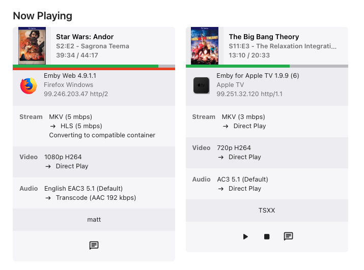

EmbyOak 23 Posted June 23, 2025 Posted June 23, 2025 I updated the AppleTVs and I have not seen one of their live streams "stick" yet. The attached images is pre-recorded content. One is via a browser the other via an AppleTV. Neither are being played at the moment and update bar confirms there is no streaming. embyserver-17.txt embyserver-63886233600.txt 1
