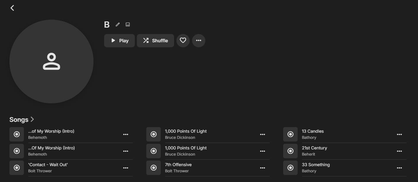

This seems to be a new thing with 4.8.10 and even the 4.9.x beta branch but in my music collection there are now artist names with just a single alphabet letter and grouping artists with that begin with that letter. This didnt use to happen and it is only happening on new servers I have set up and scanned.
The main difference between the servers is the use of SMB to load the libraries (these show this single letter group) and my main server uses the file system (and does not have these single letter artist grouping).
image.thumb.png.3fcfcff04a46fec97d0b3435101d5394.pngimage.thumb.png.8e71db9c520504f67a1f83e79be86406.png

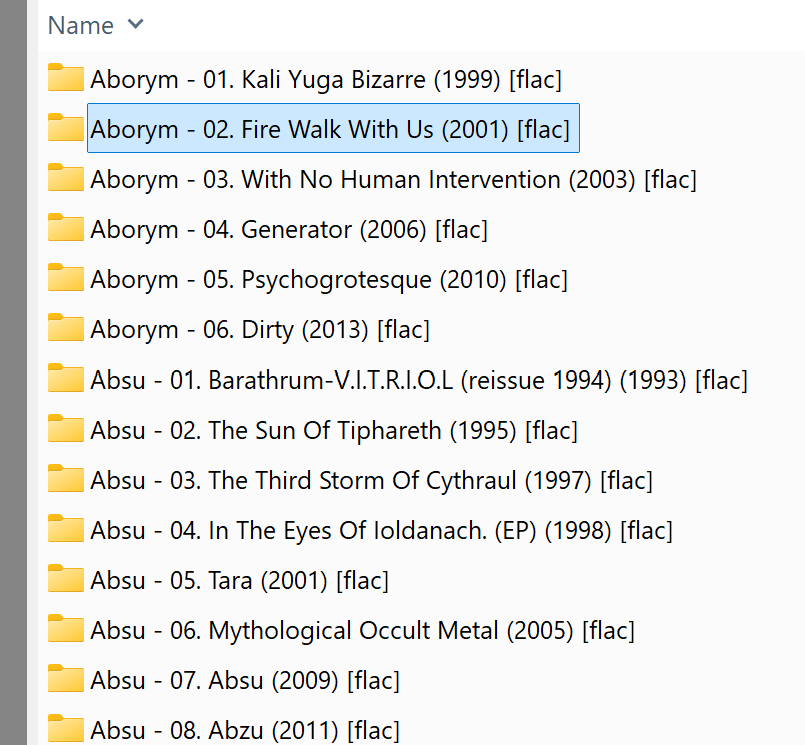

Hi, do you have alphabetic folders?
how are your files named and organized?
I found the issue...I have selected "perfectly organised into artist/album folders" instead of just "album folders", like on my main server.
I will adjust this and rescan.
