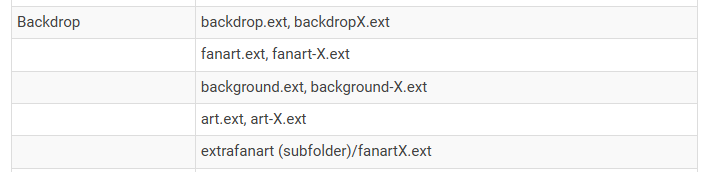

Sanduleak 0 Posted January 2, 2025 Posted January 2, 2025 (edited) Hi again. As I said in a previous post I am in the process of jumping from Plex to Emby and I have identified some small problems that maybe need correction (not sure if the corrections are in the development side or in my side). Just to be clear, I know that the recomended configuration is having just one file for each movie, I know it and accept it, however I have literally thousands of movies and a good percentage of them are multi file, so I wanted to try to get to the best possible configuration to try to avoid the many hours required to merge those movies. Usually I use Ember Media Manager or Tiny Media Manager to scrape movie data and have Emby make zero scrapping, just to make things clear. My normal naming is "movie-cd1.mkv", "movie-cd2.mkv", "movie-cd3.mkv"... and so on, never more than 7 files. Problem 1: Emby insists in using "movie-fanart.jpg" instead of "movie-poster.jpg" as the cover for the movie in the gallery. This doesn´t happen every time and I have not been able to isolate when it happens or what is producing it, but I have to manually select the "movie-poster.jpg" to correct it, this doesn´t happen only with multi part movies but also with one file movies. Problem 2: When I start the movie in the first file "movie-cd1.mkv" the file plays ok, but when it finishes it goes back to the movie menu, not jumping to the "movie-cd2.mkv" file as expected, curiously when I play "movie-cd2.mkv" and it gets to the end of the file it automatically jumps to "movie-cd3.mkv" and goes on and on until it gets to the last file of the movie. Problem 3: The movie is presented with an "aditional parts" menu and the first part is not in that menu (Of course I understand that is by design, but it whould be nice to have the first part also in that menu), this is not a problem, just a suggestion. Problem 4: This is the most annoying of them all. When I use Ember Media Manager or Tiny Media manager they create a "movie.nfo" with all the data but Emby insists in creating a "movie-cd1.nfo" and ignoring the "movie.nfo", my solution is just to remane "movie.nfo" to "movie-cd1.nfo" but I find it curious that Emby is capable of detecting that a movie is a multi part file but not detecting that a .nfo file with the same name exists in the same folder To this moment those are the "small problems" I have detected, I will be happy to provide any info anyone whould need. Thanks Edited January 2, 2025 by Sanduleak
GrimReaper 4843 Posted January 2, 2025 Posted January 2, 2025 (edited) 33 minutes ago, Sanduleak said: Problem 1: Emby insists in using "movie-fanart.jpg" instead of "movie-poster.jpg" as the cover for the movie in the gallery. This doesn´t happen every time and I have not been able to isolate when it happens or what is producing it, but I have to manually select the "movie-poster.jpg" to correct it, this doesn´t happen only with multi part movies but also with one file movies. "movie-fanart.ext" is not listed as one of the supported naming conventions (which doesn't necessarily mean it ain't supported): https://emby.media/support/articles/Movie-Naming.html#video-images Quote while there are several "movie-type.ext" variations for Primary (poster) images: Quote Maybe it's confusing parser, never used that backdrop naming so have no idea how would it behave, try dumping the "movie-"part from fanart filename, see how does it compare. 33 minutes ago, Sanduleak said: Problem 2: When I start the movie in the first file "movie-cd1.mkv" the file plays ok, but when it finishes it goes back to the movie menu, not jumping to the "movie-cd2.mkv" file as expected It should, specific example would be required: how to report a media playback issue 33 minutes ago, Sanduleak said: Problem 3: The movie is presented with an "aditional parts" menu and the first part is not in that menu (Of course I understand that is by design, but it whould be nice to have the first part also in that menu), this is not a problem, just a suggestion. You are welcome to open FR topic in the appropriate forum section: Feature Requests 33 minutes ago, Sanduleak said: Problem 4: This is the most annoying of them all. When I use Ember Media Manager or Tiny Media manager they create a "movie.nfo" with all the data but Emby insists in creating a "movie-cd1.nfo" and ignoring the "movie.nfo", my solution is just to remane "movie.nfo" to "movie-cd1.nfo" but I find it curious that Emby is capable of detecting that a movie is a multi part file but not detecting that a .nfo file with the same name exists in the same folder That appears as if Emby is looking for the exact <moviefilename>.nfo match (as with all the movies), and that would include "-cd1" part, @Luke? Edited January 2, 2025 by GrimReaper
Sanduleak 0 Posted January 2, 2025 Author Posted January 2, 2025 9 minutes ago, GrimReaper said: "movie-fanart.ext" is not listed as one of the supported naming conventions (which doesn't necessarily mean it ain't supported): https://emby.media/support/articles/Movie-Naming.html#video-images Never used that so have no idea how would it behave, try dumping the "movie-"part from filename, see how does it compare. Oh, the problem is not with the "movie-fanart.ext", that works fine, the problem is that, even when there is a "movie-poster.ext" in the folder Emby just ignores it and uses "movie-fanart.ext" as the cover of the movie... maybe I should try to rename "movie-fanart.ext" to one of the supported naming conventions and see if that makes Emby find "movie-poster.ext"? 14 minutes ago, GrimReaper said: It should, specific example would be required: I will try to provide that example later. 14 minutes ago, GrimReaper said: You are welcome to open FR topic in the appropriate forum section: Oh, thanks, I will.
GrimReaper 4843 Posted January 2, 2025 Posted January 2, 2025 13 minutes ago, Sanduleak said: maybe I should try to rename "movie-fanart.ext" to one of the supported naming conventions and see if that makes Emby find "movie-poster.ext"? That was my suggestion, yes, see what gives: 29 minutes ago, GrimReaper said: try dumping the "movie-"part from fanart filename, see how does it compare.
