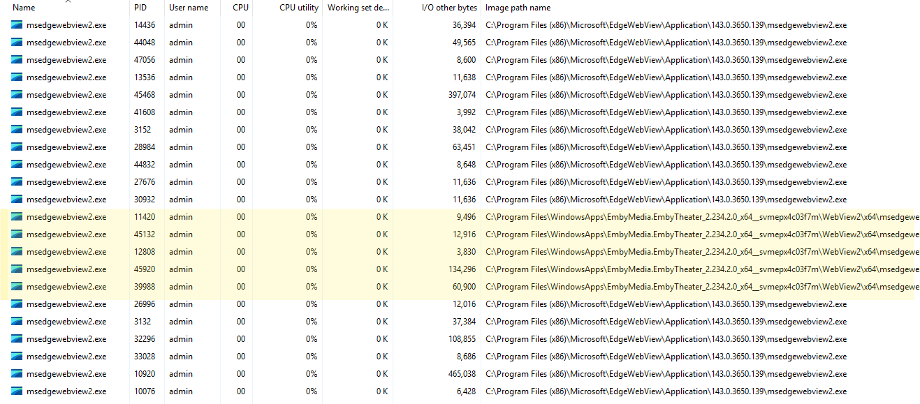

1 hour ago, nurrburt said:
To clear up any confusion, I did read all of the responses and links in this thread, but perhaps I wasn't clear on what I meant by not understanding the technical aspects. What I meant to convey is that I am not a programmer, so while I understand that the delays stem from using webview2 for example, I don't know how much control you have over the process
As it is simply about WebView2 taking time to start up, I assumed that even a non-programmer would figure that a component that isn't ready yet, would neither allow to display any ghosted/pseudo content, so I concluded you haven't read the explanations, while - apparently that was a developer's conclusion only.
I really don't know why it takes those seconds to start up, even though Electron apps - which are also driven by a Chromium-based HTML engine can start much faster.
MS provides two ways for using WebView2: Shared system runtime or shipping one's own runtime. We do the latter (reasons also explained somewhere), but MS' preferred way is for everybody to use the shared runtime -
=> because: this allows faster app startup
=> but: How they are doing this?
The answer is: they are just leaving the browser processes running when the app is closed and they keep them running  forever, even when unused. And the app has no control about this.
When you see the task manager screenshot below, you can see the shared runtime processes (white bg) plus our runtime that we include with the app. When you close the Emby app, all the yellow ones are exiting and nothing remains running.
Considering what MS are doing here - they have no better solution for their own software than keeping the WebView running - is what's makes me estimate the chances that there would exist any good solution for this as rather low.
