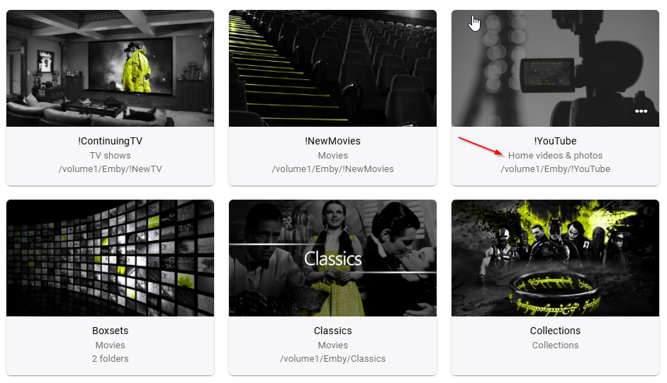

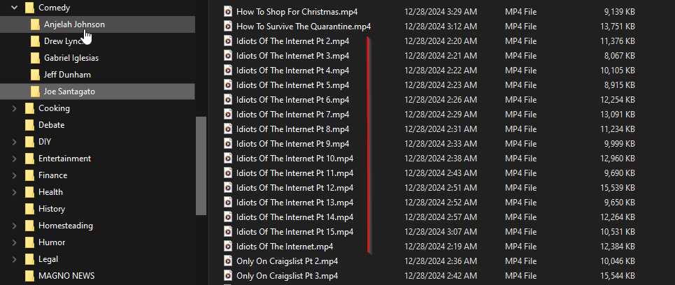

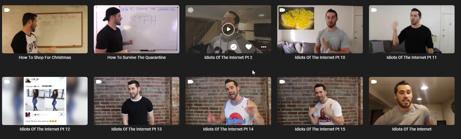

Lenderjack 2 Posted January 1, 2025 Author Posted January 1, 2025 Hi seanbuff, Yes, I am using the standard naming convention in most folders, but this particular library is using "Home videos & photos" as the content type. The reason being, it's basically just YouTube videos and such.. there's nothing to pull down from content fetchers. See screenshots below: This is the library I'm trying to figure out: These are the ones downloaded: These are the only ones visible in Emby:

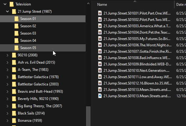

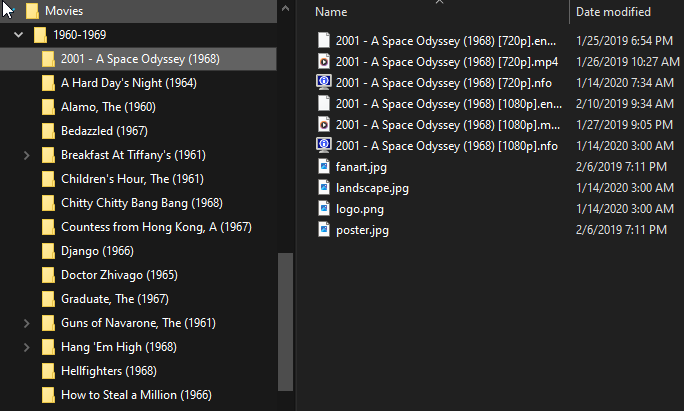

Lenderjack 2 Posted January 1, 2025 Author Posted January 1, 2025 For comparison, this is how my other libraries are organized, and they seem to work fine: Thanks for taking a look!
Solution Carlo 4561 Posted January 3, 2025 Solution Posted January 3, 2025 @Lenderjack Hi, try putting each video in it's own directory like you do for movies. Try two or three of the problem (no show) videos as one video/one directory and scan the library. If that solves the problem, you can do the others. What may be happening is the "missing" files might be a "part" of one currently showing. The names don't specifically follow our mufti-part movie naming but may be close enough that some are doing this while others aren't. If creating a directory for each video doesn't help or fix this issue, please upload your server log file so we can take a look. Carlo PS If these are on Synology, use File Station to check the permissions on any of the missing files and compare to ones showing up. They may have a different owner, or permission setting that could keep them from being discovered by Emby. The log file would help know what's going on.
Lenderjack 2 Posted January 3, 2025 Author Posted January 3, 2025 @Carlo Hey Carlo, thanks for the suggestion! It looks like moving each video into a separate folder is working just fine. I'll see if I can correct the rest of the videos this way. Appreciate the help! 1

Lenderjack 2 Posted January 3, 2025 Author Posted January 3, 2025 I also took the Pt # portion off of the end of each video, and changed it to Vid #... this also works 1
