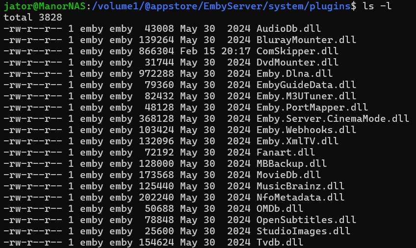

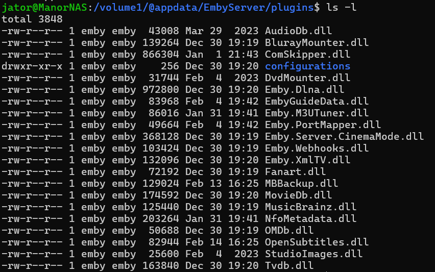

Jator 13 Posted February 16, 2025 Author Posted February 16, 2025 Evening all. So back to trying to wrestle this comskip issue to the ground. Basically back to the original problems I had, I can run comskip manually but it won't trigger, and my ComSkipper won't show up in my plugins section. For this post, I'm going to focus on ComSkipper. I have the .dll placed in the same directories as MovieDd.dll is with the same owner/group privileges: Not sure where else it would need to go, I did a search for MovieDb.dll to make sure I was putting the ComSkipper.dll plugin in the correct director(y/ies)? I restart the server (I have to stop at the Package Center level as I can't find a "restart" in the setting area, i'm waiting for the 'doh' moment when someone points me to what is likely right in front of me) and there's still no option to configure ComSkipper in the plugin section: Any obvious things I am missing that anyone can point me in the right direction?

Luke 42240 Posted February 17, 2025 Posted February 17, 2025 You're running version 4.8.8 of the server, but the plugin is compiled for 4.8.10. You need to either update server, or get a version of the plugin that is compiled against an older emby nuget package (the developer of the plugin will know what that means).

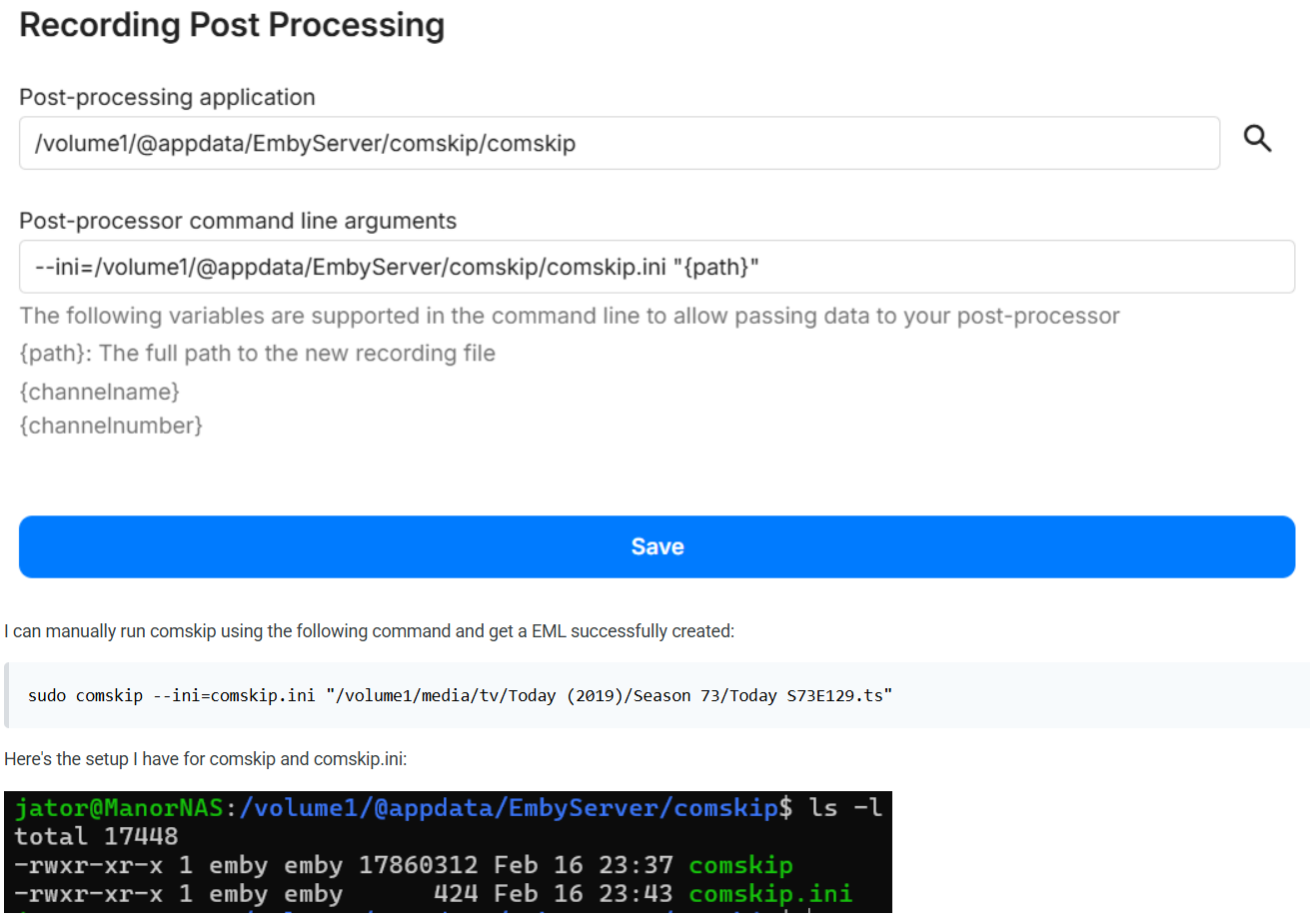

Jator 13 Posted February 17, 2025 Author Posted February 17, 2025 So switching my request for help to now getting Comskip to actually work through post processing script. Here's my settings in Emby Server: I can manually run comskip using the following command and get a EML successfully created: sudo comskip --ini=comskip.ini "/volume1/media/tv/Today (2019)/Season 73/Today S73E129.ts" Here's the setup I have for comskip and comskip.ini: And here's the error I got when I recorded the above TV show: 2025-02-17 08:59:59.999 Info VideoEncoder: ProcessRun 'Encoding c08600': Stopping ffmpeg process with q command for /volume1/media/tv/Today (2019)/Season 73/Today S73E129.ts 2025-02-17 09:00:01.784 Info VideoEncoder: AppendExtraLogData - Read graph file: /var/packages/EmbyServer/var/logs/recording-conversion-c0860041-6cac-4563-b986-e2796ef1b559_1graph.txt 2025-02-17 09:00:01.784 Info VideoEncoder: AppendExtraLogData - Deserialized GraphData fileStream: 27.000 bytes Graph Count: 0 2025-02-17 09:00:01.784 Info VideoEncoder: AppendExtraLogData - File Deleted 2025-02-17 09:00:02.131 Info VideoEncoder: ProcessRun 'Encoding c08600' Process exited with code 0 - Succeeded 2025-02-17 09:00:02.132 Debug VideoEncoder: VideoEncoder.OnFfMpegProcessExited: Disposing stream resources 2025-02-17 09:00:02.132 Info LiveTV: Recording stopped: /volume1/media/tv/Today (2019)/Season 73/Today S73E129.ts 2025-02-17 09:00:02.132 Info MediaSourceManager: Live stream 7a8768321aea3ae5d59a3d956aafd633 consumer count is now 0 2025-02-17 09:00:02.132 Info MediaSourceManager: Closing live stream 06044cf0e6f93cdae5f285c9ecfaaeb4_01413a525b3a9622ce6fdf19f7dde354_7a8768321aea3ae5d59a3d956aafd633 2025-02-17 09:00:02.150 Info SharedHttpPipelineSource: Closing SharedHttpPipelineSource 2025-02-17 09:00:02.150 Info SharedHttpPipelineSource: Deleting temp files 2025-02-17 09:00:02.150 Info MediaSourceManager: Live stream 06044cf0e6f93cdae5f285c9ecfaaeb4_01413a525b3a9622ce6fdf19f7dde354_7a8768321aea3ae5d59a3d956aafd633 closed successfully 2025-02-17 09:00:02.586 Info LiveTV: Running recording post processor /volume1/@appdata/EmbyServer/comskip/comskip --ini=/volume1/@appdata/EmbyServer/comskip/comskip.ini "/volume1/media/tv/Today (2019)/Season 73/Today S73E129.ts" 2025-02-17 09:00:02.586 Info LiveTV: ProcessRun 'Recording 768824' Execute: /volume1/@appdata/EmbyServer/comskip/comskip --ini=/volume1/@appdata/EmbyServer/comskip/comskip.ini "/volume1/media/tv/Today (2019)/Season 73/Today S73E129.ts" 2025-02-17 09:00:02.687 Error LiveTV: ProcessRun 'Recording 768824' Process error: *** Error Report *** Version: 4.8.8.0 Command line: /volume1/@appstore/EmbyServer/system/EmbyServer.dll -programdata /var/packages/EmbyServer/var -ffdetect /var/packages/EmbyServer/target/bin/ffdetect -ffmpeg /var/packages/EmbyServer/target/bin/ffmpeg -ffprobe /var/packages/EmbyServer/target/bin/ffprobe -nolocalportconfig -ignore_vaapi_enabled_flag -pidfile /var/packages/EmbyServer/var/EmbyServer.pid -defaultdirectory /volume1/Public -updatepackage emby-server-synology72_{version}_x86_64.spk -noautorunwebapp Operating system: Linux version 4.4.302+ (root@build5) (gcc version 12.2.0 (GCC) ) #72806 SMP Thu Sep 5 13:44:44 CST 2024 Framework: .NET 6.0.25 OS/Process: x64/x64 Runtime: volume1/@appstore/EmbyServer/system/System.Private.CoreLib.dll Processor count: 4 Data path: /var/packages/EmbyServer/var Application path: /volume1/@appstore/EmbyServer/system System.ComponentModel.Win32Exception: System.ComponentModel.Win32Exception (2): An error occurred trying to start process '/volume1/@appdata/EmbyServer/comskip/comskip ' with working directory '/volume1/@appstore/EmbyServer'. No such file or directory at System.Diagnostics.Process.ForkAndExecProcess(ProcessStartInfo startInfo, String resolvedFilename, String[] argv, String[] envp, String cwd, Boolean setCredentials, UInt32 userId, UInt32 groupId, UInt32[] groups, Int32& stdinFd, Int32& stdoutFd, Int32& stderrFd, Boolean usesTerminal, Boolean throwOnNoExec) at System.Diagnostics.Process.StartCore(ProcessStartInfo startInfo) at System.Diagnostics.Process.Start() at Emby.ProcessRun.CoreProcess.CoreProcessLocal.Run(StartParams startParams) at Emby.ProcessRun.Runners.ProcessRunnerBase.Run(StartParams startParams) Source: System.Diagnostics.Process TargetSite: Boolean ForkAndExecProcess(System.Diagnostics.ProcessStartInfo, System.String, System.String[], System.String[], System.String, Boolean, UInt32, UInt32, UInt32[], Int32 ByRef, Int32 ByRef, Int32 ByRef, Boolean, Boolean) 2025-02-17 09:00:02.687 Error LiveTV: Error running recording post processor *** Error Report *** Version: 4.8.8.0 Command line: /volume1/@appstore/EmbyServer/system/EmbyServer.dll -programdata /var/packages/EmbyServer/var -ffdetect /var/packages/EmbyServer/target/bin/ffdetect -ffmpeg /var/packages/EmbyServer/target/bin/ffmpeg -ffprobe /var/packages/EmbyServer/target/bin/ffprobe -nolocalportconfig -ignore_vaapi_enabled_flag -pidfile /var/packages/EmbyServer/var/EmbyServer.pid -defaultdirectory /volume1/Public -updatepackage emby-server-synology72_{version}_x86_64.spk -noautorunwebapp Operating system: Linux version 4.4.302+ (root@build5) (gcc version 12.2.0 (GCC) ) #72806 SMP Thu Sep 5 13:44:44 CST 2024 Framework: .NET 6.0.25 OS/Process: x64/x64 Runtime: volume1/@appstore/EmbyServer/system/System.Private.CoreLib.dll Processor count: 4 Data path: /var/packages/EmbyServer/var Application path: /volume1/@appstore/EmbyServer/system System.ComponentModel.Win32Exception: System.ComponentModel.Win32Exception (2): An error occurred trying to start process '/volume1/@appdata/EmbyServer/comskip/comskip ' with working directory '/volume1/@appstore/EmbyServer'. No such file or directory at System.Diagnostics.Process.ForkAndExecProcess(ProcessStartInfo startInfo, String resolvedFilename, String[] argv, String[] envp, String cwd, Boolean setCredentials, UInt32 userId, UInt32 groupId, UInt32[] groups, Int32& stdinFd, Int32& stdoutFd, Int32& stderrFd, Boolean usesTerminal, Boolean throwOnNoExec) at System.Diagnostics.Process.StartCore(ProcessStartInfo startInfo) at System.Diagnostics.Process.Start() at Emby.ProcessRun.CoreProcess.CoreProcessLocal.Run(StartParams startParams) at Emby.ProcessRun.Runners.ProcessRunnerBase.Run(StartParams startParams) at Emby.LiveTV.EmbyTV.PostProcessRecording(ActiveRecordingInfo recordingInfo) Source: System.Diagnostics.Process TargetSite: Boolean ForkAndExecProcess(System.Diagnostics.ProcessStartInfo, System.String, System.String[], System.String[], System.String, Boolean, UInt32, UInt32, UInt32[], Int32 ByRef, Int32 ByRef, Int32 ByRef, Boolean, Boolean) 2025-02-17 09:00:02.687 Info LiveTV: Triggering refresh on /volume1/media/tv/Today (2019)/Season 73/Today S73E129.ts 2025-02-17 09:00:02.688 Info LiveTV: Refreshing recording parent /volume1/media/tv/Today (2019) 2025-02-17 09:00:02.804 Debug VideoEncoder: ProcessRun 'Encoding c08600': WaitForExitAsync took 640ms 2025-02-17 09:00:02.828 Debug App: Refreshing /volume1/media/tv/Today (2019)/Season 73/Today S73E129.ts due to date modified change 1739797166 - 1739800801. 2025-02-17 09:00:02.828 Debug App: FFProbeProvider reports change to 768824 - /volume1/media/tv/Today (2019)/Season 73/Today S73E129.ts 2025-02-17 09:00:02.843 Debug App: Running FFProbeProvider for /volume1/media/tv/Today (2019)/Season 73/Today S73E129.ts 2025-02-17 09:00:02.843 Info MediaProbeManager: ProcessRun 'ffprobe' Execute: /var/packages/EmbyServer/target/bin/ffprobe -i file:"/volume1/media/tv/Today (2019)/Season 73/Today S73E129.ts" -threads 0 -v info -print_format json -show_streams -show_chapters -show_format -show_data 2025-02-17 09:00:02.946 Debug MediaProbeManager: ProcessRun 'ffprobe' Started. 2025-02-17 09:00:03.983 Info MediaProbeManager: ProcessRun 'ffprobe' Process exited with code 0 - Succeeded 2025-02-17 09:00:04.036 Debug App: Running EpisodeNfoProvider for /volume1/media/tv/Today (2019)/Season 73/Today S73E129.ts 2025-02-17 09:00:04.037 Debug App: Running TvdbEpisodeProvider for /volume1/media/tv/Today (2019)/Season 73/Today S73E129.ts 2025-02-17 09:00:04.038 Debug App: TvdbEpisodeProvider returned no metadata for /volume1/media/tv/Today (2019)/Season 73/Today S73E129.ts 2025-02-17 09:00:04.038 Debug App: Running MovieDbEpisodeProvider for /volume1/media/tv/Today (2019)/Season 73/Today S73E129.ts 2025-02-17 09:00:04.038 Info HttpClient: GET https://api.themoviedb.org/3/tv/137691/season/73/episode/129?api_key=x_secret2_x&append_to_response=images,external_ids,credits,videos&language=en-US&include_image_language=en-US,null 2025-02-17 09:00:04.355 Debug App: MovieDbEpisodeProvider returned no metadata for /volume1/media/tv/Today (2019)/Season 73/Today S73E129.ts 2025-02-17 09:00:04.355 Debug App: Running OmdbItemProvider for /volume1/media/tv/Today (2019)/Season 73/Today S73E129.ts 2025-02-17 09:00:04.355 Debug App: OmdbItemProvider returned no metadata for /volume1/media/tv/Today (2019)/Season 73/Today S73E129.ts 2025-02-17 09:00:04.355 Debug App: Running TvdbEpisodeImageProvider for /volume1/media/tv/Today (2019)/Season 73/Today S73E129.ts 2025-02-17 09:00:04.355 Debug App: Running MovieDbEpisodeImageProvider for /volume1/media/tv/Today (2019)/Season 73/Today S73E129.ts 2025-02-17 09:00:04.355 Info HttpClient: GET https://api.themoviedb.org/3/tv/137691/season/73/episode/129?api_key=x_secret2_x&append_to_response=images,external_ids,credits,videos 2025-02-17 09:00:04.392 Debug App: Running OmdbImageProvider for /volume1/media/tv/Today (2019)/Season 73/Today S73E129.ts 2025-02-17 09:00:04.392 Debug App: Running VideoImageProvider for /volume1/media/tv/Today (2019)/Season 73/Today S73E129.ts 2025-02-17 09:00:04.518 Info QuickSingleImageExtractor: ProcessRun 'quick-extract-image' Execute: /var/packages/EmbyServer/target/bin/ffmpeg -skip_list 719 -f mpegts -threads 1 -i file:"/volume1/media/tv/Today (2019)/Season 73/Today S73E129.ts" -an -sn -update 1 -vf "thumbnail=24" -vsync 0 -f image2 "/var/packages/EmbyServer/var/cache/temp/469134eb-e51b-45e9-a501-d74842a1e63c.jpg" 2025-02-17 09:00:04.519 Debug QuickSingleImageExtractor: ProcessRun 'quick-extract-image' Started. 2025-02-17 09:01:04.572 Error QuickSingleImageExtractor: QuickSingleImageExtractor.RunExtraction [A28D8B02330C]: Error running quick-extract-image -skip_list 719 -f mpegts -threads 1 -i file:"/volume1/media/tv/Today (2019)/Season 73/Today S73E129.ts" -an -sn -update 1 -vf "thumbnail=24" -vsync 0 -f image2 "/var/packages/EmbyServer/var/cache/temp/469134eb-e51b-45e9-a501-d74842a1e63c.jpg" *** Error Report *** Version: 4.8.8.0 Command line: /volume1/@appstore/EmbyServer/system/EmbyServer.dll -programdata /var/packages/EmbyServer/var -ffdetect /var/packages/EmbyServer/target/bin/ffdetect -ffmpeg /var/packages/EmbyServer/target/bin/ffmpeg -ffprobe /var/packages/EmbyServer/target/bin/ffprobe -nolocalportconfig -ignore_vaapi_enabled_flag -pidfile /var/packages/EmbyServer/var/EmbyServer.pid -defaultdirectory /volume1/Public -updatepackage emby-server-synology72_{version}_x86_64.spk -noautorunwebapp Operating system: Linux version 4.4.302+ (root@build5) (gcc version 12.2.0 (GCC) ) #72806 SMP Thu Sep 5 13:44:44 CST 2024 Framework: .NET 6.0.25 OS/Process: x64/x64 Runtime: volume1/@appstore/EmbyServer/system/System.Private.CoreLib.dll Processor count: 4 Data path: /var/packages/EmbyServer/var Application path: /volume1/@appstore/EmbyServer/system System.Exception: System.Exception: Error running ffmpeg quick-extract-image for file:"/volume1/media/tv/Today (2019)/Season 73/Today S73E129.ts" - Command: -skip_list 719 -f mpegts -threads 1 -i file:"/volume1/media/tv/Today (2019)/Season 73/Today S73E129.ts" -an -sn -update 1 -vf "thumbnail=24" -vsync 0 -f image2 "/var/packages/EmbyServer/var/cache/temp/469134eb-e51b-45e9-a501-d74842a1e63c.jpg" at Emby.Server.MediaEncoding.ImageExtraction.ImageExtractorBase.RunExtraction(String inputPath, Nullable`1 container, MediaStream videoStream, Nullable`1 protocol, Nullable`1 streamIndex, Nullable`1 threedFormat, Nullable`1 startOffset, Nullable`1 interval, String targetDirectory, String targetFilename, Nullable`1 maxWidth, Boolean enableThumbnailFilter, CancellationToken cancellationToken) Source: Emby.Server.MediaEncoding TargetSite: Void MoveNext() 2025-02-17 09:01:04.572 Error QuickSingleImageExtractor: ProcessRun 'quick-extract-image' Error Output: ffmpeg version 5.1-emby_2023_06_25 Copyright (c) 2000-2022 the FFmpeg developers and softworkz for Emby LLC built with gcc 10.3.0 (crosstool-NG 1.25.0) Execution Date: 2025-02-17 09:00:04 -vsync is deprecated. Use -fps_mode Passing a number to -vsync is deprecated, use a string argument as described in the manual. Input #0, mpegts, from 'file:/volume1/media/tv/Today (2019)/Season 73/Today S73E129.ts': Duration: 01:59:55.20, start: 1.400000, bitrate: 5876 kb/s Program 1 Metadata: service_name : Service01 service_provider: FFmpeg Stream #0:0[0x100]: Video: h264 (High) ([27][0][0][0] / 0x001B), yuv420p(tv, bt709, progressive), 1280x720 [SAR 1:1 DAR 16:9], Closed Captions, Level 32, 59.94 fps, 59.94 tbr, 90k tbn, Start-Time 1.400s Stream #0:1[0x101]: Audio: aac (LC) ([15][0][0][0] / 0x000F), 48000 Hz, stereo, fltp, 191 kb/s, Start-Time 1.403s Stream mapping: Stream #0:0 -> #0:0 (h264 (native) -> mjpeg (native)) Press [q] to stop, [?] for help [swscaler @ 0xea80c0] [swscaler @ 0xe0e780] deprecated pixel format used, make sure you did set range correctly [swscaler @ 0xea80c0] [swscaler @ 0xdb1ec0] deprecated pixel format used, make sure you did set range correctly [swscaler @ 0xea80c0] [swscaler @ 0xca76c0] deprecated pixel format used, make sure you did set range correctly [swscaler @ 0xea80c0] [swscaler @ 0xc3ea00] deprecated pixel format used, make sure you did set range correctly [swscaler @ 0xea80c0] [swscaler @ 0xe83d80] deprecated pixel format used, make sure you did set range correctly [Parsed_thumbnail_0 @ 0xd94380] frame id #13 (pts_time=0.216889) selected from a set of 24 images [swscaler @ 0xea80c0] [swscaler @ 0xdb1ec0] deprecated pixel format used, make sure you did set range correctly [swscaler @ 0xea80c0] [swscaler @ 0xe0e780] deprecated pixel format used, make sure you did set range correctly [swscaler @ 0xea80c0] [swscaler @ 0xd02e40] deprecated pixel format used, make sure you did set range correctly [swscaler @ 0xea80c0] 2025-02-17 09:01:04.573 Error ImageExtraction: Thumbnail-Filter extraction failed, will attempt standard way. Input: file:"/volume1/media/tv/Today (2019)/Season 73/Today S73E129.ts" 2025-02-17 09:01:04.579 Info QuickSingleImageExtractor: ProcessRun 'quick-extract-image' Execute: /var/packages/EmbyServer/target/bin/ffmpeg -skip_list 719 -f mpegts -threads 1 -i file:"/volume1/media/tv/Today (2019)/Season 73/Today S73E129.ts" -an -sn -update 1 -vsync 0 -f image2 "/var/packages/EmbyServer/var/cache/temp/d755cefc-5dca-41aa-80d9-c40c9f473333.jpg" 2025-02-17 09:01:04.586 Debug QuickSingleImageExtractor: ProcessRun 'quick-extract-image' Started. 2025-02-17 09:02:04.587 Error QuickSingleImageExtractor: QuickSingleImageExtractor.RunExtraction [626890A893C0]: Error running quick-extract-image -skip_list 719 -f mpegts -threads 1 -i file:"/volume1/media/tv/Today (2019)/Season 73/Today S73E129.ts" -an -sn -update 1 -vsync 0 -f image2 "/var/packages/EmbyServer/var/cache/temp/d755cefc-5dca-41aa-80d9-c40c9f473333.jpg" *** Error Report *** Version: 4.8.8.0 Command line: /volume1/@appstore/EmbyServer/system/EmbyServer.dll -programdata /var/packages/EmbyServer/var -ffdetect /var/packages/EmbyServer/target/bin/ffdetect -ffmpeg /var/packages/EmbyServer/target/bin/ffmpeg -ffprobe /var/packages/EmbyServer/target/bin/ffprobe -nolocalportconfig -ignore_vaapi_enabled_flag -pidfile /var/packages/EmbyServer/var/EmbyServer.pid -defaultdirectory /volume1/Public -updatepackage emby-server-synology72_{version}_x86_64.spk -noautorunwebapp Operating system: Linux version 4.4.302+ (root@build5) (gcc version 12.2.0 (GCC) ) #72806 SMP Thu Sep 5 13:44:44 CST 2024 Framework: .NET 6.0.25 OS/Process: x64/x64 Runtime: volume1/@appstore/EmbyServer/system/System.Private.CoreLib.dll Processor count: 4 Data path: /var/packages/EmbyServer/var Application path: /volume1/@appstore/EmbyServer/system System.Exception: System.Exception: Error running ffmpeg quick-extract-image for file:"/volume1/media/tv/Today (2019)/Season 73/Today S73E129.ts" - Command: -skip_list 719 -f mpegts -threads 1 -i file:"/volume1/media/tv/Today (2019)/Season 73/Today S73E129.ts" -an -sn -update 1 -vsync 0 -f image2 "/var/packages/EmbyServer/var/cache/temp/d755cefc-5dca-41aa-80d9-c40c9f473333.jpg" at Emby.Server.MediaEncoding.ImageExtraction.ImageExtractorBase.RunExtraction(String inputPath, Nullable`1 container, MediaStream videoStream, Nullable`1 protocol, Nullable`1 streamIndex, Nullable`1 threedFormat, Nullable`1 startOffset, Nullable`1 interval, String targetDirectory, String targetFilename, Nullable`1 maxWidth, Boolean enableThumbnailFilter, CancellationToken cancellationToken) Source: Emby.Server.MediaEncoding TargetSite: Void MoveNext() 2025-02-17 09:02:04.587 Error QuickSingleImageExtractor: ProcessRun 'quick-extract-image' Error Output: ffmpeg version 5.1-emby_2023_06_25 Copyright (c) 2000-2022 the FFmpeg developers and softworkz for Emby LLC built with gcc 10.3.0 (crosstool-NG 1.25.0) Execution Date: 2025-02-17 09:01:04 -vsync is deprecated. Use -fps_mode Passing a number to -vsync is deprecated, use a string argument as described in the manual. Input #0, mpegts, from 'file:/volume1/media/tv/Today (2019)/Season 73/Today S73E129.ts': Duration: 01:59:55.20, start: 1.400000, bitrate: 5876 kb/s Program 1 Metadata: service_name : Service01 service_provider: FFmpeg Stream #0:0[0x100]: Video: h264 (High) ([27][0][0][0] / 0x001B), yuv420p(tv, bt709, progressive), 1280x720 [SAR 1:1 DAR 16:9], Closed Captions, Level 32, 59.94 fps, 59.94 tbr, 90k tbn, Start-Time 1.400s Stream #0:1[0x101]: Audio: aac (LC) ([15][0][0][0] / 0x000F), 48000 Hz, stereo, fltp, 191 kb/s, Start-Time 1.403s Stream mapping: Stream #0:0 -> #0:0 (h264 (native) -> mjpeg (native)) Press [q] to stop, [?] for help [swscaler @ 0x21f3a40] [swscaler @ 0x2159f40] deprecated pixel format used, make sure you did set range correctly [swscaler @ 0x21f3a40] [swscaler @ 0x202a440] deprecated pixel format used, make sure you did set range correctly [swscaler @ 0x21f3a40] [swscaler @ 0x1f89e80] deprecated pixel format used, make sure you did set range correctly [swscaler @ 0x21f3a40] [swscaler @ 0x2121680] deprecated pixel format used, make sure you did set range correctly [swscaler @ 0x21f3a40] [swscaler @ 0x20e1b00] deprecated pixel format used, make sure you did set range correctly [swscaler @ 0x21f3a40] [swscaler @ 0x202a440] deprecated pixel format used, make sure you did set range correctly [swscaler @ 0x21f3a40] [swscaler @ 0x2159f40] deprecated pixel format used, make sure you did set range correctly [swscaler @ 0x21f3a40] [swscaler @ 0x204e8c0] deprecated pixel format used, make sure you did set range correctly [swscaler @ 0x21f3a40] [swscaler @ 0x1f2c040] deprecated pixel format used, make sure you did set range 2025-02-17 09:02:04.593 Error App: Error in Image Capture *** Error Report *** Version: 4.8.8.0 Command line: /volume1/@appstore/EmbyServer/system/EmbyServer.dll -programdata /var/packages/EmbyServer/var -ffdetect /var/packages/EmbyServer/target/bin/ffdetect -ffmpeg /var/packages/EmbyServer/target/bin/ffmpeg -ffprobe /var/packages/EmbyServer/target/bin/ffprobe -nolocalportconfig -ignore_vaapi_enabled_flag -pidfile /var/packages/EmbyServer/var/EmbyServer.pid -defaultdirectory /volume1/Public -updatepackage emby-server-synology72_{version}_x86_64.spk -noautorunwebapp Operating system: Linux version 4.4.302+ (root@build5) (gcc version 12.2.0 (GCC) ) #72806 SMP Thu Sep 5 13:44:44 CST 2024 Framework: .NET 6.0.25 OS/Process: x64/x64 Runtime: volume1/@appstore/EmbyServer/system/System.Private.CoreLib.dll Processor count: 4 Data path: /var/packages/EmbyServer/var Application path: /volume1/@appstore/EmbyServer/system System.Exception: System.Exception: Error running ffmpeg quick-extract-image for file:"/volume1/media/tv/Today (2019)/Season 73/Today S73E129.ts" - Command: -skip_list 719 -f mpegts -threads 1 -i file:"/volume1/media/tv/Today (2019)/Season 73/Today S73E129.ts" -an -sn -update 1 -vsync 0 -f image2 "/var/packages/EmbyServer/var/cache/temp/d755cefc-5dca-41aa-80d9-c40c9f473333.jpg" at Emby.Server.MediaEncoding.ImageExtraction.ImageExtractorBase.RunExtraction(String inputPath, Nullable`1 container, MediaStream videoStream, Nullable`1 protocol, Nullable`1 streamIndex, Nullable`1 threedFormat, Nullable`1 startOffset, Nullable`1 interval, String targetDirectory, String targetFilename, Nullable`1 maxWidth, Boolean enableThumbnailFilter, CancellationToken cancellationToken) at Emby.Server.MediaEncoding.ImageExtraction.ImageExtractionManager.ExtractImageInternal(ReadOnlyMemory`1 inputPath, Nullable`1 container, MediaStream videoStream, Nullable`1 streamIndex, Nullable`1 threedFormat, Nullable`1 offset, Boolean useThumbNailFilter, CancellationToken cancellationToken) at Emby.Server.MediaEncoding.ImageExtraction.ImageExtractionManager.ExtractImage(ReadOnlyMemory`1 inputPath, Nullable`1 container, MediaStream videoStream, Nullable`1 streamIndex, MediaProtocol protocol, Boolean isAudio, Nullable`1 threedFormat, Nullable`1 offset, CancellationToken cancellationToken) at Emby.Providers.MediaInfo.VideoImageProvider.GetImage(BaseMetadataResult itemResult, ImageType type, CancellationToken cancellationToken) at Emby.Providers.Manager.ItemImageProvider.RefreshFromProvider(BaseMetadataResult itemResult, IDynamicImageProvider provider, Boolean providerReportsChanges, ImageRefreshOptions refreshOptions, Boolean replaceAllImages, TypeOptions savedOptions, LibraryOptions libraryOptions, List`1 downloadedImages, RefreshResult result, CancellationToken cancellationToken) Source: Emby.Server.MediaEncoding TargetSite: Void MoveNext() Any guidance on how to resolve this last outstanding issue before I try and use this as my default DVR for the next week or so?
Luke 42240 Posted February 20, 2025 Posted February 20, 2025 Quote System.ComponentModel.Win32Exception: System.ComponentModel.Win32Exception (2): An error occurred trying to start process '/volume1/@appdata/EmbyServer/comskip/comskip ' with working directory '/volume1/@appstore/EmbyServer'. No such file or directory The server is unable to start the executable you configured. That means either the file doesn't exist, or the server is being denied access to it, or being denied access to execute it. Assuming the file is there, isn't likely an issue of permissions, so just get that resolved and then you should be good.

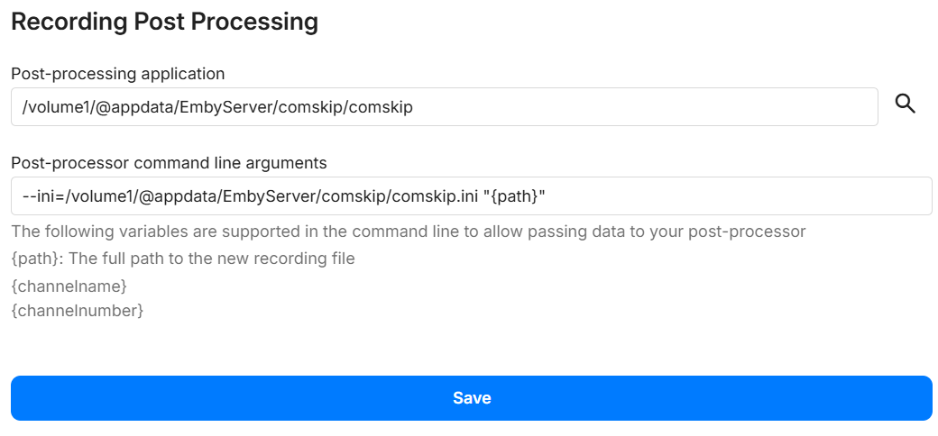

Jator 13 Posted February 20, 2025 Author Posted February 20, 2025 6 hours ago, Luke said: The server is unable to start the executable you configured. That means either the file doesn't exist, or the server is being denied access to it, or being denied access to execute it. Assuming the file is there, isn't likely an issue of permissions, so just get that resolved and then you should be good. Thanks @Lukefor responding. Not sure if you saw in my post before "Bueller" but I posted screen shots of the files and their permissions set as well as the path in the configuration section of Emby. I did CHOWN to emby:emby and permissions are consistent with other Emby files as that was an issue I was having last time I tried to wrestle this to the ground. On paper, as far as I can tell, everything should be working. Reposting the screenshot as my last post was rather lengthy given the error log I shared:

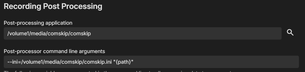

Jator 13 Posted February 21, 2025 Author Posted February 21, 2025 So finally found a workaround. I created a subfolder (/volume1/media/comskip) and placed both comskip and comskip.ini in there. The /volume1/media/ houses 3 other subfolders, /tv, /movies, /imports. I set the tv and movie subfolders as my default recording locations. I setup this folder as a "shared folder" and gave both emby and sc-comskip system user roles access to read and write. I then modified Emby post processing to the following: Now things are processing appropriately. Clearly I had a permission issue, I'm guessing it's the folder permissions within the /volume1/@appdata structure, but since I couldn't modify permission in shared folders, I wasn't going to try and tackle that via CLI, I'm not anywhere near knowledgeable to try and tackle that nor do I want to break anything inadvertently. Thanks again for the suggestions, it ultimately led me to finding a workable solution. 1
