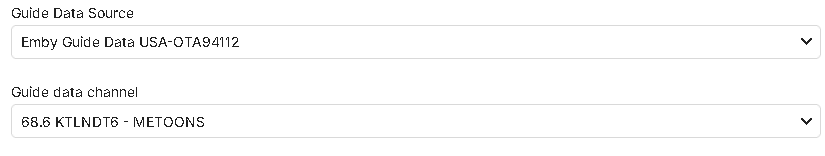

Carlo 4561 Posted January 3, 2025 Posted January 3, 2025 12 hours ago, jboydude said: 43.5 is definitely the MeTV toon channel. 43.6 Is regular MeTV. @Carlo Sorry about that. Add the OTA guide for 94112. Don't enable it for any tuner. We don't want this guide to try and match channels based on channel number. Manually choose the USA-OTA94112 guide for ME Toons channel. Pick channel 68.6 as shown above You should be good now. Carlo
jboydude 14 Posted January 3, 2025 Author Posted January 3, 2025 (edited) I did the first step: Add the OTA guide for 94112. Don't enable it for any tuner. We don't want this guide to try and match channels based on channel number. But I cannot get to the option to select just 1 channel. Never mind. I found it. Edited January 3, 2025 by jboydude 1
