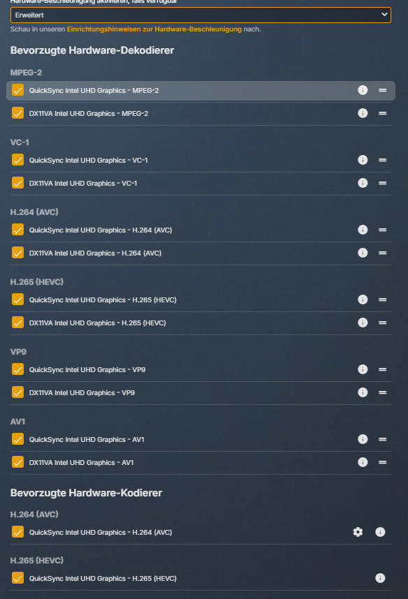

sh0rty 727 Posted December 31, 2024 Posted December 31, 2024 (edited) Migrated my Emby Server to a small N97 box with attached DAS enclosure. Everything including HW-transcoding is working flawlessly except for content that requires (hardware) tonemapping. In this case the GPU is uitilized 0% and the full load is on the GPU. In theory the N97 (Specs) should be capable of tonemapping. Any suggestions what I could do to get it working @Luke@softworkz? I'm running latest Emby Stable Server 4.8.10.0 on an uptodate Windows 11 Pro. Windows Driver for UHD Graphics is 32.0.101.6129 (18.10.2024). Tried latest Beta server with same results. Out of ideas, I tried Jellyfin and the whole transcoding chain is working (GPU around 90% and lower CPU consumption with ca. 140fps compared to Emby with 100% CPU and 0% GPU with 35-45 fps). Attached are the logs and the settings. Thanks for any suggestions! embyserver.txt hardware_detection-63871253410.txt ffmpeg-transcode-b92b6a89-02fc-40cb-abc1-f9b4f54e865f_1.txt Edited December 31, 2024 by shorty1483
