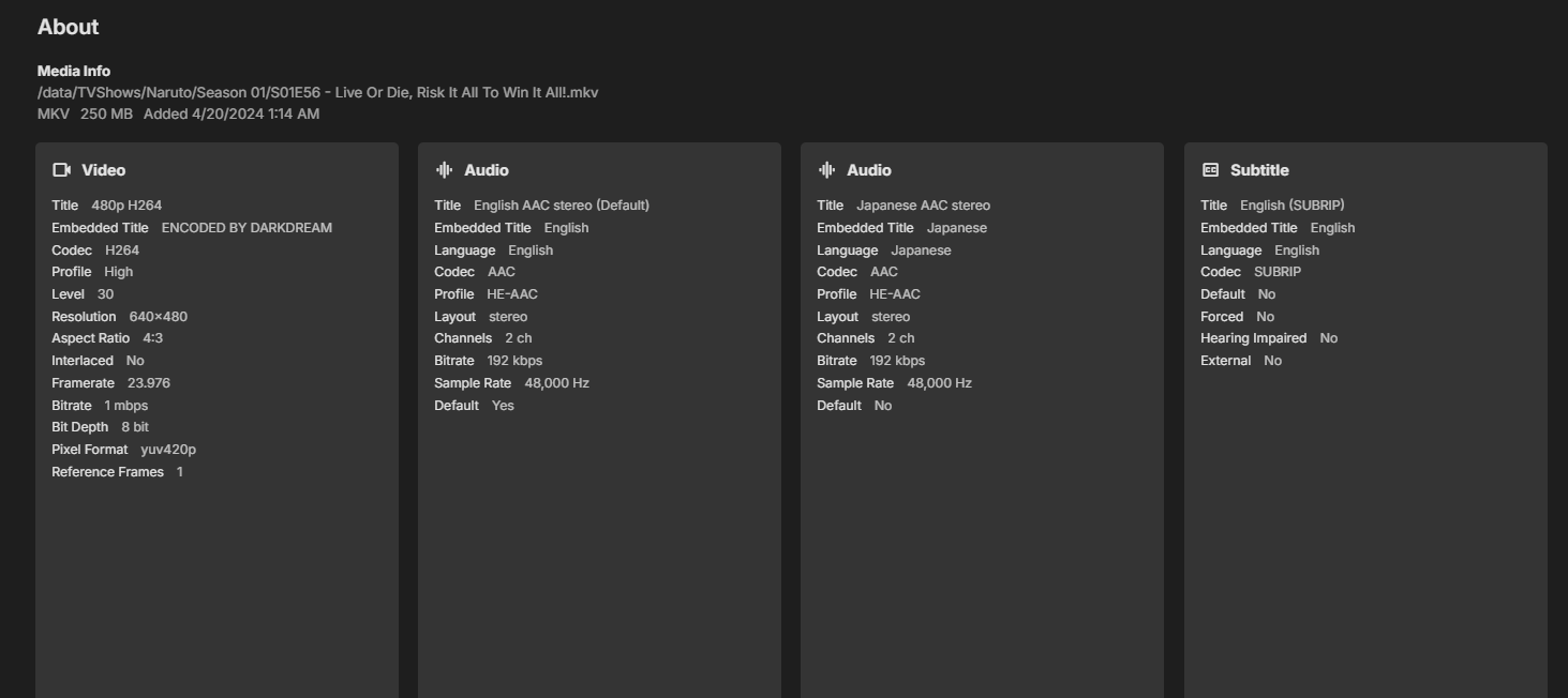

AP123 13 Posted December 30, 2024 Posted December 30, 2024 Hello. I've googled and seen this topic for quite some time now but haven't seen a solution. I have some episodes of anime that I can FF just fine, and others that won't FF at all. Any time I try to FF it just resumes playing from where it was. Logs attached. Samsung 65" UN65RU8000FXZA running latest emby. embyserver.txt

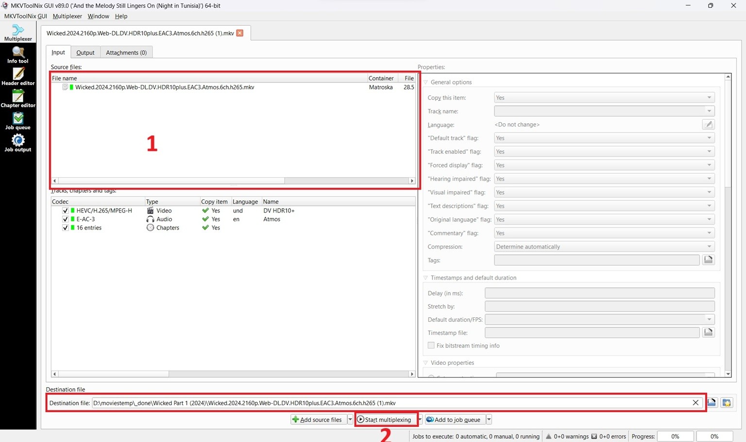

SamES 1084 Posted December 31, 2024 Posted December 31, 2024 That generally means there is something not quite right in the mkv header. Try this: open the file in MkvToolnix and copy all the streams to a new file. Add the new file to Emby and test it
AP123 13 Posted December 31, 2024 Author Posted December 31, 2024 7 hours ago, SamES said: That generally means there is something not quite right in the mkv header. Try this: open the file in MkvToolnix and copy all the streams to a new file. Add the new file to Emby and test it Thanks for the response. I don't know how to use that program or what exactly you mean by fixing the mkv header, so if you could provide more info that would be great. I've already installed mkvtoolnix but never used it
FrostByte 5453 Posted December 31, 2024 Posted December 31, 2024 (edited) 1 hour ago, AP123 said: Thanks for the response. I don't know how to use that program or what exactly you mean by fixing the mkv header, so if you could provide more info that would be great. I've already installed mkvtoolnix but never used it SamES is asking you if you can remux the file as he suspects the header information of the container in your original file may be corrupt. Remuxing just takes the original content video, audio, etc tracks and puts them into a new mkv container without changing the original contents inside the container. Drag-n-drop tour original file into the Source files box Click the Start multiplexing button Should run fairly quick. Then retest using the new destination file. Edited December 31, 2024 by FrostByte 2
