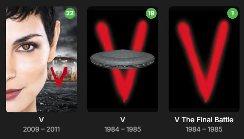

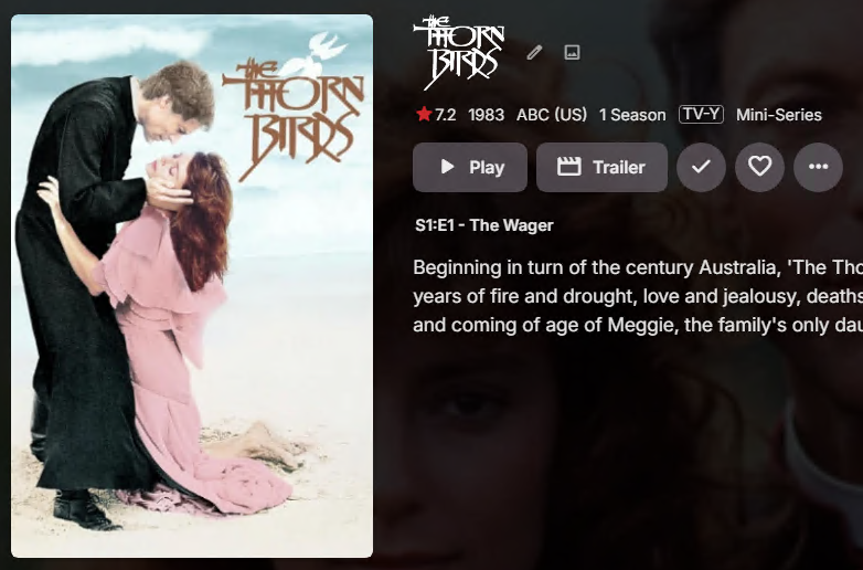

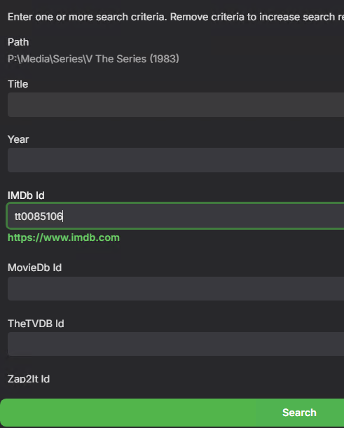

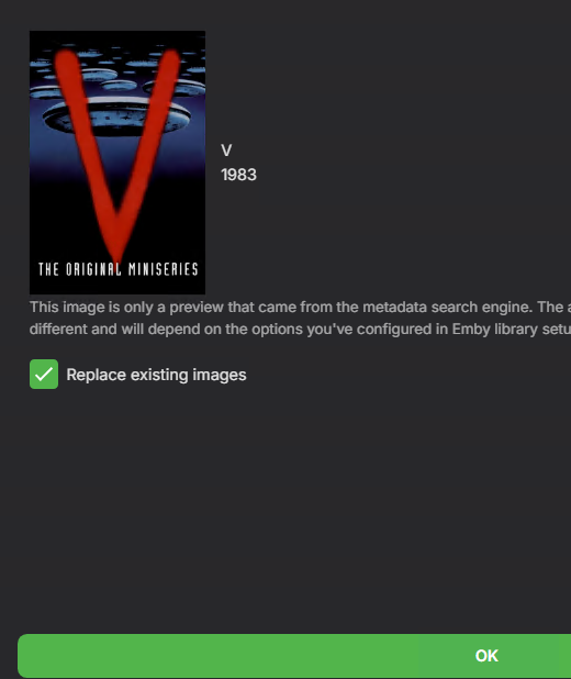

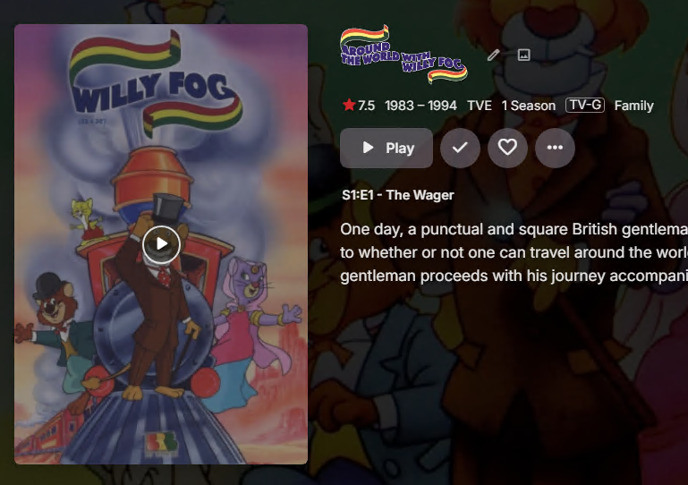

dcook 303 Posted December 30, 2024 Posted December 30, 2024 (edited) I scanned in an old show: V (TV Mini Series 1983) - IMDb Emby initially auto identifies it wrong as: The Thorn Birds (TV Mini Series 1983) - IMDb When I click on identify and input the correct IMDB number: tt0085106 It then shows the correct image: I then select replace images and ok However the correct "V" information is not shown, it has changed to: "Around the world with willy fog" If I repeat the steps above it stays on "Around the world with willy fog" no matter how many times I click on Identify and input: tt0085106 I have then tried running a library scan, and metadata folder scan, no change Any ideas? I have not had any other issues with correcting wrong metadata, the process I described above always worked, I don't know why for this one its not. Duane Edited December 30, 2024 by dcook

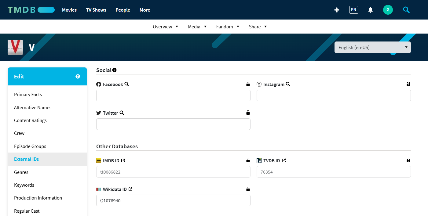

GrimReaper 4927 Posted December 30, 2024 Posted December 30, 2024 (edited) 1 hour ago, dcook said: My concern is that when I select the correct data, and click apply, its not applied and instead it changes to "Around the world with willy fog" would this be a bug? No, it likely wouldn't be. Without server log it's hard to tell which actual queries were made - and what were the responses, but based on your description and screenshots: that was not "correct" data (IMDBId tt085106). It is not "false" either, depending on what does one look for, but it is incorrect in this particular scenario/Emby-wise. To put things in perspective: IMDBId is used only for lookup at online providers' databases (TVDB, TMDB, OMDBApi...) - meaning if that IMDBId is not associated with an item with those providers, it is as if it doesn't exist/it isn't utilized. TVDB has single entry for the original "V (1984)" TV show: V - TheTVDB.com IMDBId associated with that show is tt0086822, not tt085106 (you can follow the IMDB link in "On other sites" section on the above TVDB page). IMDB has two entries for "V" TV show: 2 episode Mini-series: V (TV Mini Series 1983) - IMDb (tt085106) 19-episode series: V (TV Series 1984–1985) - IMDb (tt0086822) TVDB has a single entry, with 2-parts Mini-series being Special episodes of the same series: V - Unknown - Specials - TheTVDB.com So, you can only identify that series with tt0086822 (with naming those Mini-series episodes accordingly: S00E01 and S00E02) if you insist on using IMDBId; otherwise, go with TVDBId 76354 as suggested by @pwhodgesabove. https://emby.media/support/articles/TV-Naming.html#id-tags-in-folder--file-names Edit: Alternatively, move TMDB on top of your library preferred meta-providers (as "V (1983)" and "V (1984) are listed separately there, with properly associated IMDBIds). Identify, download metadata, lock item to prevent further changes, revert TVDB as top-preferred meta-provider. Edited December 30, 2024 by GrimReaper Append
dcook 303 Posted December 30, 2024 Author Posted December 30, 2024 I will try using the tvdb id's, but I am still confused by this behavior. Like I showed in my screen captures, when I click identify and put in: tt0085106 it shows me the correct image, but when I click on it, and then click on replace images and ok, emby is not doing what I told it to do. Meaning, it didn't put the image for tt0085106, instead it puts "Around the world with willy fog" image Obviously the imdb id worked, if it found it when I put it in after clicking identify, just don't understand why instead its putting something else.

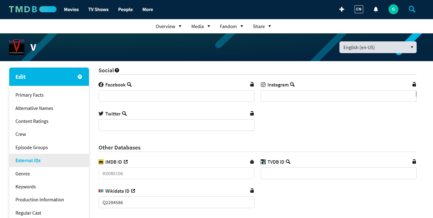

GrimReaper 4927 Posted December 30, 2024 Posted December 30, 2024 (edited) 16 minutes ago, dcook said: Like I showed in my screen captures, when I click identify and put in: tt0085106 it shows me the correct image And like already said: that is not "correct" result in your particular scenario, according that resulting poster image and year - it is likely search result from TMDB (not TVDB) which does not have TVDBId associated (hence no pointer/redirect/reference) as per posted image: 57 minutes ago, GrimReaper said: Identify with tt0086822 instead and you should be sorted. Or make TMDB top-preferred TV show library provider/identify/lock/revert. Edited December 30, 2024 by GrimReaper
dcook 303 Posted December 30, 2024 Author Posted December 30, 2024 I used the TMDB ids's and it looks proper now: I will use TMDB in the future, I never had a problem with IMDB in the past, so I just found it strange that it was replacing what I selected with "Around the world with willy fog" which isn't even close to V
Luke 42290 Posted December 30, 2024 Posted December 30, 2024 Emby doesn't have a direct Imdb id lookup, so when you use that to search, it will be used with your primary metadata provider. Both tvdb and Moviedb support searching by imdb id, but often times they don't have the values in their database for some titles (or they could be wrong). When you name your files and folders using provider ids, it is best to stick to MovieDb and Tvdb.
