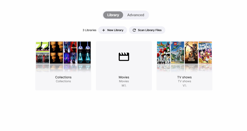

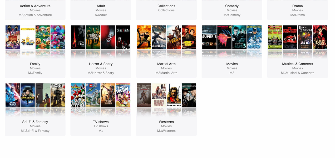

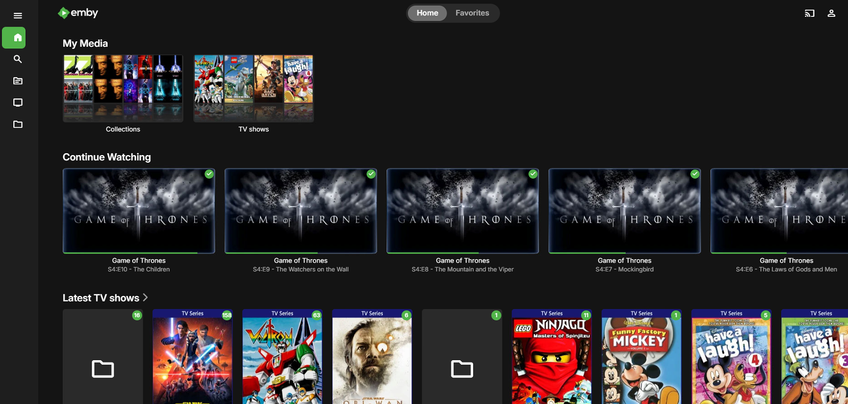

Mazter Jedi 3 Posted December 30, 2024 Posted December 30, 2024 Hey guys. I have gone thru the forums looking for a solution and have been unable to find a fix that works for me. I upgraded my hard drives in my Emby server to larger ones. Copied all my files to external drives, physically replaced the drives, copied all the files back. Same folder structure, same files, everything. Fixed my library settings since some drive letters were changed. Emby finds and identifies all my TV shows just fine. However none of my movies show up on the home screen. The library screen in settings shows the different folders with images for the movies therein, but nothing on the home screen. It does show Collections, with images, but clicking it says "No Items Found". I went thru and deleted everything except the MP4/MKV files and let Emby re-do the entire thing scratch over a few hours, and same thing. I have checked to make sure somehow my movies were being omitted from the home screen but it doesnt seem that way. Any help would be much appreciated. TIA.
GrimReaper 4843 Posted December 30, 2024 Posted December 30, 2024 You have Movies library path as root "M:\" while the other libraries have their paths as its children. You need to change that to something like "M:\Movies". Though your current setup with those overlapping/nested paths (and adding/removing them) might break your database, YMMV.

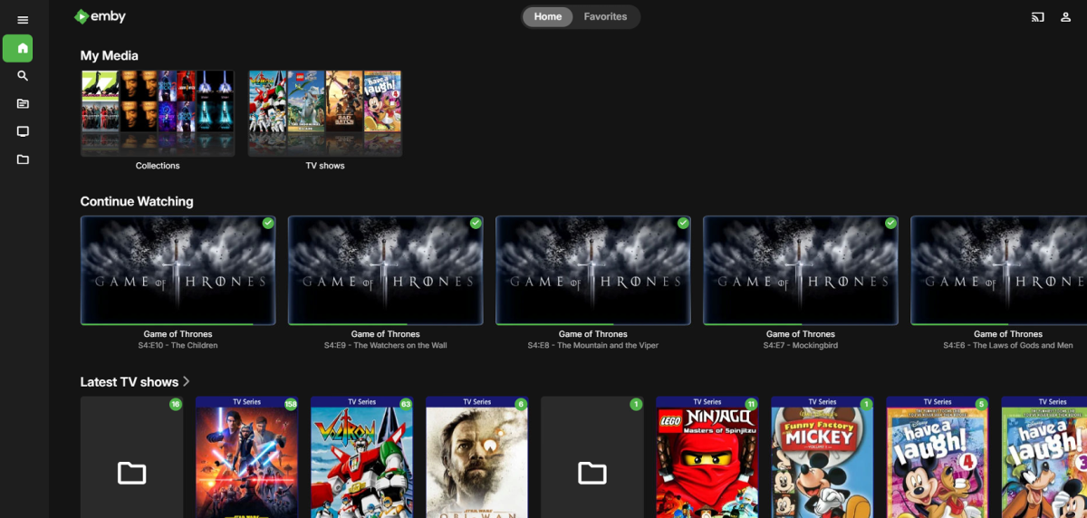

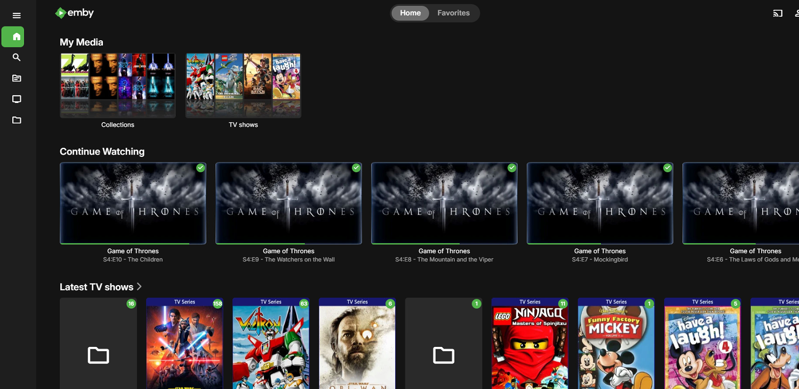

Mazter Jedi 3 Posted December 30, 2024 Author Posted December 30, 2024 So I tried as suggested and put all the movies (in individual subfolders, no longer separated by genre) and here it what I get:
pwhodges 2023 Posted December 30, 2024 Posted December 30, 2024 Please show us the exact folder structure you have now, and the library definition; otherwise we're still guessing just what you're situation is. Paul 1

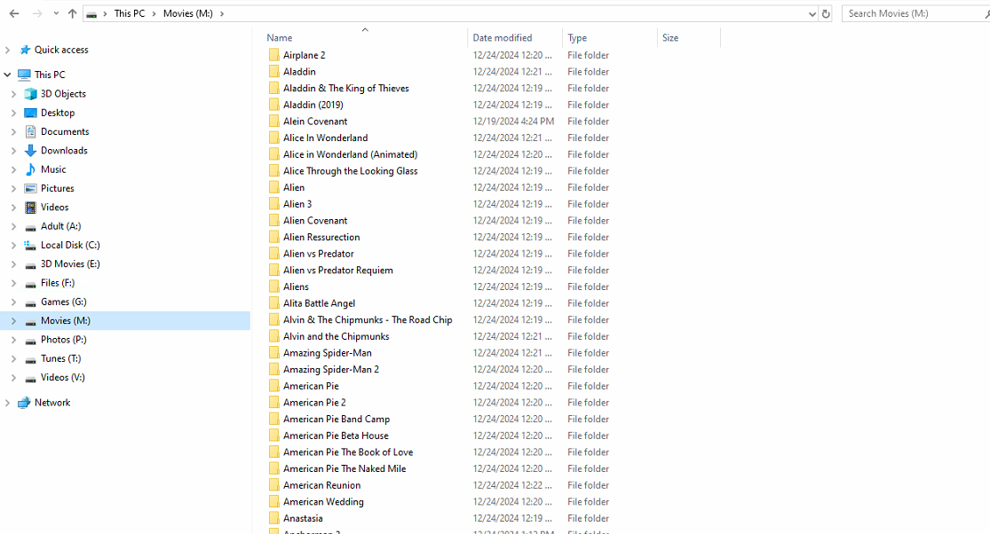

Mazter Jedi 3 Posted December 30, 2024 Author Posted December 30, 2024 It was always M:\Action, M:\Comedy, etc. Each subfolder, representing a genre, had the movie in indivitual folders, such as M:\Action\Top Gun\Top Gun.mp4 I scrapped the subfolders and just put all the movie folders right on M:, such as M:\Top Gun\Top Gun.mp4

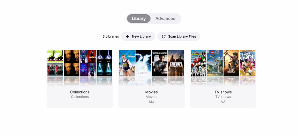

Mazter Jedi 3 Posted December 30, 2024 Author Posted December 30, 2024 So here is the latest after letting the meta scan finish.
Solution GrimReaper 4843 Posted December 30, 2024 Solution Posted December 30, 2024 1 hour ago, GrimReaper said: does your user have permission to view/access all those libraries in Settings>Users tab in the sidebar>edit desired user>Access tab up top? 1
Mazter Jedi 3 Posted December 30, 2024 Author Posted December 30, 2024 No, I didn't. Not sure how that changed. Like I said, same everything, same install, same settings, everything. Sure enough it was a check box. I never thought to check it since I am the "owner" or "admin" and there are no other users. Don't think I am going to bother putting things back in subfolders now LOL. Thanks alot. Sometimes you just need another sets of eyes! 1 1
