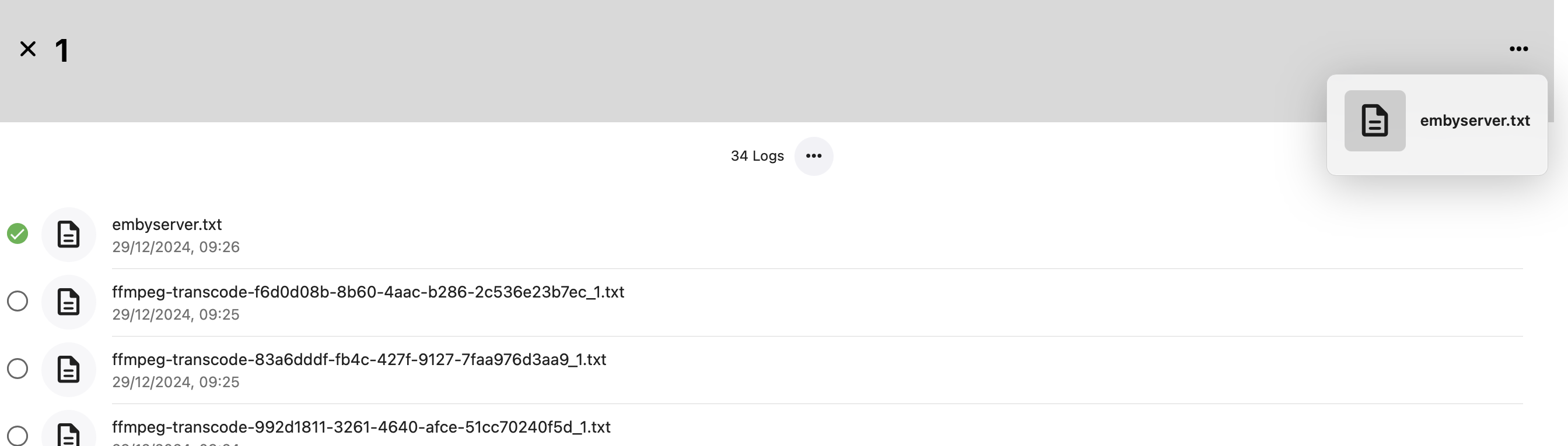

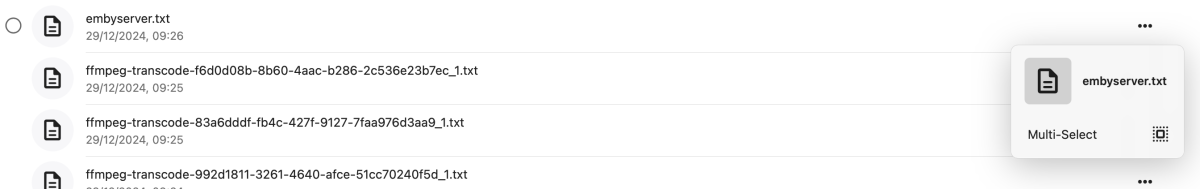

musictalks 2 Posted December 28, 2024 Author Posted December 28, 2024 I have static addresses for the embyserver and the tuners. It's been an hour and the beta seems to have solved my tuner issues. Normally, I get errors after one or two channel switches. I'm feeling positive about this now. I've used emby for many years and have found it to be continually evolving. Lurking around the community over the years has shown me many useful features. Even today, finding the subtitle options from the 3 dots. I'm glad to be a part of this growing community. On the server log page, the 3 dots don't show an option to download the file, only multi-file select. The 3 dots at the top-right show a blank dropdown. I have been locating the log files with finder.
