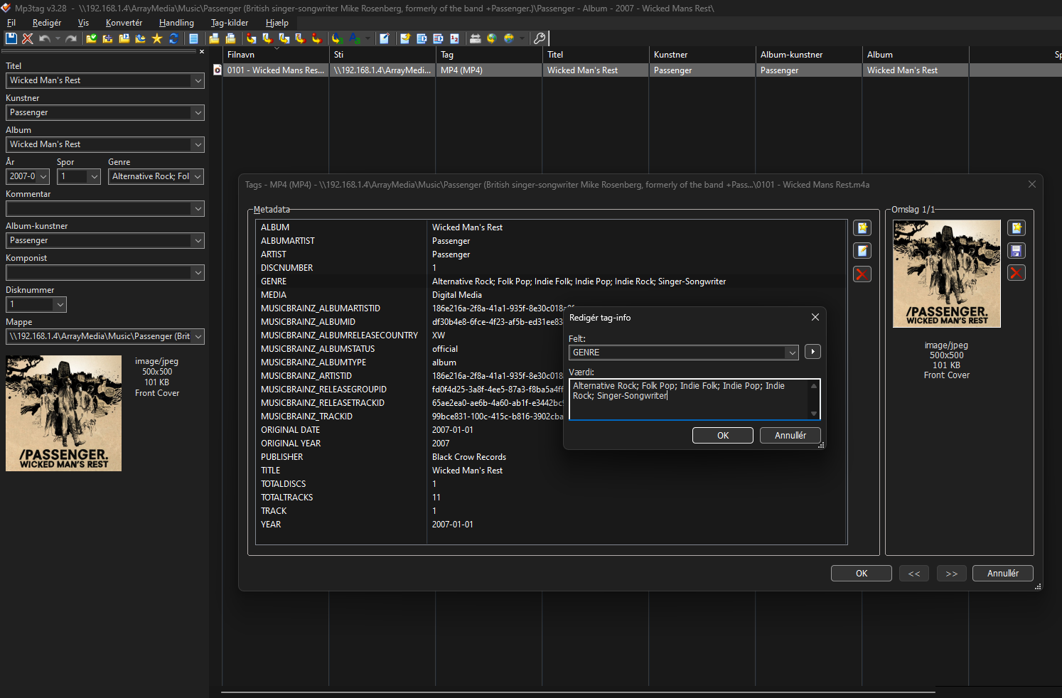

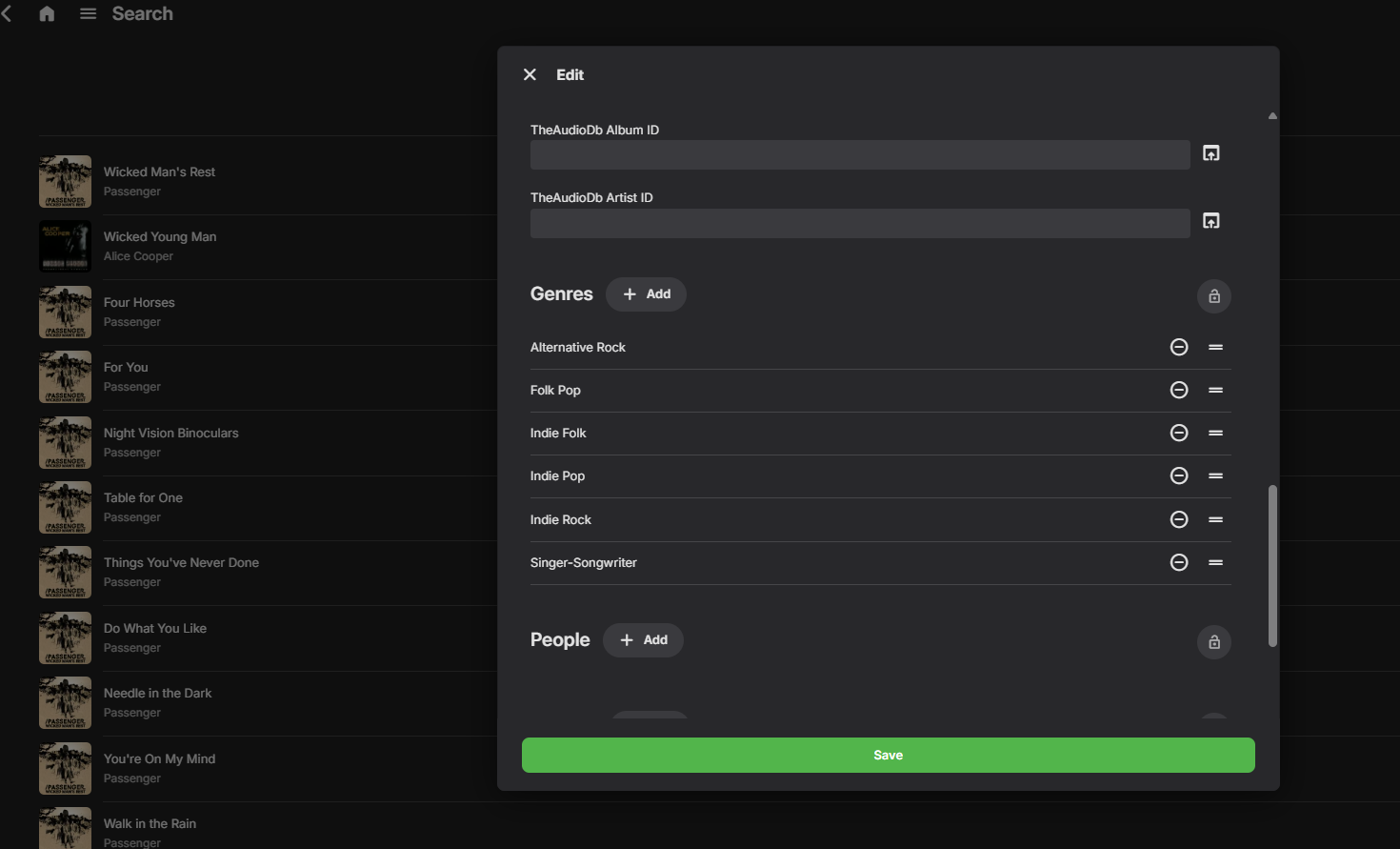

Neminem 1592 Posted December 27, 2024 Posted December 27, 2024 I use mp3tag and that can insert multi genre and Emby sees them. I use Semicolon as a seperator. 1 1

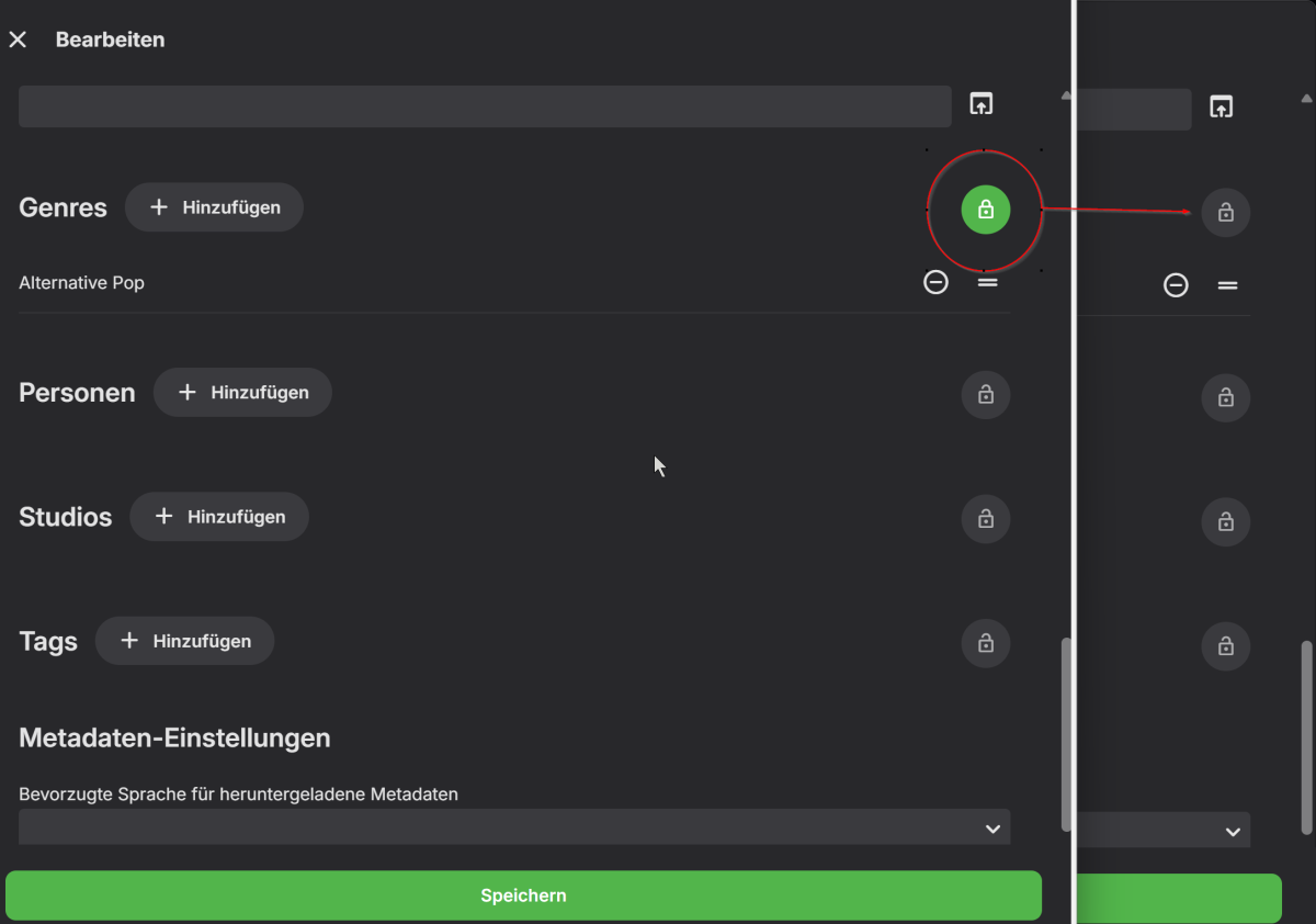

DrHermel 0 Posted December 27, 2024 Author Posted December 27, 2024 Super, vielen Dank! Jetzt hat es bei mir auch funktioniert! Ich musste aber noch das Schloss deaktivieren und abspeichern. Vorher hat emby die Genres wohl nicht überschreiben können. Siehe Screenshot. Vielen lieben Dank auf jeden Fall
Neminem 1592 Posted December 27, 2024 Posted December 27, 2024 Yes the lock is doing its job, that's good. But can be annoying when, we forget about it
DrHermel 0 Posted December 27, 2024 Author Posted December 27, 2024 Yes, the lock does a very good job. The only stupid thing is that I never set it to be locked. So now I have to open the lock by hand for every song. Let's see if I can find an alternative to it. I'll probably just edit everything with mp3tag and then re-read the music folder. After that I will look at the lyrics of the songs. I already have it in the folder as a text file. :-)
Luke 42183 Posted December 27, 2024 Posted December 27, 2024 When you edit in the metadata editor it will automatically lock the field, so you usually don't need to click the lock button. 1
