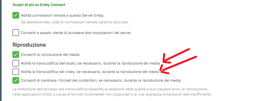

Hispanico957 23 Posted January 6, 2025 Author Posted January 6, 2025 5 hours ago, SamES said: @Hispanico957can you please try disabling hardware transcoding on the server and retry playback? Thanks. In settings user untick this ? Hispa
Hispanico957 23 Posted January 6, 2025 Author Posted January 6, 2025 (edited) YESSSSSSSSSSSSSSS SOLVED thank SamES I disable all hardware transcoding see my 2 screenshot and all movies also 4K work fine Thank and good day Hispa P.S. Just a little clarification, my friend besides samsung it has as said above a TV philips where it has Emby Android. Is it better to create 2 different users one with transcoding activated and the other not ? Edited January 6, 2025 by Hispanico957
Luke 42239 Posted January 6, 2025 Posted January 6, 2025 HI, you don't need to uncheck those options because Emby will already try to direct play whenever possible. There is nothing you need to do to force that.
SamES 1084 Posted January 7, 2025 Posted January 7, 2025 14 hours ago, Hispanico957 said: YESSSSSSSSSSSSSSS SOLVED thank SamES I disable all hardware transcoding see my 2 screenshot and all movies also 4K work fine Thank and good day Hispa Awesome, thanks for confirming. @softworkz, we should work out why hardware transcoding is not working for this system. Can you please confirm if there are any obvious issues from the previous logs?
