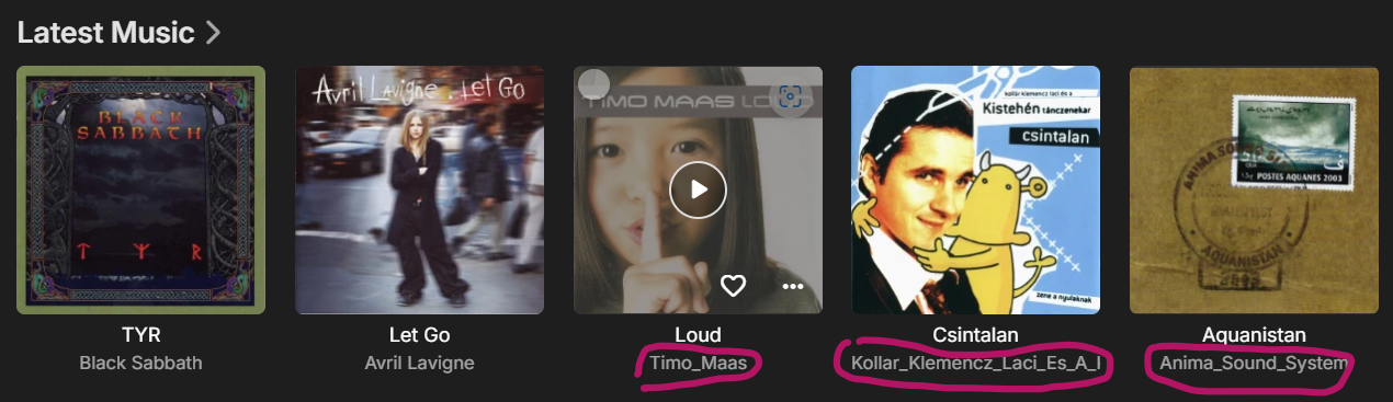

bsapi 14 Posted December 24, 2024 Posted December 24, 2024 I cannot find momentarily better title but I organize my music into artist\album format and it worked well. Today I have added a new artist and album like this: Manu_Chao\Clandestino and Emby took exactly liket that Manu_Chao. I removed identity. I removed and readded the files but Emby keeps showing Manu_Chao. Files are correctly tagged with Manu Chao only the name of the directory is Manu_Chao and Emby sticks with it. Any idea what is happening here ? Thank you in advance.
Luke 42183 Posted December 25, 2024 Posted December 25, 2024 Quote but I organize my music into artist\album format and it worked well. HI, when you specify this as your file and folder layout, if the file is not tagged with the necessary embedded information, then the folder name will be used as the artist name. It needs to be tagged with an albumartist value.

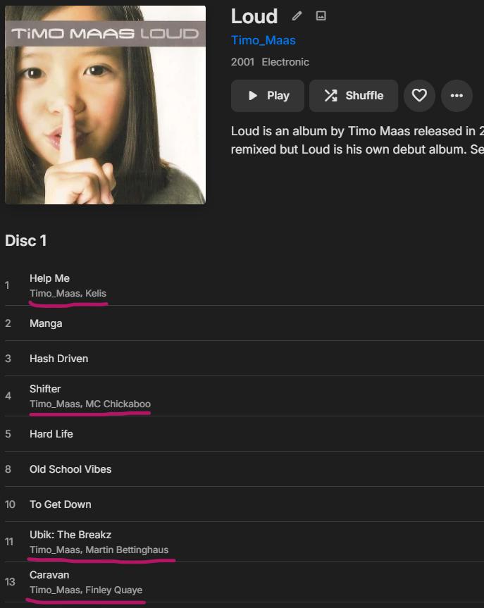

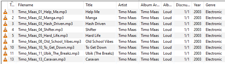

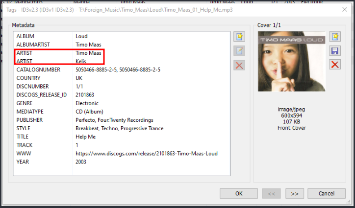

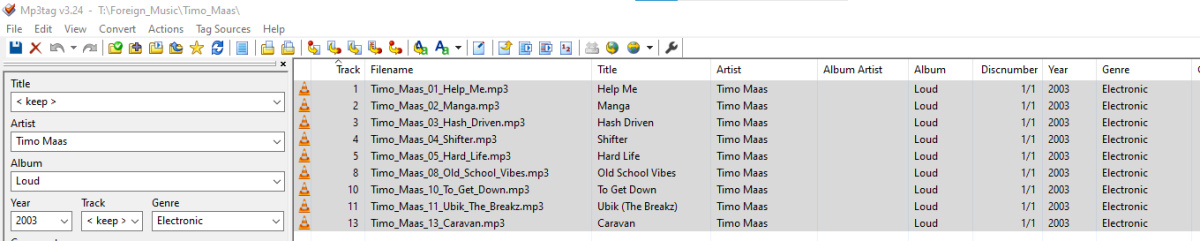

bsapi 14 Posted December 28, 2024 Author Posted December 28, 2024 19 hours ago, Luke said: How exactly are the files tagged? Hello and thank you. You can see the folder structure in the top left corner (Foreign_Music\Timo_Maas) And you can see the taging information of the files.
Solution Luke 42183 Posted December 28, 2024 Solution Posted December 28, 2024 1 minute ago, bsapi said: Hello and thank you. You can see the folder structure in the top left corner (Foreign_Music\Timo_Maas) And you can see the taging information of the files. Hi, yes as you can see the album artist value is empty, so this explains why it is happening. Artist and album artist are two different things. We can't just use the artist value in place of album artist as that could cause problems for other titles (e.g. albums with multiple artists). 1 1
bsapi 14 Posted December 28, 2024 Author Posted December 28, 2024 Hello and thank you. You're right like always. I changed the taging of files and it works correctly now. I marked your answer as Solution. I haven't realized that Album Artist is the key. Thank you. 1

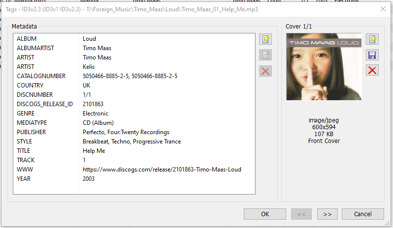

bsapi 14 Posted December 31, 2024 Author Posted December 31, 2024 2 minutes ago, user24 said: Hi, have you tried looking at the Extended Tags section in Mp3tag to see all of your tags? View>Extended Tags from the menu (or Alt-T). You may have both "Album Artist" and "AlbumArtist" tags. Both of these tags are not typically shown in the default LHS tag panel. One of these (or potentially other extended or hidden tags) could be causing the problem? Hello and Thank You. This is what I can see by pressing Alt + T
user24 330 Posted December 31, 2024 Posted December 31, 2024 Hmmm, at a glance nothing stands out as obviously incorrect - if it's an "AlbumArtist" and "Album Artist" difference, it's very easy to see with this view. Something else you could perhaps try as a test (if you haven't already) is going to Tag Sources>MusicBrainz and retagging the whole problem album. (You may want to make a backup file first.) If I think of anything else I will let you know...

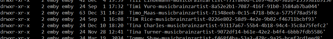

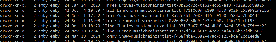

bsapi 14 Posted December 31, 2024 Author Posted December 31, 2024 25 minutes ago, user24 said: Hmmm, at a glance nothing stands out as obviously incorrect - if it's an "AlbumArtist" and "Album Artist" difference, it's very easy to see with this view. Something else you could perhaps try as a test (if you haven't already) is going to Tag Sources>MusicBrainz and retagging the whole problem album. (You may want to make a backup file first.) If I think of anything else I will let you know... Hello and Thank you. Retagging has been done but didn't help. This false information comes from Emby but I don't know what I need to clean up. Cache was completely deleted (several times). I even deleted and rebuilt metadata information under /var/lib/emby/metadata/musicartists I cannot see Timo Maas by the way

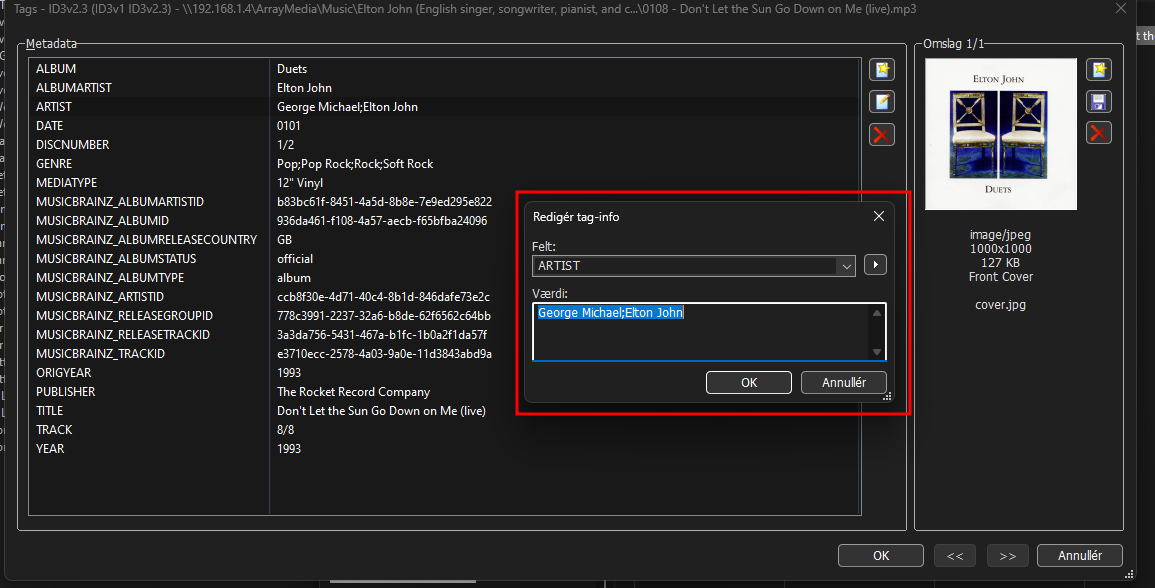

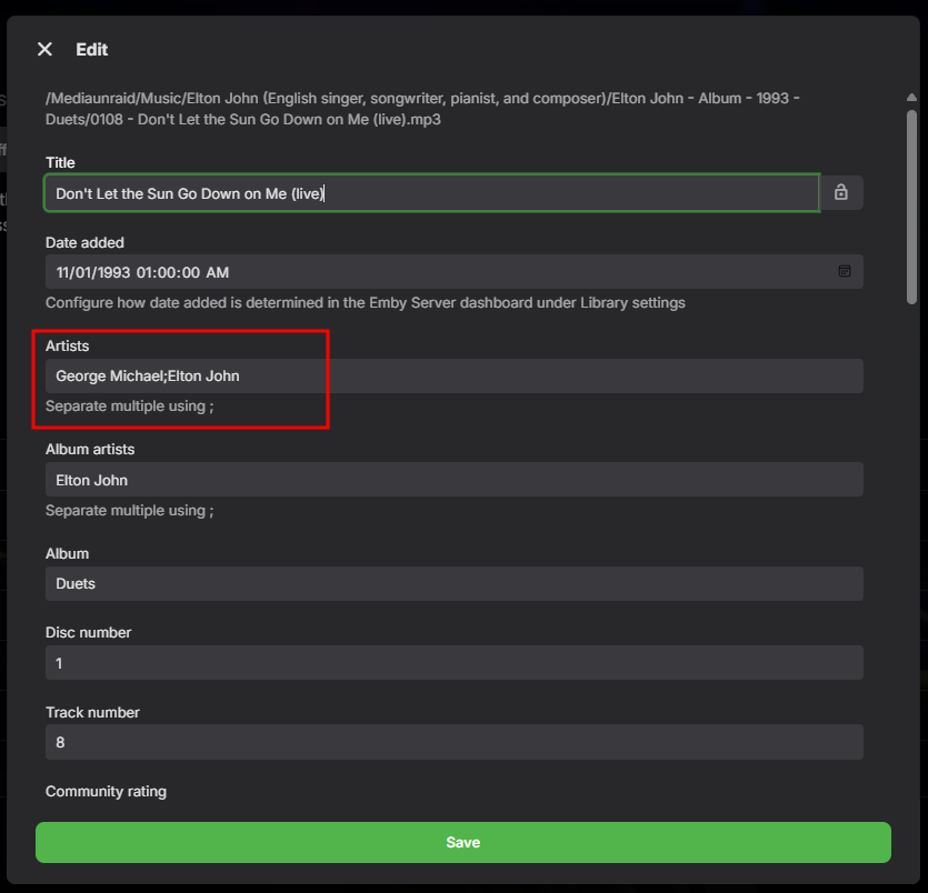

Neminem 1592 Posted December 31, 2024 Posted December 31, 2024 Just out of curiosity is Kelis also an artist in this song / album. Here is what I do when its a Duet. I add them into 1 Artist separated by semicolon ;
bsapi 14 Posted December 31, 2024 Author Posted December 31, 2024 4 minutes ago, Neminem said: Just out of curiosity is Kelis also an artist in this song / album. Here is what I do when its a Duet. I add them into 1 Artist separated by semicolon ; Same result happens if I add two Artists to a track. I use Timo Maas\\Kelis format because It is recommended by Mp3tag community.
