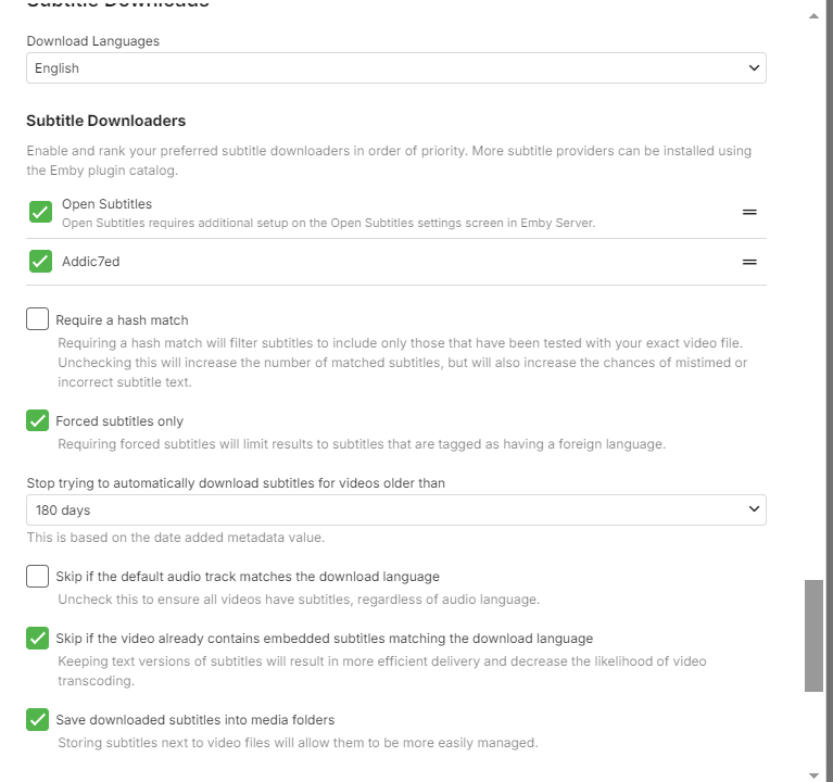

ziadmoataz 1 Posted December 24, 2024 Posted December 24, 2024 first of all i followed the steps in knowledge base https://emby.media/support/articles/Automatic-Subtitle-Downloads.html?q=subtitle i did everything there i tried even disabling the hash check and i tried it didnt work how i tested it that i went to scheduled tasks and i ran the Download subtitles and then i went to a random episode and ran it and no subtitles were shown so i dont know what do do i have open subtitles and addic7ed and i doublechecked the login and password for them
ziadmoataz 1 Posted December 25, 2024 Author Posted December 25, 2024 +i tried restarting the server removing the plugins and adding them nothing is working

Solution Lessaj 477 Posted December 26, 2024 Solution Posted December 26, 2024 Try disabling "Forced subtitles only".
ziadmoataz 1 Posted December 26, 2024 Author Posted December 26, 2024 thank you it worked do you have any idea if i can make it download 2 subtitles for each episode in case 1 of them is our of sync
Lessaj 477 Posted December 26, 2024 Posted December 26, 2024 No you'll have to check that yourself and manually download a different version using the search for subtitles option on each episode.
Luke 42183 Posted December 26, 2024 Posted December 26, 2024 You can also check the box to require a hash match, but obviously that's a trade-off and will result in fewer successful downloads.
