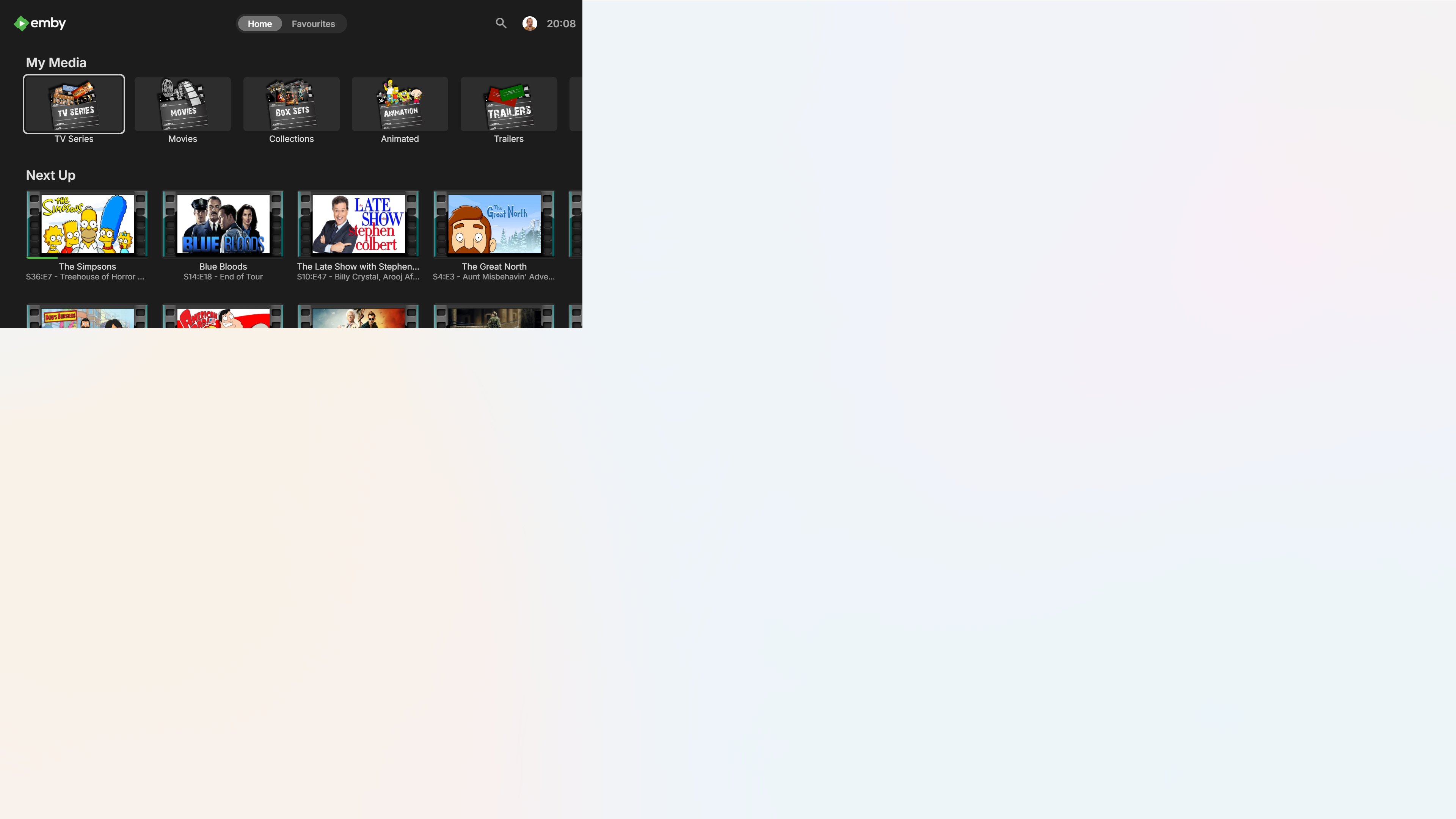

pgriffith 88 Posted December 24, 2024 Posted December 24, 2024 App runs great, very impressed with it so far. But... When I turn my TV off and then turn it on again the next day the app is no longer fullscreen (see screenshot) and shrunk into the top left corner of the screen. Fortunately, the app still responds to the IR remote so I can close and restart it again. When I exit the program it does go full screen for a split second and plays the closing animation (very cool btw) If I recall correctly Emby Theater had the same issue in its early days as well.

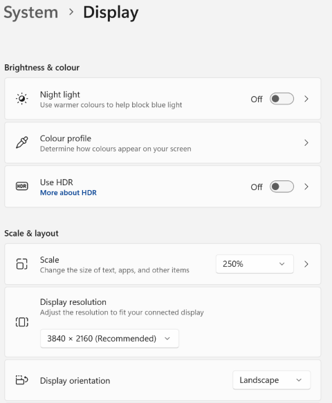

softworkz 5133 Posted December 25, 2024 Posted December 25, 2024 I'm aware of two cases when turning off the HDMI target: Either: the output is maintained, so the desktop layout doesn't change - everything remains the same as if the TV (or other target) would still be ON You can move the mouse to this area and also drag windows there - you just don't see it Or: the display is removed from the desktop area (like when unplugging the cable), which makes Windows move all windows which were shown on that display to the remaining display area, so you can see and work with them Which of these applies to your situation? Or are you saying you are seeing a 3rd case where there's still a display which is extending your desktop but it has a lower resolution after switching it off? Can you post a screenshots of your "Display Settings" in cases when it's on and off?
pgriffith 88 Posted December 26, 2024 Author Posted December 26, 2024 Hey Softworkz I think you misconstrued my resolution comments, I have annotated the original screenshot and attached below. The only part of it that can be interacted with is the shrunken Emby, the "white ish" area cannot be, you don't get resize arrows if you move the mouse to the edge of it or anything like that. So, of your two case scenarios, this is kind of case 2 except that instead of shrinking the whole app to the top left corner, it maintains the 4k res with the white background and Emby shrunken. Out of curiosity, as the ratio of the Emby displayed in the screen shot is exactly the same as the scale setting of 250%. I set scaling to 100% which of course makes everything impossibly tiny on the desktop, this fixes the issue when turning the TV off, so it's DEFINITELY something to do with the scaling setting. I would really prefer not to have to leave it at 100% as I do use that machine for work stuff (Zoom, Teams etc, I work from home). As for the Display setting, this is with the TV on, then I turned it off and used an app called Remote Utilities to connect and the settings were identical so I didn't take another screenshot.
softworkz 5133 Posted December 26, 2024 Posted December 26, 2024 18 minutes ago, pgriffith said: As for the Display setting, this is with the TV on, then I turned it off and used an app called Remote Utilities to connect and the settings were identical so I didn't take another screenshot. Ah, so you don't have multiple displays, just the TV, and when it's off, and you use "remote utilities" these are probably creating a kind of virtual display which has 100% scaling I assume. So effectively, your primary display is changing - from one with 250% scaling to one with 100% scaling and back. This makes it a very specific and unusual case. It's not a typical use case. I don't have "remote utilities", neither do I want to install such software, which makes it difficult to even reproduce.

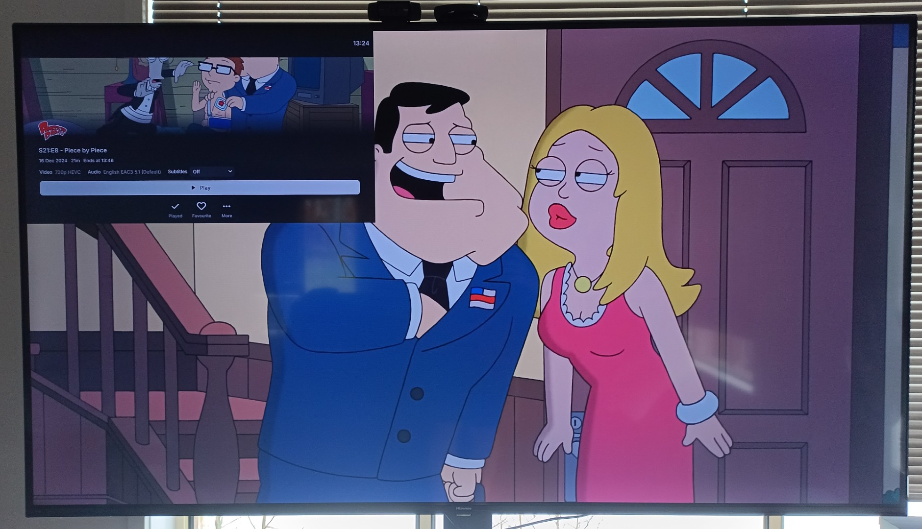

pgriffith 88 Posted December 26, 2024 Author Posted December 26, 2024 (edited) It happens regardless of Remote Utilities, I just uninstalled it, and the same shrinking behaviour happens at 250% scaling. I only used Remote Utilities to get a look at the Display Settings for you when the TV was off. Edit: Interestingly instead of closing shrunken Emby and restarting it, I instead opted to play a video. The video plays fullscreen as normal, if you then stop it the shrunken Emby remains onscreen while the fullscreen Video Backdrop plays under it. It was easier to take a photo of this than trying to screenshot it. Edited December 26, 2024 by pgriffith Clarification
