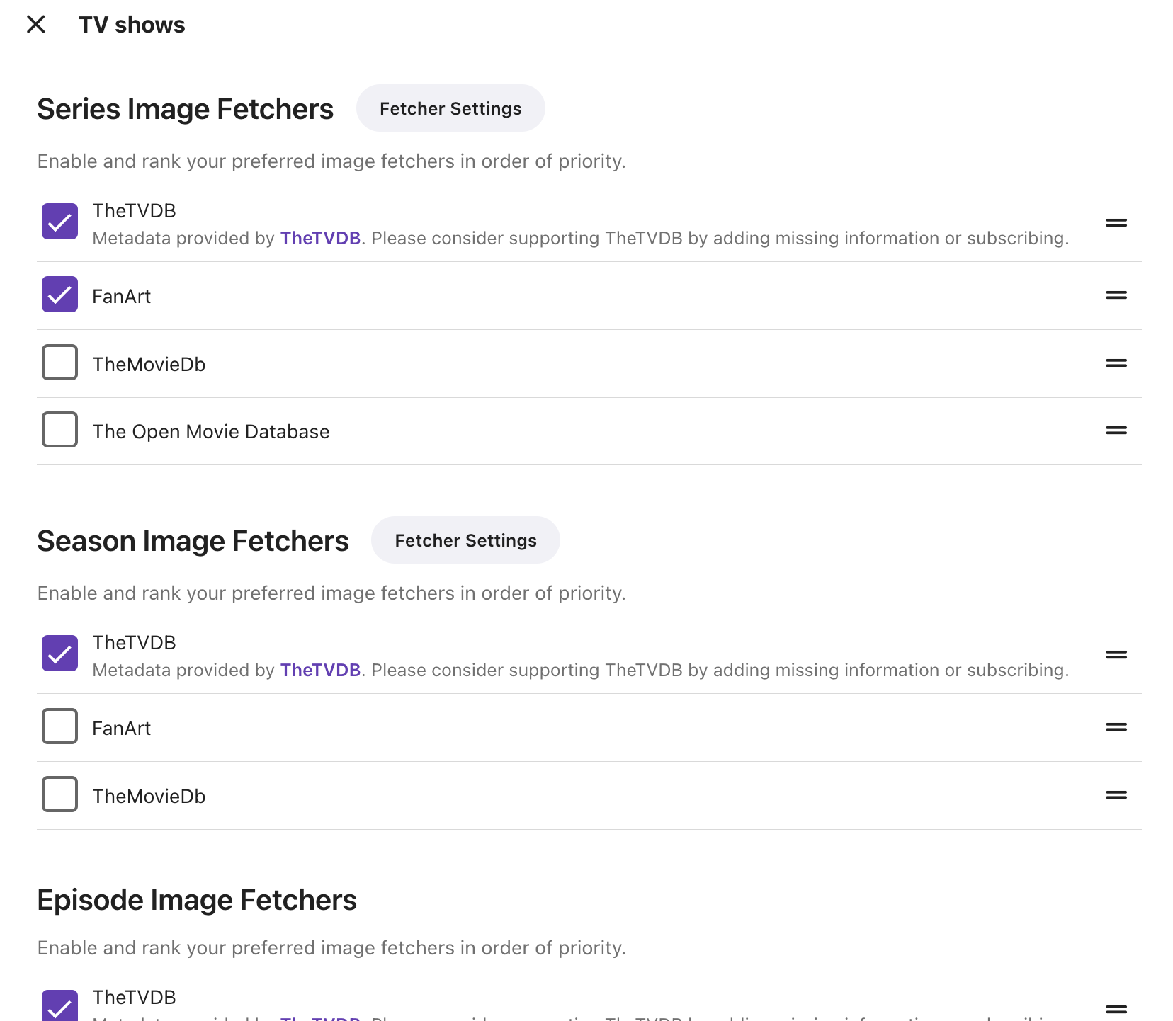

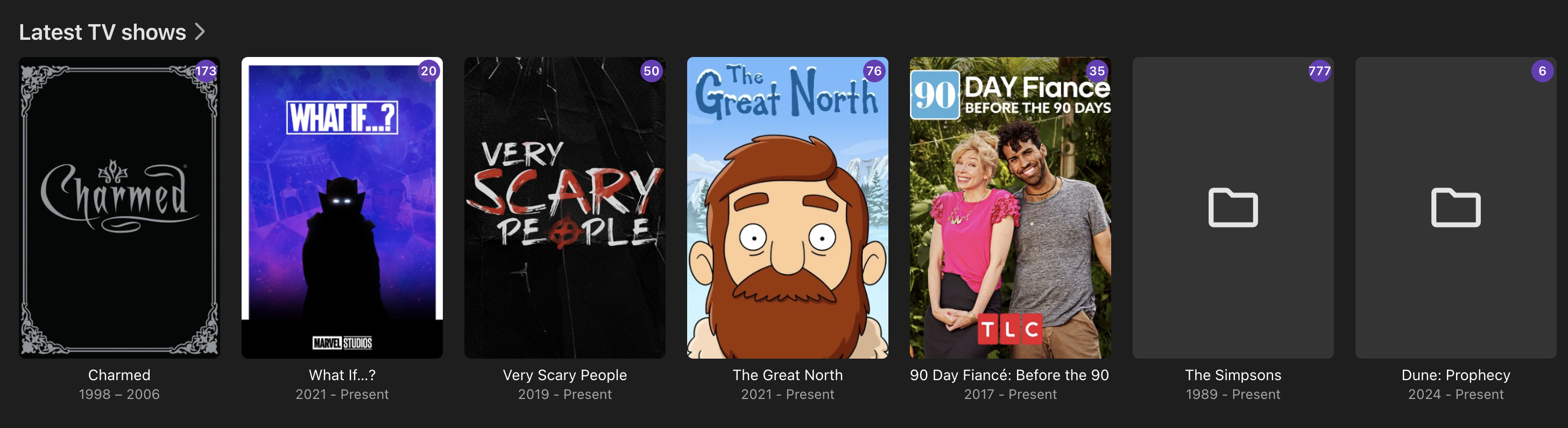

Tophicles 40 Posted December 24, 2024 Posted December 24, 2024 I have a problem where the Primary images are not loading. I've done a total library rebuild and done a full scan twice, plus a full metadata refresh. If I go into an item and search for the primary image, it will show up and then I can attach it but for a large library this is exhausting. Any thoughts? Log attached. Please let me know if any further information is required. embyserver.txt
Luke 42183 Posted December 24, 2024 Posted December 24, 2024 Hi, what metadata and image fetchers are enabled on the library and in what order?

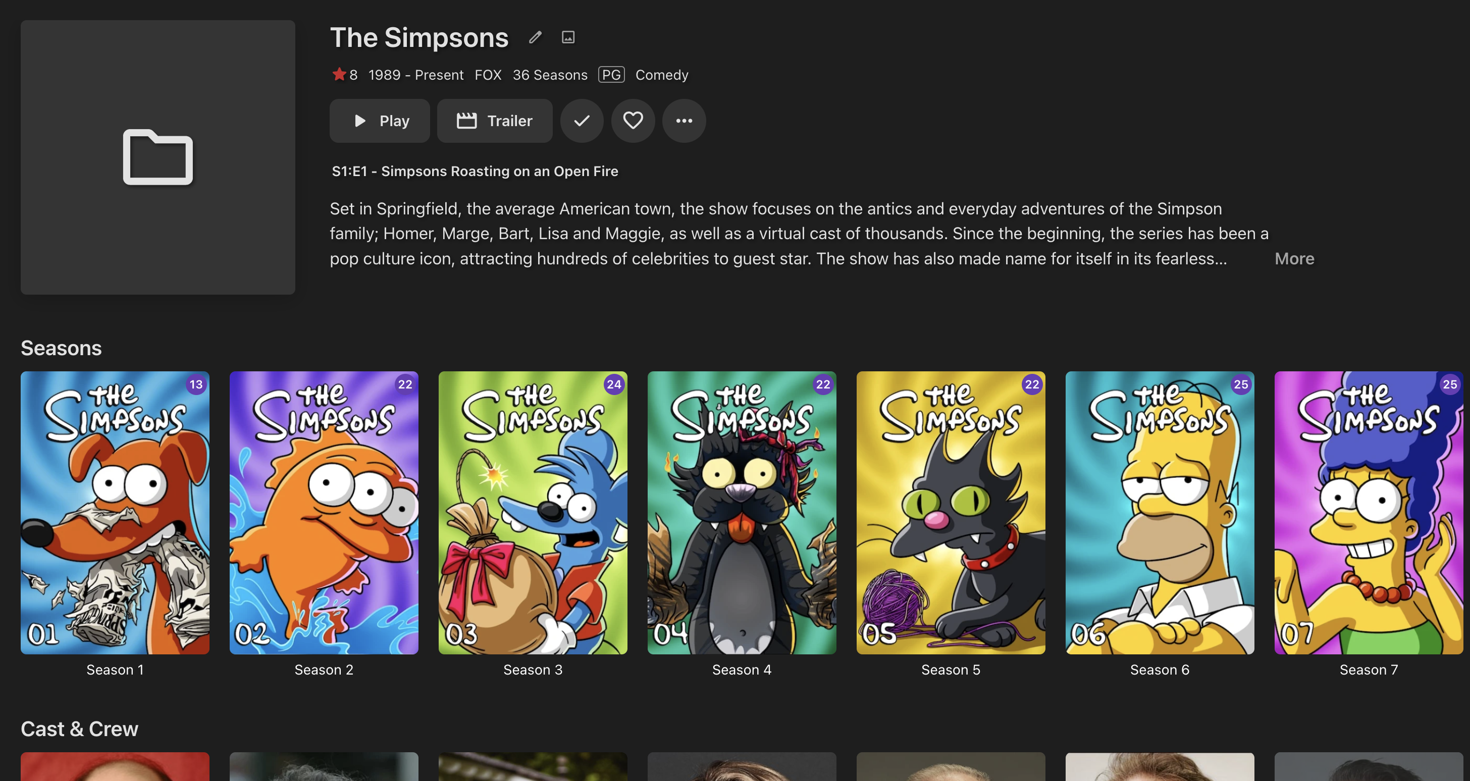

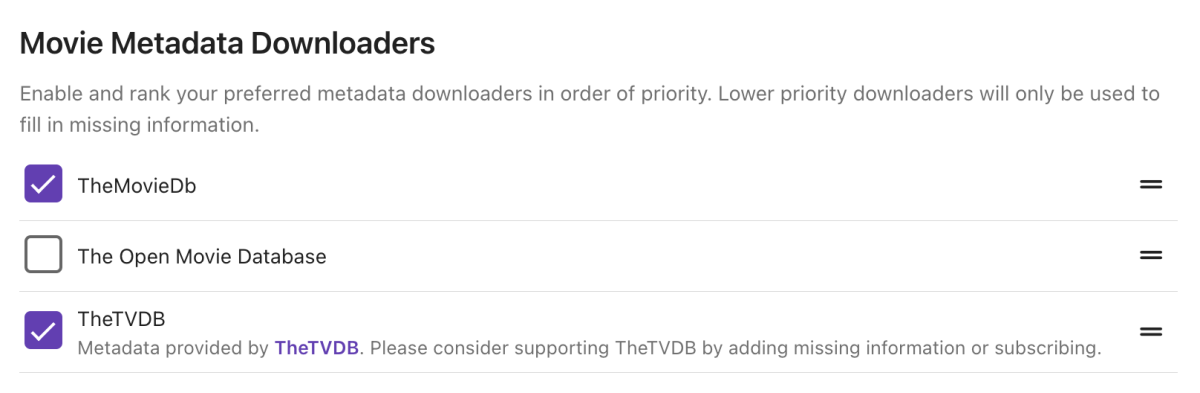

Luke 42183 Posted December 27, 2024 Posted December 27, 2024 On 12/24/2024 at 10:18 PM, Tophicles said: Your screenshots showed the Simpsons but these are movie settings.
Luke 42183 Posted December 28, 2024 Posted December 28, 2024 I would use the image editor to manually select an image for this series. If you add a new series and it doesn't get an image, then please attach the emby server log. For your existing series, it's going to be difficult to try and determine what happened in the past, so I would just fix them up manually.
Tophicles 40 Posted December 28, 2024 Author Posted December 28, 2024 2 minutes ago, Luke said: I would use the image editor to manually select an image for this series. If you add a new series and it doesn't get an image, then please attach the emby server log. For your existing series, it's going to be difficult to try and determine what happened in the past, so I would just fix them up manually. Yeah, using the image editor works fine - the problem is there are over 2300 series so I was hoping to avoid manually touching each one.
Luke 42183 Posted December 28, 2024 Posted December 28, 2024 It will be difficult to figure out why this happened given that it's in the past now. Maybe you tampered with the server metadata folder. Maybe your original image files are no longer there. At this point, who knows. So the best course of action is to just move forward, and then if you catch it happening again, then we can dive into it. You can also refresh metadata at the library level, although there is currently no way to monitor the status of this in the user interface.
Tophicles 40 Posted December 28, 2024 Author Posted December 28, 2024 1 minute ago, Luke said: It will be difficult to figure out why this happened given that it's in the past now. Maybe you tampered with the server metadata folder. Maybe your original image files are no longer there. At this point, who knows. So the best course of action is to just move forward, and then if you catch it happening again, then we can dive into it. You can also refresh metadata at the library level, although there is currently no way to monitor the status of this in the user interface. Fair, thanks for the assistance - I'll forge ahead. I have done the Metadata Refresh at the library level several times and asked it to replace existing images. No luck there. I did remove the old metadata folder - I had assumed it would rebuild when asked via the refresh.
