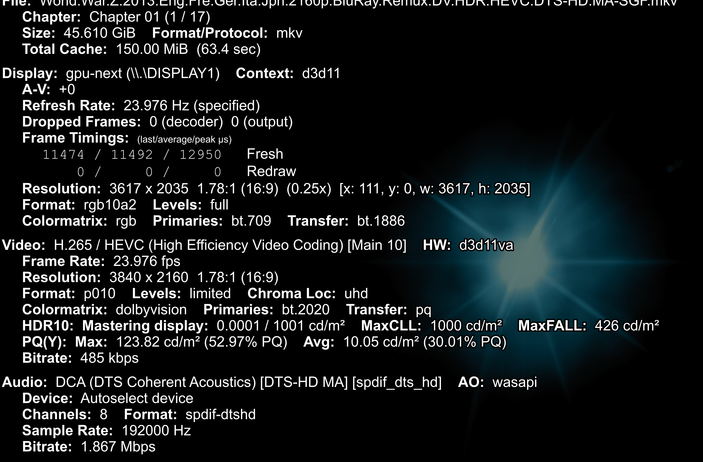

Mahinepua 82 Posted December 24, 2024 Posted December 24, 2024 Send it through, pretty sure its just a flag for DTS-HD that hasn't been configured properly in the new player. Ive tried a number of DTS-HD bluray and 4k remuxes none pass DTS-HD.
Guest Posted December 24, 2024 Posted December 24, 2024 I'm attaching a preconfigured mpv. Just unzip the folder to your desktop. Launch mpv.exe and drop your video on it. What are the results? mpv.zip
Guest Posted December 24, 2024 Posted December 24, 2024 Well, that would imply there is a bug in the Emby build/config somewhere. I wanted to rule out that it was an mpv bug.

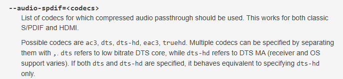

Guest Posted December 24, 2024 Posted December 24, 2024 This might simply be a typo, and missing a hyphen AudioPassthroughFormats: AC3,EAC3,DTS,TrueHD,DTSHD instead of this AudioPassthroughFormats: AC3,EAC3,DTS,TrueHD,DTS-HD
Mahinepua 82 Posted December 24, 2024 Posted December 24, 2024 I think your correct! Softworkz is probably on his 4th beer by now though lol
softworkz 5133 Posted December 24, 2024 Posted December 24, 2024 6 minutes ago, generiq said: This might simply be a typo, and missing a hyphen AudioPassthroughFormats: AC3,EAC3,DTS,TrueHD,DTSHD instead of this AudioPassthroughFormats: AC3,EAC3,DTS,TrueHD,DTS-HD The docs say otherwise: I had dtshd originally as that's what the old app had and it didn't work, so I had double-checked with the docs, changed it to dts-hd as described and the user had reported it as fixed.

Guest Posted December 25, 2024 Posted December 25, 2024 (edited) 6 minutes ago, softworkz said: The docs say otherwise: I had dtshd originally as that's what the old app had and it didn't work, so I had double-checked with the docs, changed it to dts-hd as described and the user had reported it as fixed. You're confirming what just said. The top log quote is directly from the log. The second quote is my correction. As you say, dts-hd is correct, but it appears that dtshd is waht is being applied Edited December 25, 2024 by generiq
Mahinepua 82 Posted December 25, 2024 Posted December 25, 2024 Softworkz was saying dtshd is incorrect documentation shows this should be dts-hd
softworkz 5133 Posted December 25, 2024 Posted December 25, 2024 It's defined correctly, but the conversion from the enum string to the value attribute was missing in this case So, yes you were right. Thanks
Guest Posted December 25, 2024 Posted December 25, 2024 Just now, Mahinepua said: Softworkz was saying dtshd is incorrect documentation shows this should be dts-hd And is exactly what I said and showed
