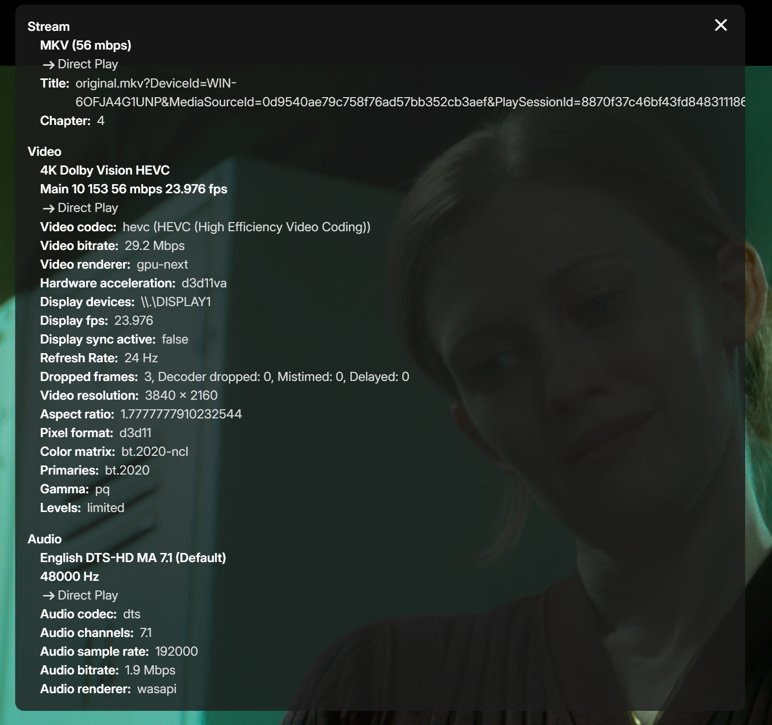

Mahinepua 82 Posted December 24, 2024 Posted December 24, 2024 (edited) stats for nerds from the old player below, these is no way to scroll down in stats for nerds on the new or old I can find. from the new players mpv log does this mean anything? Looks like DTS-HD is not checked for passthrough, but it is. [vd] Using hardware decoding (d3d11va). [autoconvert] HW-downloading from d3d11 [cplayer] AO: [wasapi] 48000Hz stereo 2ch spdif-dts [cplayer] VO: [gpu-next] 3840x2160 p010 I dont think the new player shows audio info in stats for nerds anymore. Edited December 24, 2024 by Mahinepua

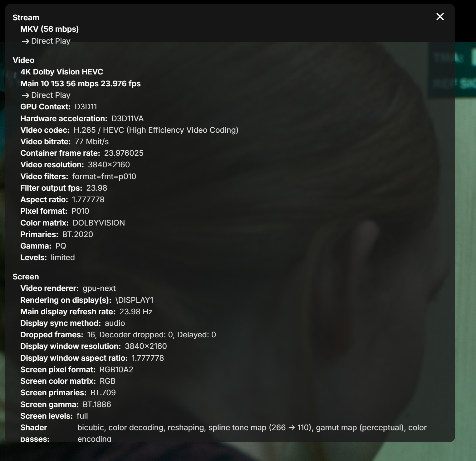

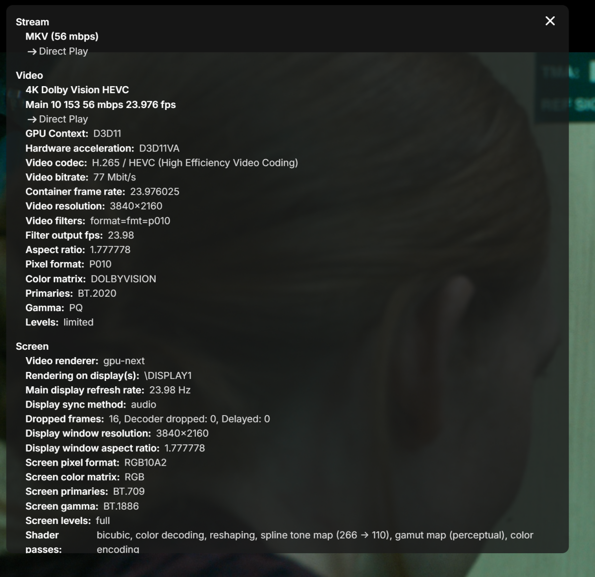

Guest Posted December 24, 2024 Posted December 24, 2024 2 minutes ago, Mahinepua said: stats for nerds from the old player below, these is no way to scroll down in stats for nerds on the new or old I can find. from the new players mpv log does this mean anything? [vd] Using hardware decoding (d3d11va). [autoconvert] HW-downloading from d3d11 [cplayer] AO: [wasapi] 48000Hz stereo 2ch spdif-dts [cplayer] VO: [gpu-next] 3840x2160 p010 The log from the new app is useless. Stats from the new app?
Mahinepua 82 Posted December 24, 2024 Posted December 24, 2024 (edited) Stats for nerds from the new app were posted above, there is no audio info. The MPV log shows DTS-HD is being passed as stereo spdif which would indicate DTS-HD HDMI passthrough is not checked or enabled. [cplayer] AO: [wasapi] 48000Hz stereo 2ch spdif-dts Edited December 24, 2024 by Mahinepua
