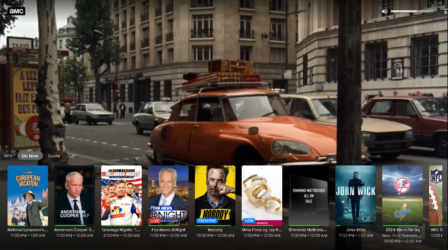

Luke 42234 Posted December 23, 2024 Posted December 23, 2024 Hi, did you try using the On Now section in the video player to switch to a different channel?

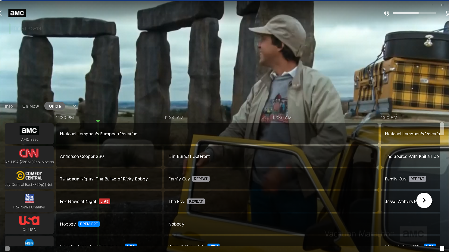

Carlo 4561 Posted December 24, 2024 Posted December 24, 2024 @juandiego79 Check out the different ways of viewing channels or using the EPG grid. You can favorite the channels you use most and set the sort order to put them at the top of the grid. You can even bring up the grid while watching Live TV to see what else is on and switch channels this way while currently watching TV. Carlo
juandiego79 4 Posted December 24, 2024 Author Posted December 24, 2024 On 12/23/2024 at 9:27 PM, Luke said: Hi, did you try using the On Now section in the video player to switch to a different channel? Puedes explicar cómo llegar a esa opción. Cuando reproduzco no aparece esa opción, en la configuración de TV live tampoco.
juandiego79 4 Posted December 24, 2024 Author Posted December 24, 2024 ¿Cómo puedo consultar las diferentes formas de ver canales? He buscado en la configuración de TV Live y no veo la opción de cambiar.
Solution Carlo 4561 Posted December 28, 2024 Solution Posted December 28, 2024 While watching you can bring up the EPG grid while watching any channel. You can also view On Now as well
