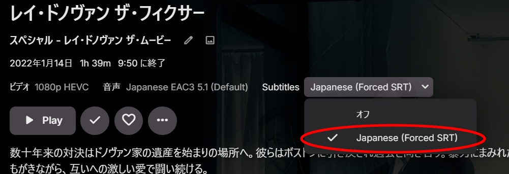

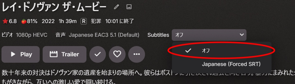

pan26 6 Posted December 23, 2024 Posted December 23, 2024 Hello. Please share your wisdom. File Composition TV SHOW Library ... /AAA.mp4 ... /AAA.ja-jp.forced.srt MOVIE Library ... /AAA.strm AAA.strm is the content showing AAA.mp4. Here, when I look at AAA on the MOVIE library side, subtitles are not recognized. I had no choice but to copy AAA.ja-jp.forced.srt to the same folder as AAA.strm. It was recognized, but when viewed on the TV SHOW side, the subtitles default to “Japanese (Forced SRT)”, but on the MOVIE side, the subtitles default to none. Is there any way to get the subtitles recognized correctly on the AAA.strm side?

pan26 6 Posted December 23, 2024 Author Posted December 23, 2024 3 hours ago, Luke said: Hi, currently in this situation, the subtitles are supported when they are next to the strm file, but not the video file. I understand this and would like to copy and place it next to the strm file. However, can't something be done about the default subtitle settings being different? Since these are forced subtitles, I would like "Japanese (Forced SRT)" to be selected by default on the MOVIE side as well. TV SHOW MOVIE

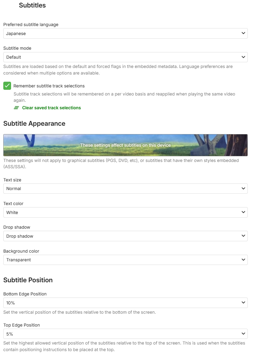

Luke 42290 Posted December 29, 2024 Posted December 29, 2024 27 minutes ago, pan26 said: I tried changing the file name of the subtitle in the same location as the strm file to “xxxxxxx.ja-jp.forced.default.srt” but the subtitle was still off. I wish there was a way to get around this, though. Have you checked your emby user subtitle preferences?
pan26 6 Posted December 29, 2024 Author Posted December 29, 2024 31 minutes ago, Luke said: Have you checked your emby user subtitle preferences? “Subtitle mode” is ‘Default’. The combination of mp4 and forced subtitle leaves forced subtitle selected, but the combination of strm and forced subtitle selects off. I think one of them is the wrong behavior.

Luke 42290 Posted January 16, 2025 Posted January 16, 2025 How have you configured your emby user subtitle options?

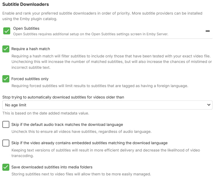

pan26 6 Posted January 18, 2025 Author Posted January 18, 2025 I'm sorry. I was mistaken. User subtitle settings Library subtitle settings Is this correct? If I am misplaced, please point it out.
Luke 42290 Posted January 20, 2025 Posted January 20, 2025 These are the library settings related to downloading. I'm referring to the user settings relating to controlling which tracks get selected. Try clicking your user icon in the top right.
pan26 6 Posted January 21, 2025 Author Posted January 21, 2025 I am sorry. I am very bad at English. Is this screenshot ok?

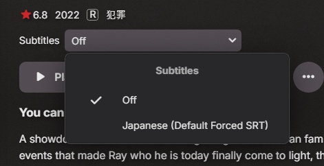

pan26 6 Posted February 3, 2025 Author Posted February 3, 2025 I tried it on Emby Version 4.9.0.37 beta in a test environment. However, subtitles are still selected OFF by default. We hope this will be improved in 4.9.
Luke 42290 Posted February 5, 2025 Posted February 5, 2025 HI, yea as I mentioned it works fine for me. It could be related to other options that you've configured.
