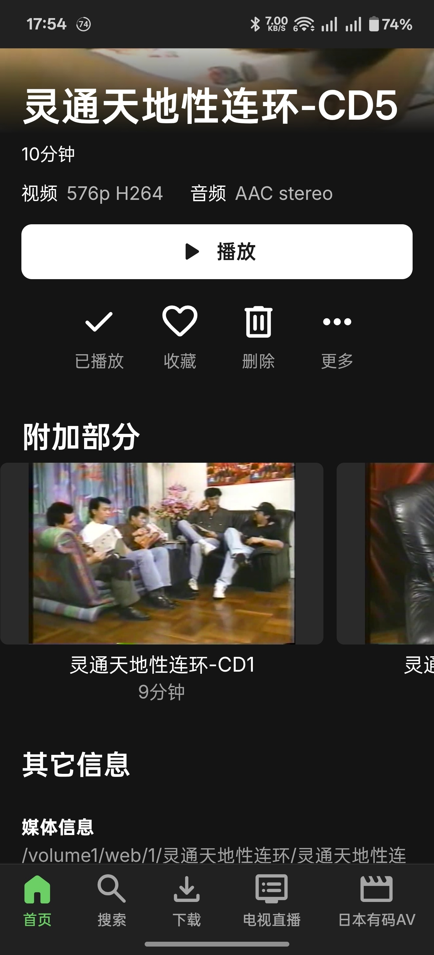

bfogdb20825 4 Posted August 5, 2025 Author Posted August 5, 2025 On 8/4/2025 at 12:18 PM, Luke said: Can you try adding a new movie and see if it happens with that? embyserver (1).txt 2025-08-05 17:49:15.903 Debug App: Found extra AdditionalPart /volume1/web/1/灵通天地性连环/灵通天地性连环-CD2.ts for /volume1/web/1/灵通天地性连环/灵通天地性连环-CD5.ts 2025-08-05 17:49:15.903 Debug App: Found extra AdditionalPart /volume1/web/1/灵通天地性连环/灵通天地性连环-CD1.ts for /volume1/web/1/灵通天地性连环/灵通天地性连环-CD5.ts 2025-08-05 17:49:15.903 Debug App: Found extra AdditionalPart /volume1/web/1/灵通天地性连环/灵通天地性连环-CD4.ts for /volume1/web/1/灵通天地性连环/灵通天地性连环-CD5.ts 2025-08-05 17:49:15.903 Debug App: Found extra AdditionalPart /volume1/web/1/灵通天地性连环/灵通天地性连环-CD3.ts for /volume1/web/1/灵通天地性连环/灵通天地性连环-CD5.ts 2025-08-05 17:49:15.912 Debug App: Running FFProbeProvider for /volume1/web/1/灵通天地性连环/灵通天地性连环-CD5.ts I created a new folder and a new media library, but the issue still persists — the items are still out of order. I’m surprised such a simple bug still hasn’t been fixed after all this time. embyserver (1).txt
Luke 42239 Posted October 11, 2025 Posted October 11, 2025 @bfogdb20825OK I think I've finally tracked this down. Please let me know if the next build resolves it. Thanks !
