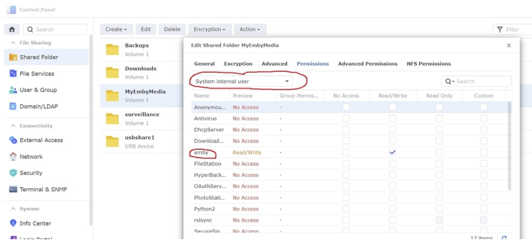

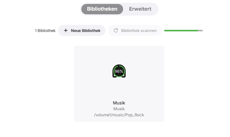

Neminem 1623 Posted January 15, 2025 Posted January 15, 2025 DId you fix the permissions ? And did you change from /volume1 to /volume1/music Emby is still scanning weird sub folders of /volume1 2025-01-14 00:00:15.007 Error App: Error resolving path /volume1/@appstore/synOCR/ocr_docker/proc/self/task/24754/root/proc/self/task/24754/root/proc/self/task/24754/root/proc/self/task/24754/root/proc/self/task/24754/root/proc/self/task/24754/root/proc/self/task/24754/root/proc/self/task/24754/root/proc/self/task/24754/root/proc/self/task/24754/root/proc/self/task/24754/root/proc/self/task/24754/root/proc/self/task/24754/root/proc/self/task/24754/root/proc/self/task/24754/root/proc/self/task/24754/root/proc/self/task/24754/root/proc/self/task/24754/root/proc/self/task/24754/root/proc/24754/task/24760/root/proc/9104/ns *** Error Report *** Version: 4.8.10.0 Command line: /volume1/@appstore/EmbyServer/system/EmbyServer.dll -programdata /var/packages/EmbyServer/var -ffdetect /var/packages/EmbyServer/target/bin/ffdetect -ffmpeg /var/packages/EmbyServer/target/bin/ffmpeg -ffprobe /var/packages/EmbyServer/target/bin/ffprobe -nolocalportconfig -ignore_vaapi_enabled_flag -pidfile /var/packages/EmbyServer/var/EmbyServer.pid -defaultdirectory /volume1/Public -updatepackage emby-server-synology72_{version}_x86_64.spk -noautorunwebapp Operating system: Linux version 4.4.302+ (root@build5) (gcc version 12.2.0 (GCC) ) #72806 SMP Thu Sep 5 13:44:44 CST 2024 Framework: .NET 6.0.31 OS/Process: x64/x64 Runtime: volume1/@appstore/EmbyServer/system/System.Private.CoreLib.dll Processor count: 4 Data path: /var/packages/EmbyServer/var Application path: /volume1/@appstore/EmbyServer/system System.UnauthorizedAccessException: System.UnauthorizedAccessException: Access to the path '/volume1/@appstore/synOCR/ocr_docker/proc/self/task/24754/root/proc/self/task/24754/root/proc/self/task/24754/root/proc/self/task/24754/root/proc/self/task/24754/root/proc/self/task/24754/root/proc/self/task/24754/root/proc/self/task/24754/root/proc/self/task/24754/root/proc/self/task/24754/root/proc/self/task/24754/root/proc/self/task/24754/root/proc/self/task/24754/root/proc/self/task/24754/root/proc/self/task/24754/root/proc/self/task/24754/root/proc/self/task/24754/root/proc/self/task/24754/root/proc/self/task/24754/root/proc/24754/task/24760/root/proc/9104/ns' is denied. ---> System.IO.IOException: Permission denied --- End of inner exception stack trace --- at System.IO.Enumeration.FileSystemEnumerator`1.CreateDirectoryHandle(String path, Boolean ignoreNotFound) at System.IO.Enumeration.FileSystemEnumerator`1.Init() at System.IO.Enumeration.FileSystemEnumerable`1..ctor(String directory, FindTransform transform, EnumerationOptions options, Boolean isNormalized) at System.IO.Enumeration.FileSystemEnumerableFactory.FileSystemInfos(String directory, String expression, EnumerationOptions options, Boolean isNormalized) at System.IO.DirectoryInfo.InternalEnumerateInfos(String path, String searchPattern, SearchTarget searchTarget, EnumerationOptions options) at Emby.Server.Implementations.IO.ManagedFileSystem.EnumerateFileSystemInfos(DirectoryInfo dir, Boolean recursive) at Emby.Server.Implementations.IO.ManagedFileSystem.GetFileSystemEntries(String path, Boolean recursive, FileSystemCredentials credentials) at MediaBrowser.Controller.Providers.DirectoryService.GetFileSystemEntriesInternal(String path) at System.Collections.Concurrent.ConcurrentDictionary`2.GetOrAdd(TKey key, Func`2 valueFactory) at MediaBrowser.Controller.Library.ItemResolveArgs.ContainsFileSystemEntryByName(String name, Boolean caseSensitive) at Emby.Server.Implementations.Library.LibraryManager.ResolvePath(FileSystemMetadata fileInfo, IDirectoryService directoryService, Folder parent, LibraryOptions libraryOptions) at Emby.Server.Implementations.Library.LibraryManager.ResolveFileList(List`1 fileList, IDirectoryService directoryService, Folder parent, LibraryOptions libraryOptions) Source: System.Private.CoreLib TargetSite: IntPtr CreateDirectoryHandle(System.String, Boolean) InnerException: System.IO.IOException: Permission denied Source: TargetSite:
PeerNAS 2 Posted January 15, 2025 Author Posted January 15, 2025 Guten Morgen. Ich habe mir so etwas schon gedacht, konnte aber keine Lösung finden. Wir anfangs erwähnt, führte volume1/music zu keinem Ergebnis. Nun muss ich noch erwähnen, daß volume1/music noch Unterordner, wie /Pop_Rock und /Comedy besitzt. Ich bin aktuell beruflich unterwegs und kann gerade nicht an die Einstellungen. Heute Abend werde ich mich dem Thema noch einmal widmen und hoffen, dass ich alles zufriedenstellend zum Laufen bringe, denn am Donnerstag bin ich wieder lange unterwegs. Bis jetzt habe ich den Emby Server heruntergefahren, die angelegte Bibliothek entfernt und das NAS neugestartet. Muss ich noch etwas entfernen oder zurücksetzen, bis ich von vorn beginne? VG Peer
Neminem 1623 Posted January 15, 2025 Posted January 15, 2025 I would do that and start with this guide to fix your permission.
Luke 42240 Posted January 15, 2025 Posted January 15, 2025 If you have something like /volume1/music, i would suggest adding that instead of all of volume1.
PeerNAS 2 Posted January 15, 2025 Author Posted January 15, 2025 Hallo zusammen. Ich glaube, ich habe dank eurer Hilfe das Problem lösen können. Es lag in der Tat an den Einstellungen der Berechtigung für Emby. Ich habe hier nur den Schreibzugriff zugelassen... (analog wie bei Plex) Danach konnte ich auch die richtige Bibliothek auswählen... Bis jetzt 96% (nach 4 Std) Das Scannen beginnt jetzt, wie es sich gehört und alles

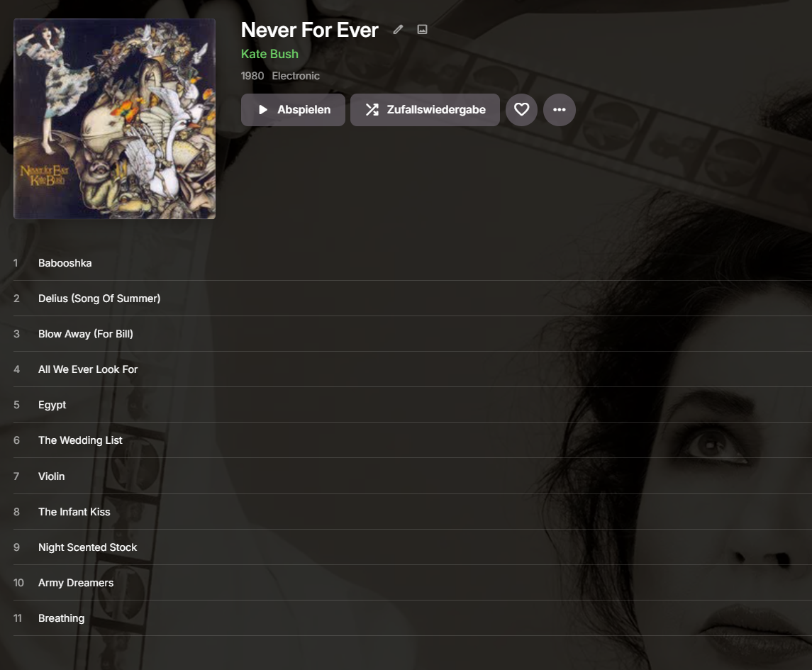

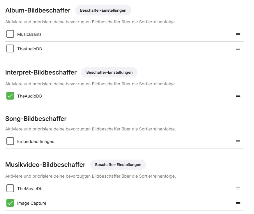

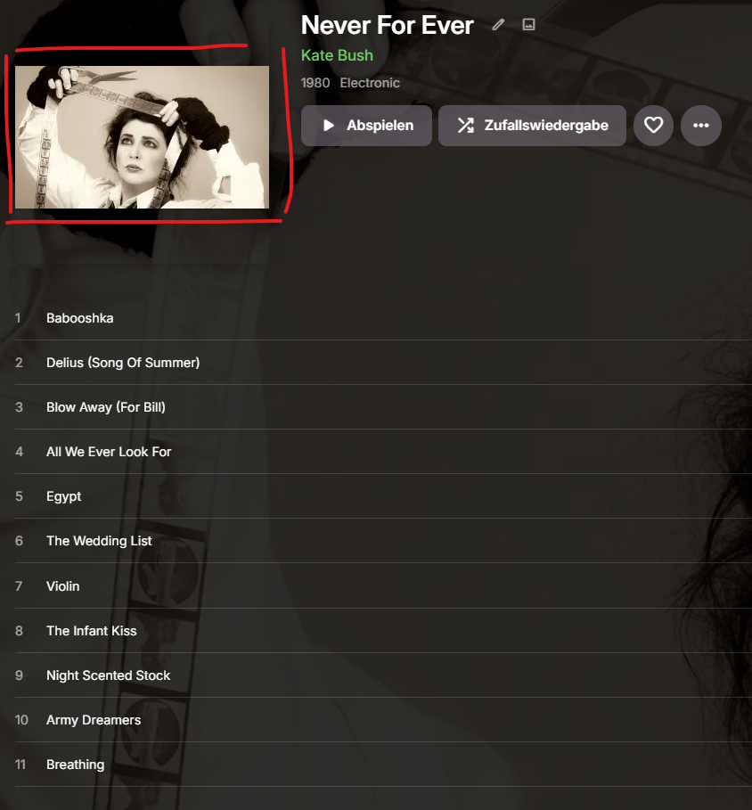

PeerNAS 2 Posted January 16, 2025 Author Posted January 16, 2025 Hallo zusammen. Tag 1 und alles lief bis jetzt bestens. Ich konnte sogar schon am TV das Layout von Emby bewundern. Ich finde, speziell bei den Musik-Dateien macht es mehr her, als Plex. Nur auf ein Problem bin ich gestoßen, was mich derzeit unzufrieden stellt. Wie kann ich bei dem Musikdateien die Tags, hier speziell die hinterlegten Cover, der einzelnen Dateien in die Bibliothek einbinden, damit mir das Cover angezeigt wird, anstatt die Bilder der Interpreten, die aus dem Netz kommen? Ich habe beim Erstellen der Bibliothek (fast) alle "Beschaffer" deaktiviert.
Neminem 1623 Posted January 16, 2025 Posted January 16, 2025 Try to enable this. And refresh metadata.
PeerNAS 2 Posted January 16, 2025 Author Posted January 16, 2025 Danke, Neminen. ich bin bis Freitag Abend unterwegs und kann nicht an mein NAS. Ich werde mich am Wochenende damit beschäftigen müssen. Wirkt sich das auch auf das Cover beim Album und der Wiedergabeliste(n) aus?
Neminem 1623 Posted January 16, 2025 Posted January 16, 2025 Hi @PeerNASstay safe on the road. I do believe it does, Emby takes images from embedded tags, and shows them.
PeerNAS 2 Posted January 16, 2025 Author Posted January 16, 2025 Ich bin erst am Samstag wieder am PC und kann es kontrollieren. Im Prinzip bin ich schon sehr zufrieden. Vielen Dank, Luke. 1
PeerNAS 2 Posted January 18, 2025 Author Posted January 18, 2025 Hallo zusammen. Ich habe den Scan nochmals durchlaufen lassen, nachdem ich Neminem Tipp zu Herzen genommen habe. Nach 4 Stunden war alles so, wie ich gern haben möchte. Vielen Dank nochmal an alle, die mir geholfen haben. Ich werde diesen einen Link zu diesen Thread eventuell in das Synology-Forum stellen, damit andere Unwissende anschlagen können. VG Peer 1

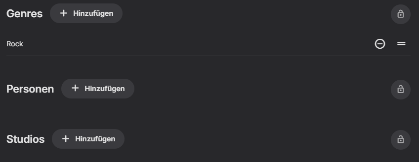

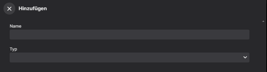

PeerNAS 2 Posted January 22, 2025 Author Posted January 22, 2025 In Grunde genommen sieht Emby vielversprechender aus, als Plex, wenn es um die Audiodateien geht. Drei Probleme würde ich trotzdem anbringen. Ich konnte Emby bis jetzt nicht für IPv6 zu laufen bringen. Ich habe mich zwar durch die Guidelines durchgelesen, konnte aber trotzdem keinen externen Zugriff auf Emby erzeugen. Ich habe einige Tags in den Datei, kann aber in den Einstellung von Emby keine weiteren hinzufügen (wie z.B. Producer, egal ob für Album oder Song). Das ausgewählte Tag wird nicht übernommen. Das Aktualisieren der Bibliothek dauert 4 Stunden, obwohl sich nur ein Eintrag geändert hat. Das geht bei Plex wesentlich schneller. Ansonsten macht Emby Spaß. VG Peer
Luke 42240 Posted February 6, 2025 Posted February 6, 2025 Quote I have some tags in the file, but I can't add any more in the Emby settings (such as Producer, regardless of whether it's for an album or song). The selected tag is not adopted. Hi @PeerNAScan you please provide a specific example? Thanks !
