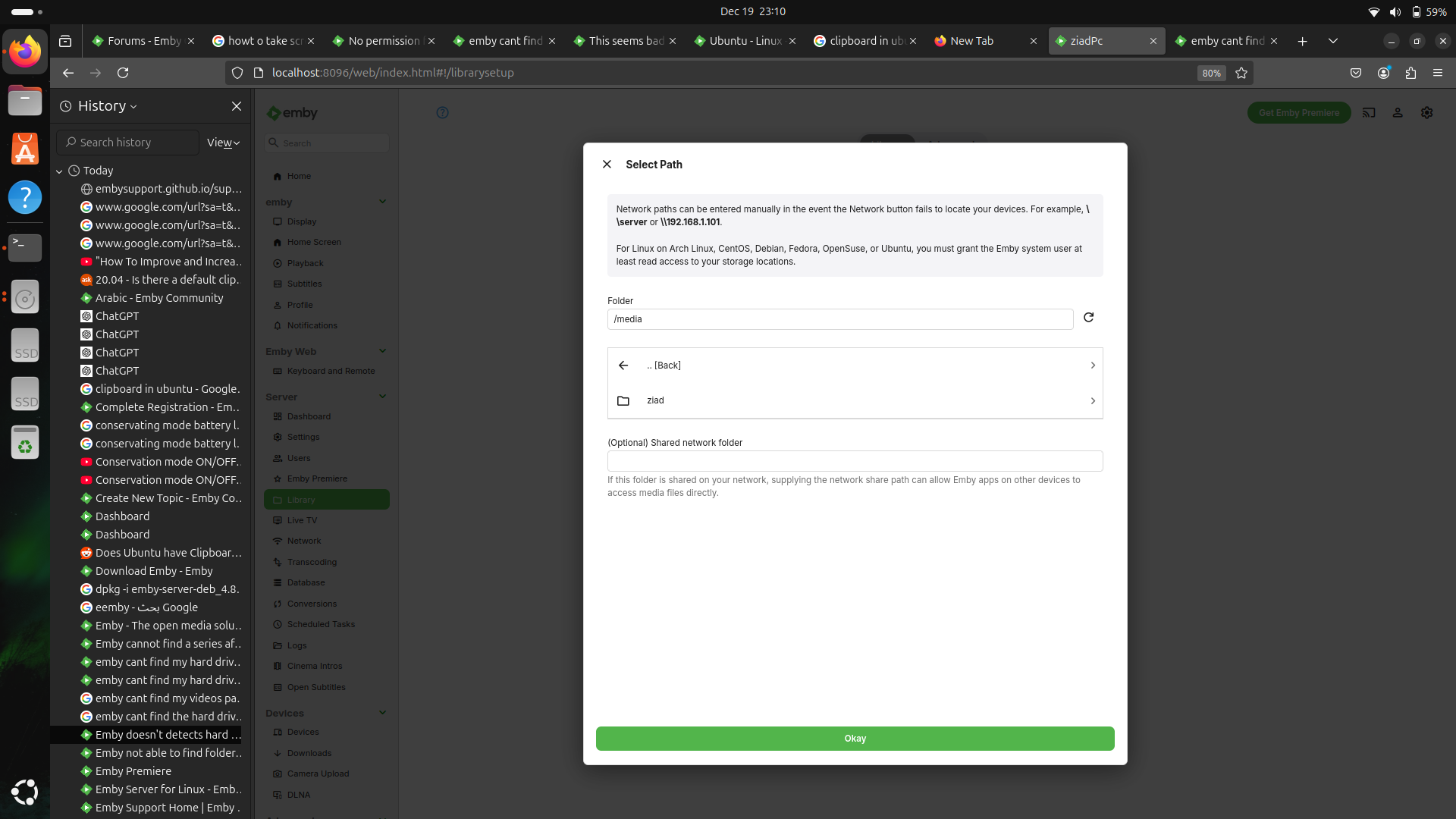

ziadmoataz 1 Posted December 19, 2024 Posted December 19, 2024 first time using linux i have ubuntu linux downloaded the desktop version and i have a internal harddrive of 1tb so i have my files on there the movies and stuff so i downloaded emby and went to add a library and went to the folder place and it looked like i saw only the ubuntu folder (aka the C drive on windows) it had stuff related to the os if im right so i dont know what to do i have the drive mounted and i dont know what to do

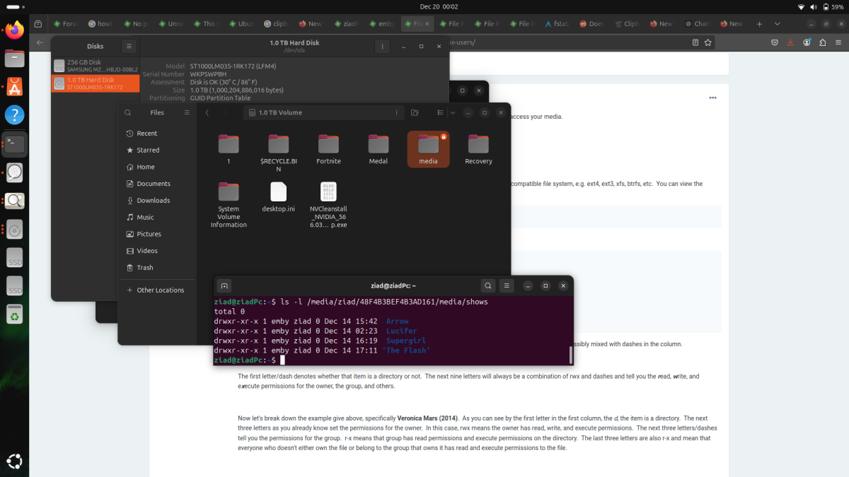

ziadmoataz 1 Posted December 19, 2024 Author Posted December 19, 2024 (edited) ii ran ths sudo chown -R emby /media/ziad/48F4B3BEF4B3AD161/media the numbers thing is my hard drive and media is the folder containing tv series folder after doin that i did ls -l /media/ziad/48F4B3BEF4B3AD161 and the result was total 567332 drwxr-xr-x 1 ziad ziad 0 Nov 6 04:36 '$RECYCLE.BIN' drwxr-xr-x 1 ziad ziad 4096 Nov 6 15:29 1 -rwxr-xr-x 1 ziad ziad 0 Nov 7 11:03 desktop.ini drwxr-xr-x 1 ziad ziad 0 Dec 19 13:50 Fortnite drwxr-xr-x 1 ziad ziad 0 Dec 11 19:04 Medal drwxr-xr-x 1 emby ziad 0 Dec 19 20:42 media -rwxr-xr-x 1 ziad ziad 580936445 Nov 6 03:49 NVCleanstall_NVIDIA_566.03_Setup.exe drwxr-xr-x 1 ziad ziad 0 Nov 7 11:03 Recovery drwxr-xr-x 1 ziad ziad 4096 Nov 15 01:16 'System Volume Information' and in emby when i go to /media/ziad/ and i try to double click on ziad it wont open idk if this will help i also tried chagpt and ran lots of commands there nothing helped but i dont have a history of commands i ran Edited December 19, 2024 by ziadmoataz

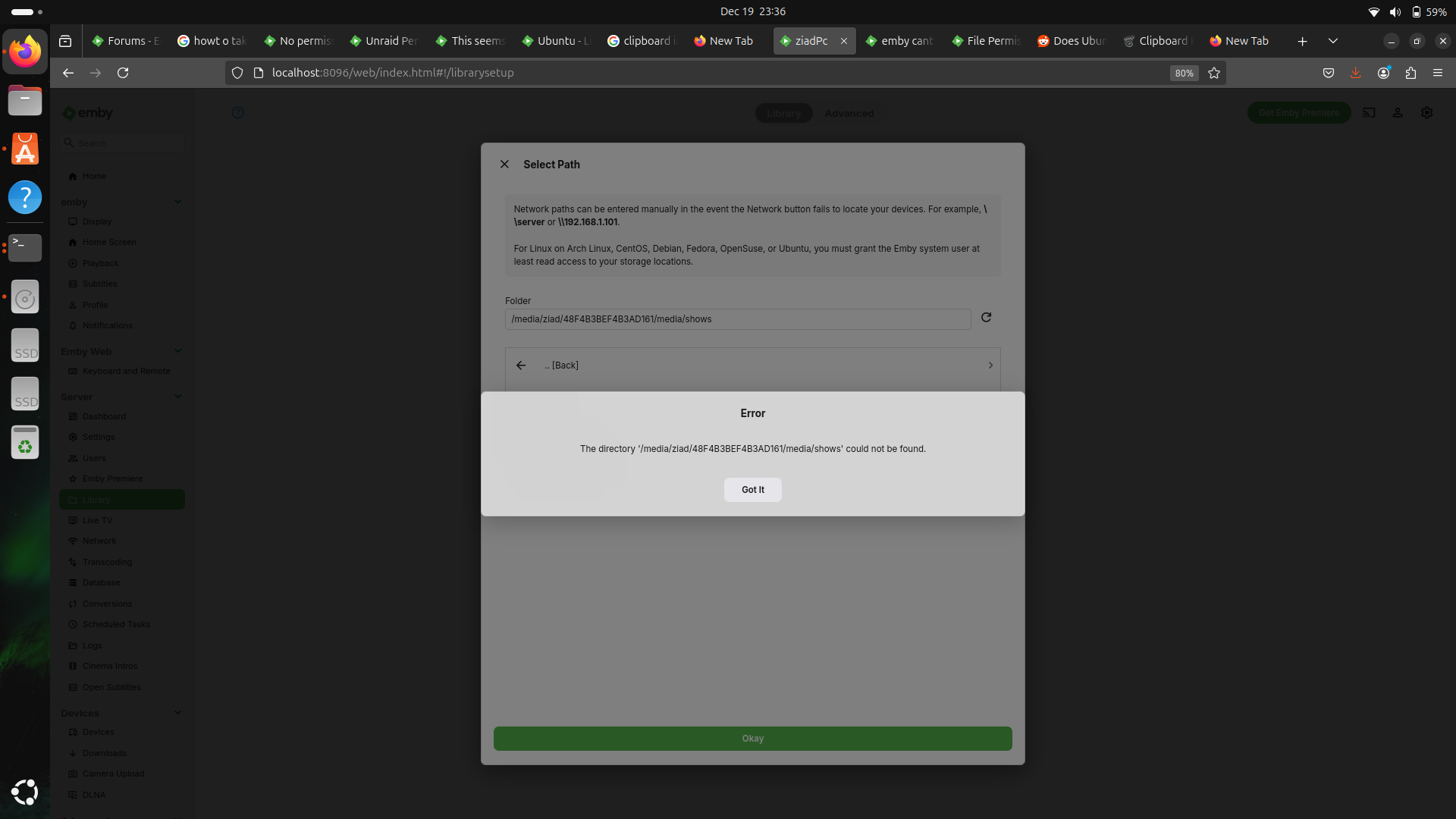

ziadmoataz 1 Posted December 19, 2024 Author Posted December 19, 2024 (edited) ill trying doing that and yes i tried putting the path manually it says Edited December 19, 2024 by ziadmoataz

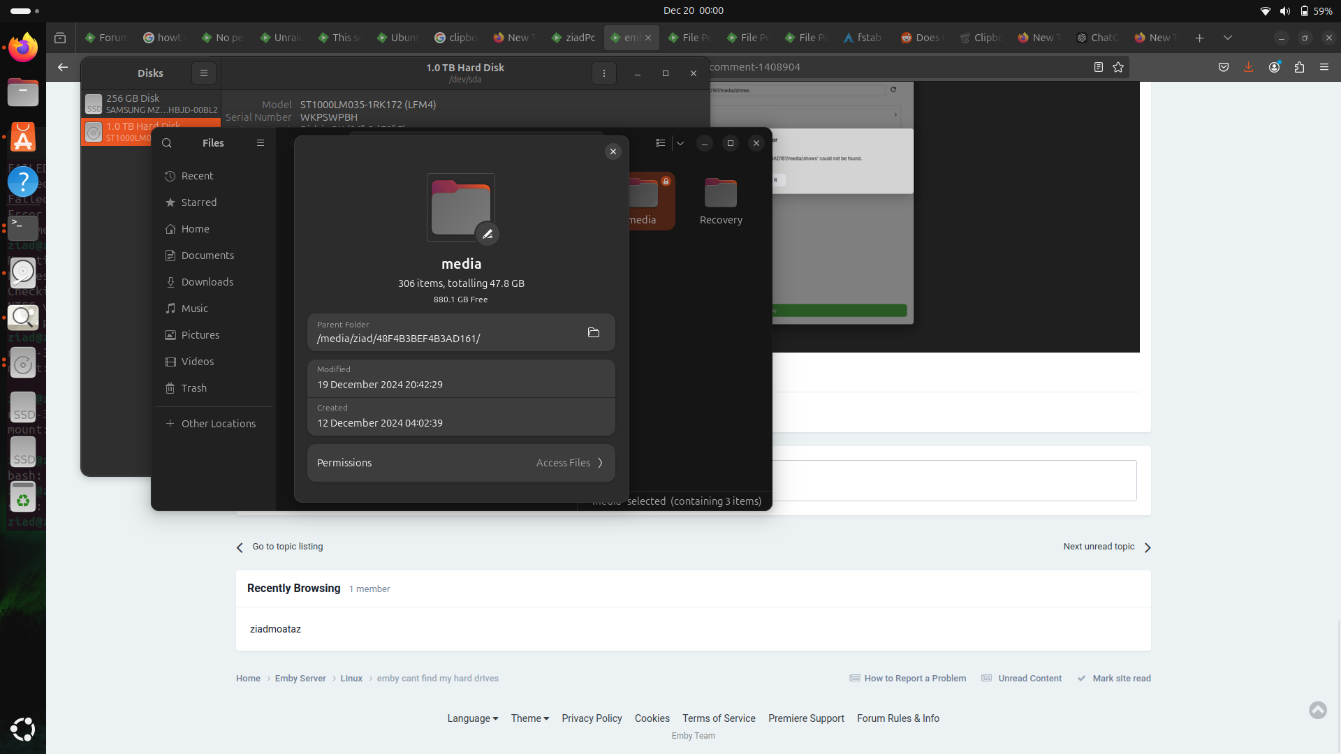

ziadmoataz 1 Posted December 19, 2024 Author Posted December 19, 2024 somehow media is the only folder with it having a lock symbol , i did the thing in the post u suggested it wasnt a solution but it was like if they have acces and im pretty sure they do from what i understood that emby has acces but in the post you mentioned to me the bottom partt about ntfs (thee 1tb im talking about is ntfs ii didnt understand what to do)

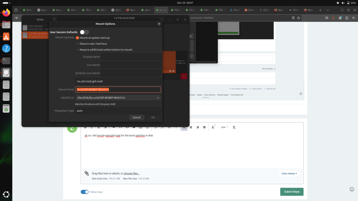

Solution ziadmoataz 1 Posted December 19, 2024 Author Solution Posted December 19, 2024 ok so i did rw,uid=ziad,gid=ziad for the boot optiotns in disk and it worked i could acces it but it would show on the side or in other locations in the files app its now in like the partition in where i installed ubuntu on its in a folder called mnt is there a way to have the hdd on the sidebar like before and work in the same time 1
