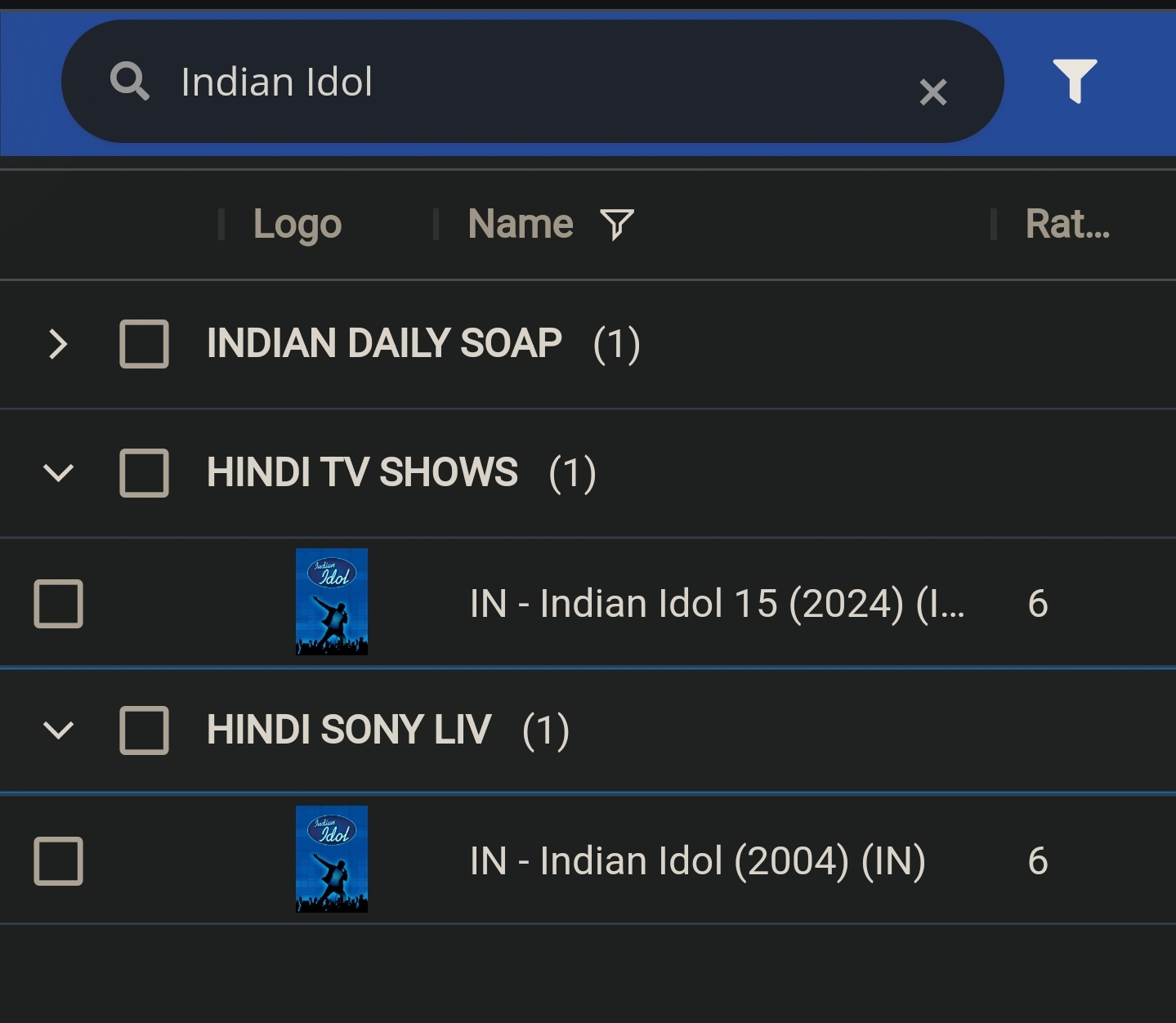

Azra3l 6 Posted December 20, 2024 Author Posted December 20, 2024 1 minute ago, Luke said: I would check and see if there are duplicate tvg-ids in the m3u. Yes. I did check for duplicates and am not seeing anything. The problem with using the original m3u URL is that it has 70k channels which I don't need. Is there any other way that I can reduce the channels list within emby? To make sure I can see only the channels I want to see?

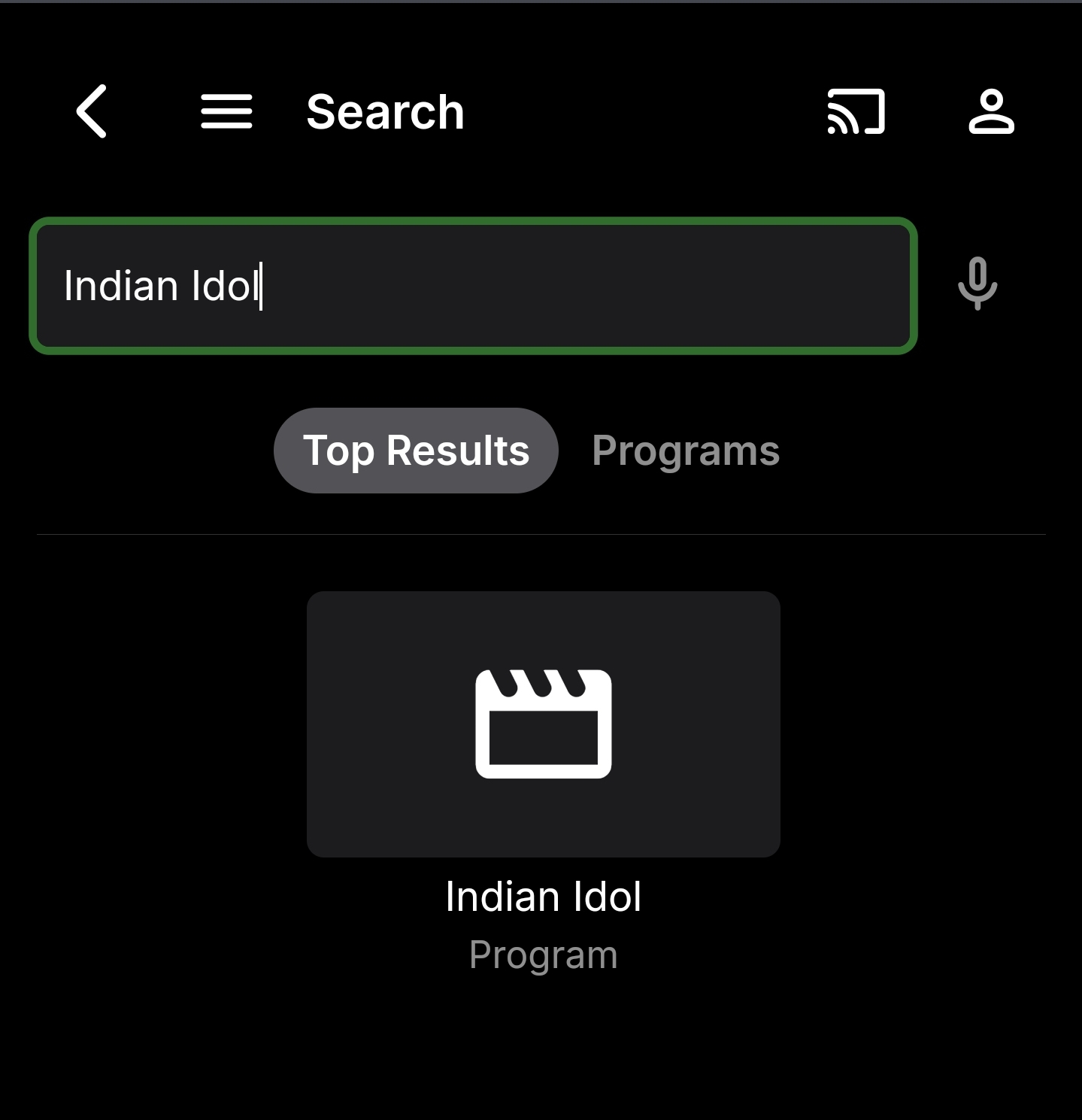

Azra3l 6 Posted December 20, 2024 Author Posted December 20, 2024 LOL, okay. Now am able to see the VOD Movies and not the VOD Shows.I didnt do anything different from the last time. 1
Azra3l 6 Posted December 20, 2024 Author Posted December 20, 2024 okay, so I tested out the same url from playlist editor into jellyfin and that shows all the selected channels. so, the issue is not the playlist editor side but rather on Emby.

Solution Carlo 4561 Posted December 20, 2024 Solution Posted December 20, 2024 15 hours ago, Azra3l said: Yes. I did check for duplicates and am not seeing anything. The problem with using the original m3u URL is that it has 70k channels which I don't need. Is there any other way that I can reduce the channels list within emby? To make sure I can see only the channels I want to see? I normally recommend using m3u4u.com to condense your TV Channe list to just the countries, groups and channels you wish to add. It also has bulk channel options you can use to do many things such as search/replace which is quite helpful if you want to remove "USA: " or "US: " from the beginning of channel names, etc In a nutshell it will process your m3u file daily pulling it from your provider making the changes and having it ready for you to use in Emby. m3u4u.com is free/donate. There is also iptveditor.com which some people prefer instead, but it costs a few bucks a year. If you would like, send me a PM (private message) with the info to pull your m3u and xml files. I'll set them up on a test machine to see what may be going on with the VOD content. My guess would be the provider changed something that Emby responded to when loading content. Anyway, I'd be happy to take a look at it for you. Carlo
