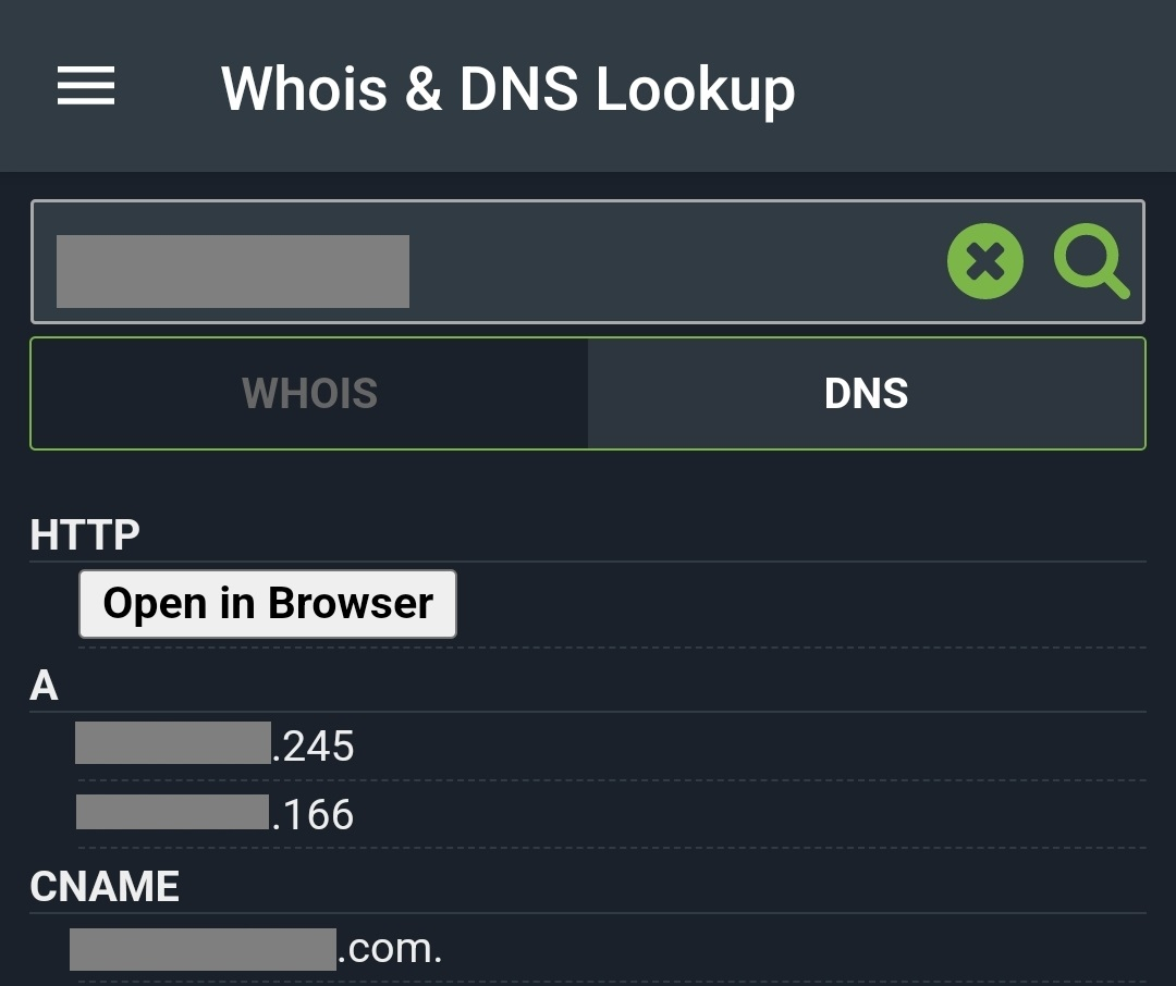

Solution darkassassin07 668 Posted December 19, 2024 Solution Posted December 19, 2024 (edited) It appears you have your domain pointed at two different IP addresses. You should make sure there is only one 'A' record, with your correct WAN IP. Edited December 19, 2024 by GrimReaper Domain names/IPs masked 3
Tbone1169 1 Posted December 19, 2024 Author Posted December 19, 2024 @darkassassin07 oh my god something so simple. I'm pretty sure this was it! Its now coming up, I must of not added that when I switched to porkbun. You guys are incredible I have a very basic understanding of this stuff but rest assured I am taking notes! 1
