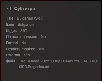

softworkz 5133 Posted December 20, 2024 Posted December 20, 2024 3 minutes ago, DimitarCC said: But here is how subs looks like Although i have set yellow subtitles and transparent background in the settings.... Which type of subtitles are those? Can you show the media info section?
DimitarCC 41 Posted December 20, 2024 Posted December 20, 2024 (edited) 6 minutes ago, softworkz said: Can you pleae make a photo of the remote control you have, then I'll buy one. I have 2 type of remotes and they are all the same broken Edited December 20, 2024 by DimitarCC
DimitarCC 41 Posted December 20, 2024 Posted December 20, 2024 (edited) That is the subs i use! Edited December 20, 2024 by DimitarCC

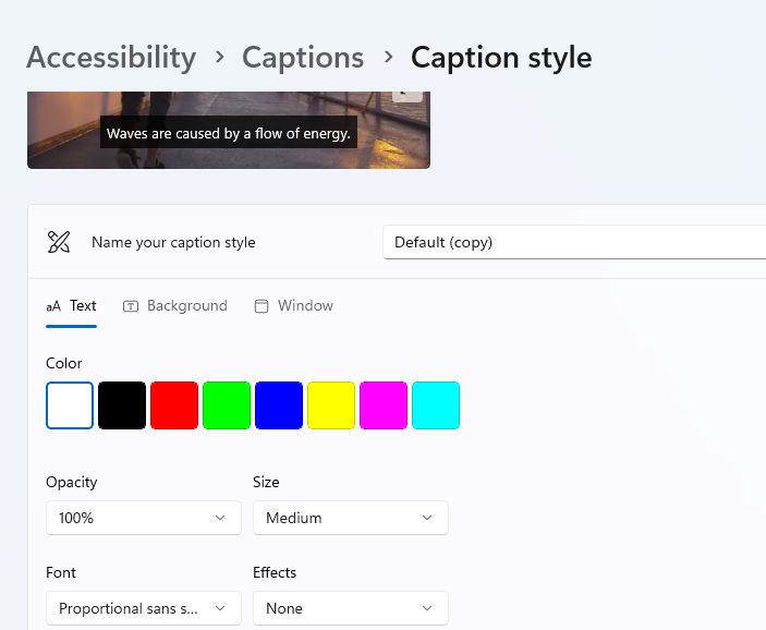

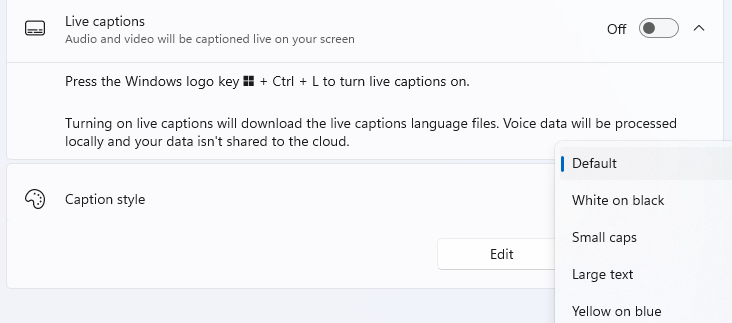

softworkz 5133 Posted December 20, 2024 Posted December 20, 2024 1 hour ago, DimitarCC said: 1 hour ago, softworkz said: Can you send me the (external) srt subtitle file via PM please? I have sent it... Thanks for the file. The size change is working fine on my side, and I also know why it's not working on your side: You have made changes to the system settings for subtitles (Settings >> Accessibilty >> Captioning). Windows versions (11, not 10, but surely applies to xboxes as well) since about 3 years are having a very ugly bug. They changed the settings in a way that you can no longer revert settings that you made under "Captioning", like it was possible in Win 10. And the second part of the ugliness: when you have made a change to the system settings, these are overriding the subtitle settings that the application makes. The application has no chance to override this on the Xbox, because it isn't able to make changes to the registry. I have reported this bug about a year ago, but unfortunately, there's a congestion of bug and the team too small - nothing has happened. Unfortunately, you have only these two options: Factory-reset the Xbox and never go to those Captioning settings again Make changes for subtitle appearance in the system settings But first of all, go to the captioning settings to verify that I'm right...

DimitarCC 41 Posted December 20, 2024 Posted December 20, 2024 (edited) 2 hours ago, softworkz said: Thanks for the file. The size change is working fine on my side, and I also know why it's not working on your side: You have made changes to the system settings for subtitles (Settings >> Accessibilty >> Captioning). Windows versions (11, not 10, but surely applies to xboxes as well) since about 3 years are having a very ugly bug. They changed the settings in a way that you can no longer revert settings that you made under "Captioning", like it was possible in Win 10. And the second part of the ugliness: when you have made a change to the system settings, these are overriding the subtitle settings that the application makes. The application has no chance to override this on the Xbox, because it isn't able to make changes to the registry. I have reported this bug about a year ago, but unfortunately, there's a congestion of bug and the team too small - nothing has happened. Unfortunately, you have only these two options: Factory-reset the Xbox and never go to those Captioning settings again Make changes for subtitle appearance in the system settings But first of all, go to the captioning settings to verify that I'm right... So its a funny thing.... So "Captioning" was off in Xbox settings..However subtitle didnt change. Then i went back to captioning and turn them on and off and sudently settings in Emby app start working... So now it is OK...Cool! Edited December 20, 2024 by DimitarCC

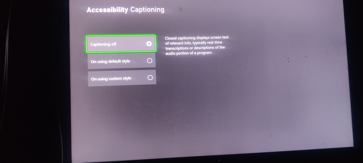

softworkz 5133 Posted December 20, 2024 Posted December 20, 2024 1 minute ago, DimitarCC said: . Then i went back to captioning and turn them on and off Oh, there's an "off" on Xbox? On Windows, there's no "off": There's always a "Default", which cannot be deleted: And the individual settings don't have a neutral value either: Can you show a photo of the Captioning settings on Xbox? I'm too afraid to even enter that menu
Clackdor 110 Posted December 20, 2024 Posted December 20, 2024 1 hour ago, softworkz said: Can you show a photo of the Captioning settings on Xbox? I'm too afraid to even enter that menu Here ya go @softworkz 1
softworkz 5133 Posted December 21, 2024 Posted December 21, 2024 1 hour ago, Clackdor said: 3 hours ago, softworkz said: Can you show a photo of the Captioning settings on Xbox? I'm too afraid to even enter that menu Here ya go @softworkz Great, thanks! So it appears that the Xbox handles this a bit differently. And, the settings logic is combined with automatic captioning. The good side is that it can be switched off. Now I also understand which @DimitarCChad to switch it on and off to get it working: The forced defaults that I've shown above have been rolled out as a registry change as part of a Windows update. And this has most likely hit the Xbox in the same way. It wasnt visible because the automatic captioning on/off is a different settng. But actively enabling and disabling caused the style values to be removed. This was Win10 behavior and early Win11 behavior and the Xbox does it the Win10 way. 1
