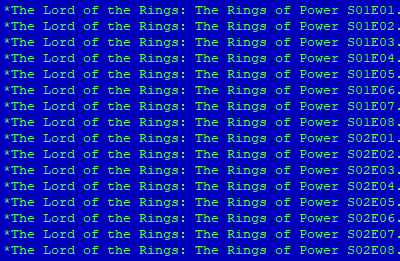

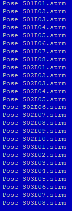

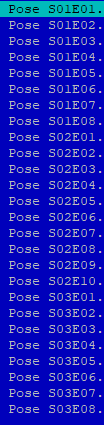

requa3r0 12 Posted December 15, 2024 Posted December 15, 2024 How do you select a tv-show and tell emby it has been index wrong. Its not clear or even possible An example. I have 2 tv-shows: 1: The Lord of the Rings: The Rings of Power - Season 1 - 8 Episodes 2: Pose - - Season 1 - 3 - 3 x 8 Episodes For some reason the tv-shows are mixed up in emby when I indexes the show folders, and its not clear how to untangle them. I can delete the full tv-show, or each episode, but not select a season and set it for the correct tv-show name etc. How can emby mix "pose" and " The Lord of the Rings: The Rings of Power" ?? Why is it so hard to interact with the library In emby. Its completely impossible to rectify this mistake! H have delete the files, and made a clean up. Both diapered. Then re-added the files, and re-indexed..just to get back to where I started. I don't really care about the show pose, and I could just delete it..but this is a good example of how impossible emby is to deal with sometimes. Here ...in the 3-dot menu on a season..no option to remove or re-set the show name. Running Emby server Version 4.8.10.0 on Debian 10

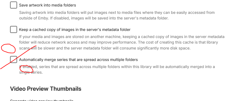

GrimReaper 4897 Posted December 15, 2024 Posted December 15, 2024 59 minutes ago, requa3r0 said: The problem her is not only that emby mixes "pose" up with "The Lord of the Rings - The Rings of Power" It likely mixes them due to naming convention used, hence: 3 hours ago, Neminem said: its all about not following TV Naming As for: 1 hour ago, requa3r0 said: but rather that you cant do anything about it from emby. Why is there not a way to fix the issue from the emby interface. At least to remove the wrong seasons, but even better to select the correct show. You can approach that in two ways: 1) Deselect "Automatically merge series spread across multiple folders" library option - you'll have two entries for the same show, right click>Identify incorrectly identified one 2) On each episode detail screen click "Split versions apart" - you'll end up in same scenario as 1), just way slower
requa3r0 12 Posted December 15, 2024 Author Posted December 15, 2024 hmm...sounds like plan. ill give that a go -remove pose...and selected a vacuum on next startup..and restarted. When my rsync script runs tonight..ill know tomorrow

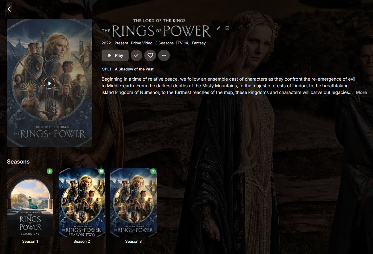

requa3r0 12 Posted December 22, 2024 Author Posted December 22, 2024 @Luke no. Reverted the setting deleted POSE in my rsync script rm -d -r Series\ Other/Pose The Lord of the Rings: The Rings of Power did not scan..so i did an edit and set the manually TheTVDB ID = 367506 That helped 1
