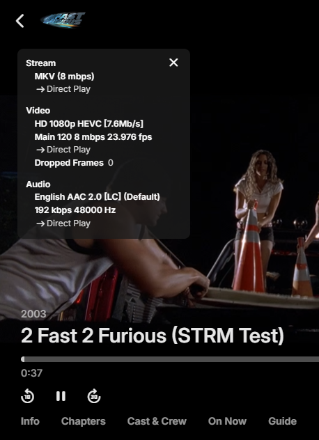

robert powell 8 Posted December 21, 2024 Posted December 21, 2024 On 12/15/2024 at 7:23 AM, rbjtech said: strm files work with all apps as far as I am aware. i have made a couple .strm files so i can have a video in two locations without wasting the space of having two copies of the movie. that way i can take a movie that's also a "special episode" of a tv show and have it show up in the tv series and in movies. it shows up in both libraries just fine, but when you try to play the one that's an .strm file after a minute of trying to load it just pops up an error saying unable to find a compatible stream. it does this on my smart tv (Samsung) , web browser, on the pc and on the Emby android app. not sure why ... it used to work when i original made the strms about 4 years ago. i just noticed it no longer works, as after reading this thread i got curious and went to try and play them back
rbjtech 5344 Posted December 21, 2024 Posted December 21, 2024 10 hours ago, robert powell said: i have made a couple .strm files so i can have a video in two locations without wasting the space of having two copies of the movie. that way i can take a movie that's also a "special episode" of a tv show and have it show up in the tv series and in movies. it shows up in both libraries just fine, but when you try to play the one that's an .strm file after a minute of trying to load it just pops up an error saying unable to find a compatible stream. it does this on my smart tv (Samsung) , web browser, on the pc and on the Emby android app. not sure why ... it used to work when i original made the strms about 4 years ago. i just noticed it no longer works, as after reading this thread i got curious and went to try and play them back Just tested - I don't appear to have any issues (latest Server beta + Edge Browser) - it's direct playing just fine ? make sure the URL in the STRM itself does not contain quotes - ie \\MEDIA\TestLibrary\Films\2 Fast 2 Furious (2003) [tmdbId=584]\2 Fast 2 Furious (2003) - WEBDL-1080p STRM.strm \\MEDIA\Films\2 Fast 2 Furious (2003) [tmdbId=584]\2 Fast 2 Furious (2003) - WEBDL-1080p.mkv
Barronli 4 Posted December 21, 2024 Author Posted December 21, 2024 FWIW The path to the media file in the strm file has to be a full absolute path starting from the root.

robert powell 8 Posted January 14, 2025 Posted January 14, 2025 I forgot report back .... shortly after i made my post I had a brain fart. a while back i got some new drives and rearranged some files, and drive letter assignments changed. i guess when that happens, the file location in the strm file just tends not to work any more. once i addressed that issue every thing worked fine on all platforms 1
