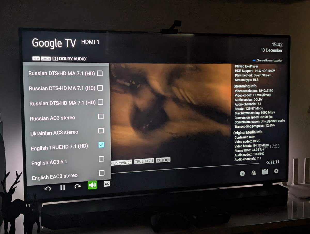

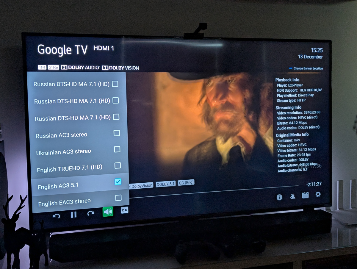

kelstar 1 Posted December 13, 2024 Posted December 13, 2024 I really like Emby and it has a really cool feature in the options to convert unsupported audio to dolby audio (instead of downmixing to stereo). It matters a lot to me, since some media files have truehd or dts codec which is unsopported by my tv and i want them to be transcoded to dolby, not stereo. But the problem is that when I switch to the unsupported audio track - the audio is converted and played as Dolby yes, but the picture becomes SDR. In the stats it is still displayed as being directly played but the info in the TV itself shows that the picture mode is not Dolby Vision and not even HDR. First screenshot is when the video is played with supported audio track and you can see that video is in DV format. Second screenshot is when I switch to unsupported (trueHD). Conversion happens so the audio is Dolby still, but the video lacks DV format and by all picture settings it's just SDR Spoiler

ebr 16336 Posted December 16, 2024 Posted December 16, 2024 Hi. Once we have to change it to stream via HLS, DV is no longer supported. Can you try searching for our standard android app (Just "Emby" on Amazon and "Emby for Android on Google) on the same device's app store and see how that compares? Thanks.
kelstar 1 Posted December 16, 2024 Author Posted December 16, 2024 1 hour ago, ebr said: Hi. Once we have to change it to stream via HLS, DV is no longer supported. Can you try searching for our standard android app (Just "Emby" on Amazon and "Emby for Android on Google) on the same device's app store and see how that compares? Thanks. Oh, I thought it has something to do with the type of stream, because that's the only thing that differs, http vs hls stream. Will that be fixed (in any verion of the app)? Because technically it's possible, Plex can transcode sound to ac2 while sending DV to my device. Standart Android app doesn't have th ability to convert unsupported audio to doly, so I can't compare them, since the feature is not present.
