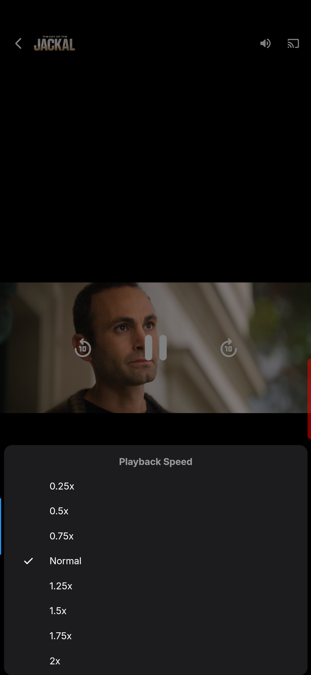

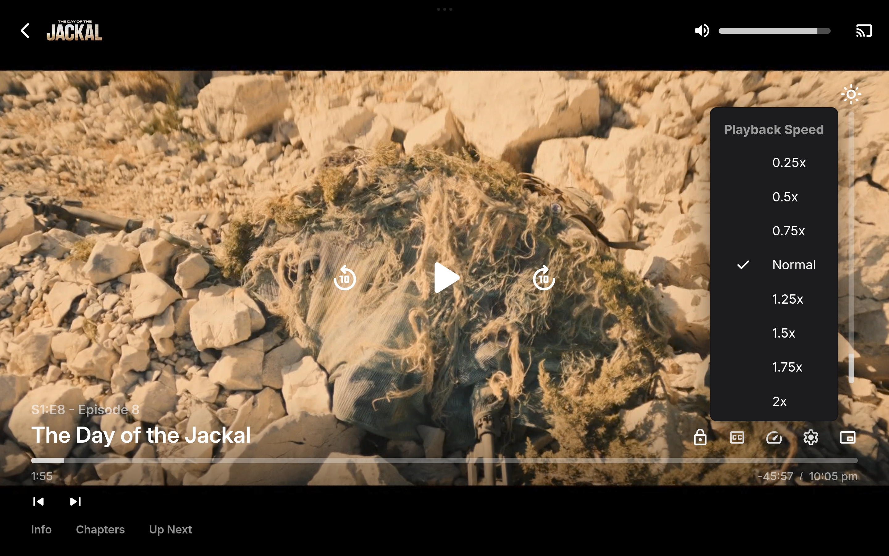

Gryzor 27 Posted December 12, 2024 Posted December 12, 2024 So, on my tablet flyout menus like the speed adjustment menus appear like this: Perfectly acceptable and usable. Then on my phone I get this: What gives? Is there a way to adopt the tablet menus on a phone? Can you adjust it so it doesn't take up almost the entire screen?
Luke 42244 Posted December 12, 2024 Posted December 12, 2024 Hi, we’ll look at improving it but on smaller screens yes generally they go near full screen
Gryzor 27 Posted December 12, 2024 Author Posted December 12, 2024 Crossing fingers. A small one like the tablet fly out, even with some transparency, would be really better instead of hiding the entire playback area...

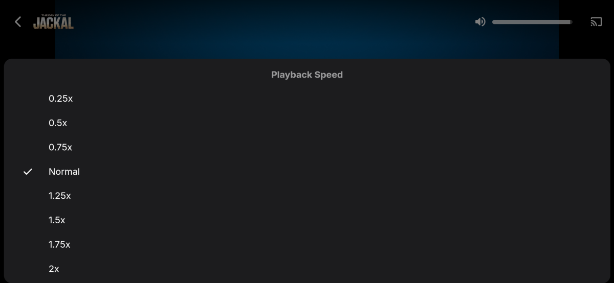

Luke 42244 Posted December 12, 2024 Posted December 12, 2024 Does it also happen with the device in portrait?
Luke 42244 Posted December 12, 2024 Posted December 12, 2024 And by the way is that the web app or our android app?
Gryzor 27 Posted December 12, 2024 Author Posted December 12, 2024 (edited) The Android app (on latest beta). Here's portrait mode. Edited December 12, 2024 by Gryzor

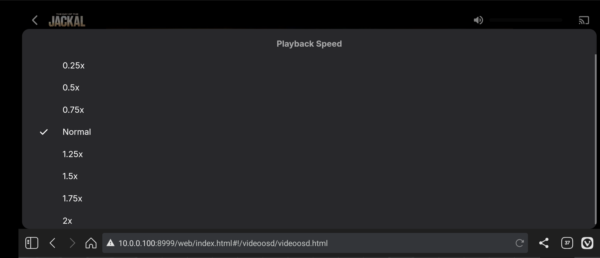

Luke 42244 Posted December 12, 2024 Posted December 12, 2024 How does the web app compare in full screen mode?
Gryzor 27 Posted December 12, 2024 Author Posted December 12, 2024 My pleasure. Anything else, glad to help. (Btw previous screenshot was not full screen, but it's the exact same when in full screen, too) 1

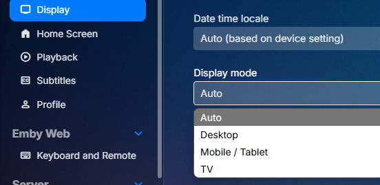

Happy2Play 9812 Posted February 14, 2025 Posted February 14, 2025 3 minutes ago, Gryzor said: Any way to force it to think it's a tablet? Well they are the same but have you looked at display mode? But yes the differences you see will come back to Resolution as similar can be reproduce in web client. As display height triggers change. Have not found the exact css yet but haven't looked to much either.
Gryzor 27 Posted February 14, 2025 Author Posted February 14, 2025 Yup, I've played with this option, it doesn't make any difference (and, mobile and tablet being bundled as one option I wasn't expecting much!). It's such a small thing, but it's driving me crazy
