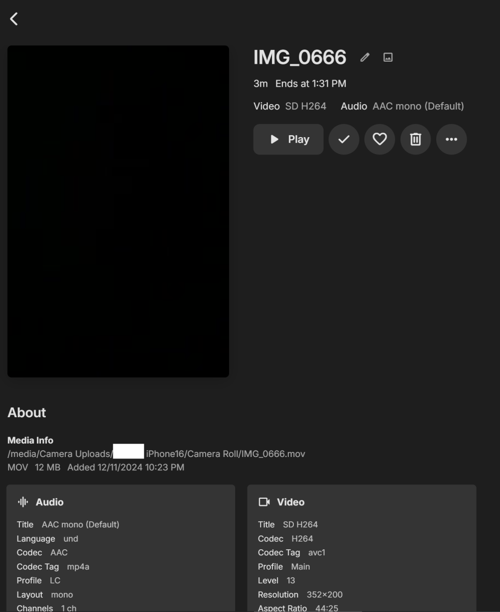

tillithz 1 Posted April 11, 2025 Author Posted April 11, 2025 Hi Carlo, I havent figured it all out, thank you for checking. For Emby showing 136GB of storage used on the iPhone.... the iPhone has say 150GB of storage used (estimate) and 136GB is Emby. Im lost as how Emby has so much more in pictures over what is on the phone from say the camera app. For The library advance settings for "Date added behavior for new content" is set to use file creation date.... I had tested the install a number of times before and then began uploading camera pics and videos only to see they were not in order of creation date. Since those tests I reinstalled Emby on the server and configured a fresh install. I just recently changed it from date uploaded to creation date, so I will see how this version of install reports. Example of There are many videos and photos that dont have a thumbnail and when opening does not show the content.....would be (attached). While there are far less files like this, it may just be processing time because of the large amount of photos and videos. Thank you for responding and I have not added comments to a couple of the points/questions above only because I can no longer verify the same issue since uploaded file count would be very different today and theres no way to apply a control to the results and interpret accurately.

sa2000 696 Posted April 29, 2025 Posted April 29, 2025 @tillithzgoing the list of issues you mention: 1. Storage use of 136 Gb by Emby for iOS app. I have not come across this for camera upload use. Some questions: - did you ever use the downloads feature to download media on that iPhone through Emby? - what shows under Downloads? - Do you know if this happens on any other mobile device ? any other user ? or are you still just trying it out with this non-admin user accoujnt? 2. Library Advanced Setting - using "Created Date". I will look into this and if you can get me an actual example of a photo having a creation added and is then showing as date added in emby, then please zip and send me the photo by private message,. In the mean time I will look into the current behavior 3. Image thumbnails We do currently have issues with genetating thumbnails from videos - often timing out. This has been fixed in the beta for linux platforms and other platforms will follow. If you have evidence of it happening for a photo - please let me have example with debug server log covering time the photo was added to the library and attempt to create a thumbnail
