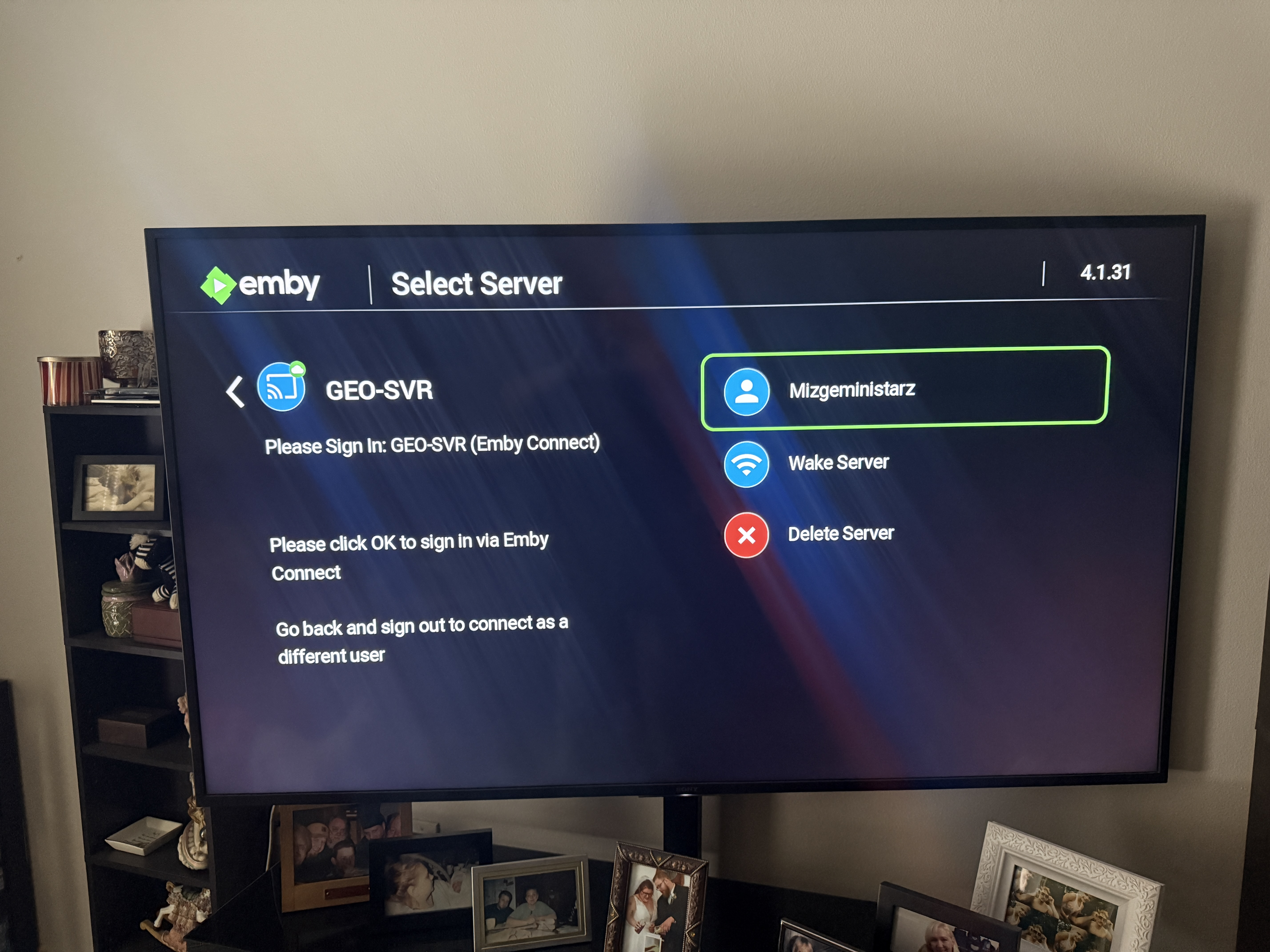

Mizgeministarz 0 Posted December 14, 2024 Posted December 14, 2024 On 12/13/2024 at 9:26 AM, ebr said: Hi. Your Roku should have updated last night. Please make sure you have 4.1.31 of the app. This update did not resolve the issue for me. I am still unable to sign out (button is unresponsive), and when I select my username to log in, the screen spins indefinitely. I have uninstalled the app, reinstalled, connected via pin (which results in the app force closing), re-opened the app and am brought to the screen in the photo. I select my username and the spinning goes on indefinitely. When I try to back out from the spinning screen, the app is unresponsive. When I click on the home button for the Roku, and enter the app again, I am brought back to the screen in my photo. If I hit back from here and select SIGN OUT, nothing happens. The button is unresponsive.
speechles 2062 Posted December 14, 2024 Posted December 14, 2024 @MizgeministarzThank you for your continued help in finding the cause of this bug. This is a soft-crash happening in the application when the spinner just goes endlessly. This is why you need to press the home button to exit the app. Also why the back button brings you to an unresponsive screen. First off. It appears by that screen you are using Emby Connect. Is this your own server on your local LAN or is this someone elses server? The reason I ask is because I am trying to replicate your conditions exactly and see if I can encounter the same bug. We might also ask if you could perhaps add us temporarily to your server with the same Emby Connect method so we can experience the bug that way. Would you be up to allowing us temporary access to your server to replicate the issue?
Mizgeministarz 0 Posted December 14, 2024 Posted December 14, 2024 Unfortunately this is my brother’s server, so I would be unable to grant those permissions. The app worked perfectly fine before the last 2 updates (one of which being last night). He just moved his server off Plex to Emby because it was supposed to work better, but that’s not been my experience thus far. Sorry I can’t help more by providing a live troubleshooting environment. It would be appreciated if you could find the issue so we can continue to use Emby.
ebr 16332 Posted December 15, 2024 Posted December 15, 2024 11 hours ago, Mizgeministarz said: This update did not resolve the issue for me Hi. This is not the same issue the OP reported. What happens if you don't use Emby Connect and, instead, connect directly using the WAN address?
