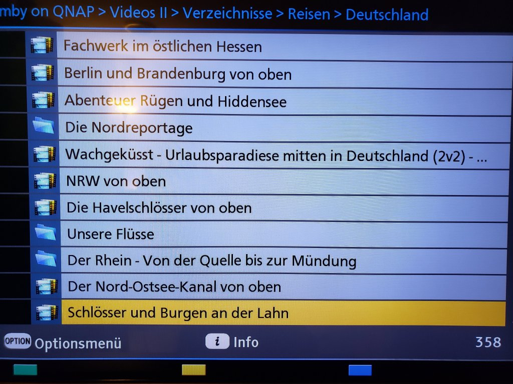

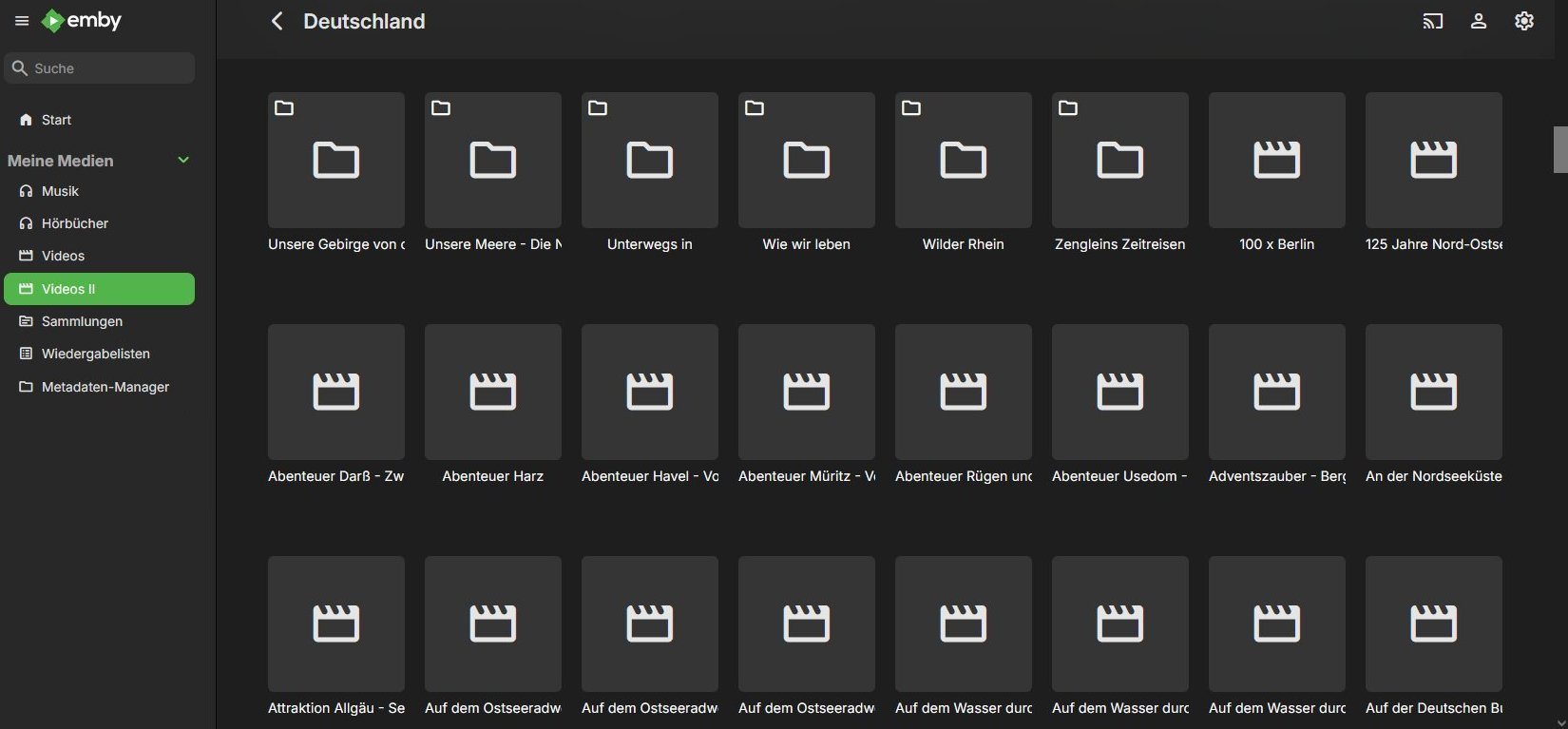

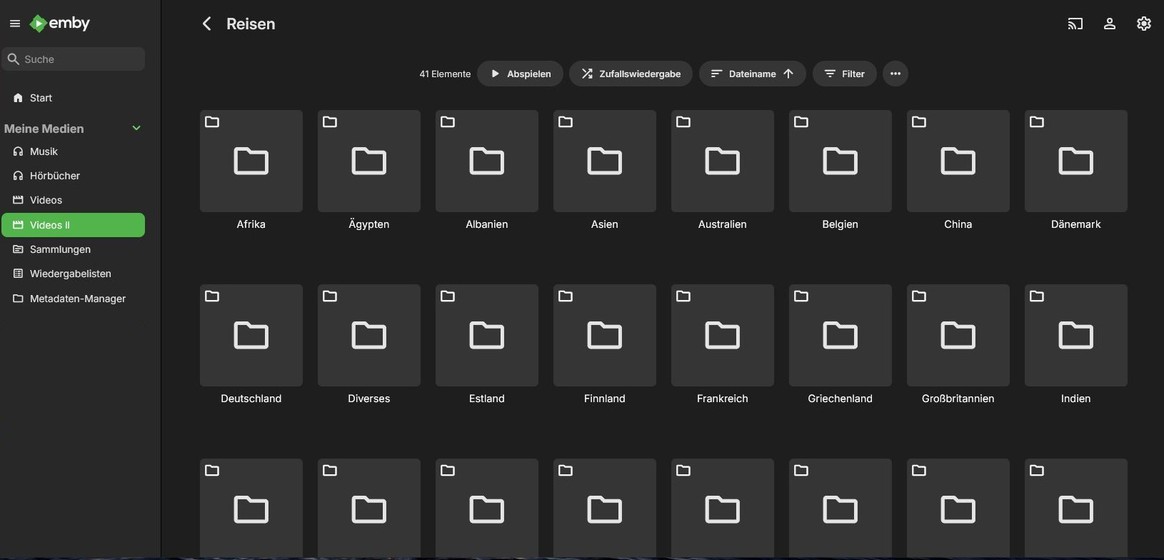

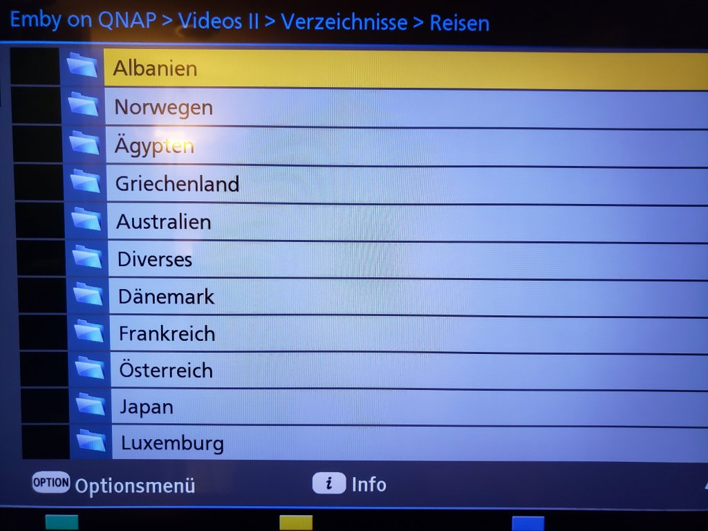

malte75 0 Posted December 15, 2024 Author Posted December 15, 2024 (edited) On all other devices (e.g. VLC Player) the sorting is "directories first, files second, all in alphabetic oder" - the same as on the Emby Web-App (first tow pictures). On the Panasonic TV the order of the same directory is messed up (pictures #3 and #4) - I can't understand the order of the directories and files, they are absolutely mixed up. It would be nice to have the same sorting order ("directories first, files second, all in alphabetic order") on my Panasonic DLNA Client. As I mentioned above: Using Twonky Server I had the same problem - there I had to add the flag "ignoresort" to the DLNA profile for Panasonic TV's, after that the order on the Panasonic DLNA Client was as expected. I don't know if the Panasonic DLNA Client re-sorts the DLNA information in some way (maybe by date of file creation, although the output doesn't seem to confirm this) - or if the output corresponds to the sorting order, in which the Panasonic DLNA Clients receives the information from the Emby Server (and only other clients like the VLC Player re-sort the information). Knowing the same problem with the Twonky Server and its solution (adding the "flag"), I thought that it is the Panasonic DLNA Client that messes the sorting order up and has to been stopped by adding the "flag" - but maybe that's not really the case. Is there any way to force the Emby Server to send the DLNA information in a certain sorting order? Or do you think this is a problem of the DLNA Client of the Panasonic TV? Thanks a lot for your help! Edited December 15, 2024 by malte75
