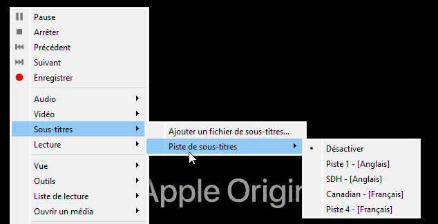

nodiaque 62 Posted December 9, 2024 Author Posted December 9, 2024 That'S weird, I only have 4 subtitles track:
nodiaque 62 Posted December 9, 2024 Author Posted December 9, 2024 (edited) could it be that the metadate doesn't match the file? I do have a program that scan all my files and remove subtitles (and other track) that I don't want. I think maybe what's happening is it doesn't match the real file behind? The filename isn't change when only subs are modded Edited December 9, 2024 by nodiaque
Happy2Play 9811 Posted December 9, 2024 Posted December 9, 2024 4 minutes ago, nodiaque said: could it be that the metadate doesn't match the file? I do have a program that scan all my files and remove subtitles (and other track) that I don't want. I think maybe what's happening is it doesn't match the real file behind? The filename isn't change when only subs are modded Possibly Emby has not seen that update and could explain the somewhat crash/exit as fileinfo shows index 0-43 for subs but can not list them. Spoiler {"Protocol":"File","Id":"c6262c76bc611c6cfb32655ed4d1f589","Path":"/mnt/user/TV/Silo (2023) [tvdbid-403245]/Season 01/S01E09 - The Getaway [ATVP WEBDL-2160p][DV HDR10Plus][EAC3 Atmos 5.1][HEVC]-HONE.mkv","Type":"Default","Container":"mkv","Size":8366325050,"Name":"S01E09 - The Getaway [ATVP WEBDL-2160p][DV HDR10Plus][EAC3 Atmos 5.1][HEVC]-HONE","IsRemote":false,"HasMixedProtocols":false,"RunTimeTicks":26316480000,"SupportsTranscoding":true,"SupportsDirectStream":true,"SupportsDirectPlay":true,"IsInfiniteStream":false,"RequiresOpening":false,"RequiresClosing":false,"RequiresLooping":false,"SupportsProbing":false,"MediaStreams":[{"Codec":"hevc","Language":"eng","ColorTransfer":"smpte2084","ColorPrimaries":"bt2020","ColorSpace":"bt2020nc","TimeBase":"1/1000","VideoRange":"DolbyVision","DisplayTitle":"4K Dolby Vision HEVC","DisplayLanguage":"English","IsInterlaced":false,"BitRate":25432960,"BitDepth":10,"RefFrames":1,"IsDefault":true,"IsForced":false,"IsHearingImpaired":false,"Height":1920,"Width":3840,"AverageFrameRate":23.976025,"RealFrameRate":23.976025,"Profile":"Main 10","Type":"Video","AspectRatio":"2:1","Index":0,"IsExternal":false,"IsTextSubtitleStream":false,"SupportsExternalStream":false,"Protocol":"File","PixelFormat":"yuv420p10le","Level":150,"IsAnamorphic":false,"ExtendedVideoType":"DolbyVision","ExtendedVideoSubType":"DoviProfile81","ExtendedVideoSubTypeDescription":"Profile 8.1 (HDR10 compatible)","AttachmentSize":0},{"Codec":"eac3","Language":"eng","TimeBase":"1/1000","DisplayTitle":"English EAC3 5.1 (Default)","DisplayLanguage":"English","IsInterlaced":false,"ChannelLayout":"5.1","BitRate":768000,"Channels":6,"SampleRate":48000,"IsDefault":true,"IsForced":false,"IsHearingImpaired":false,"Type":"Audio","Index":1,"IsExternal":false,"IsTextSubtitleStream":false,"SupportsExternalStream":false,"Protocol":"File","ExtendedVideoType":"None","ExtendedVideoSubType":"None","ExtendedVideoSubTypeDescription":"None","AttachmentSize":0},{"Codec":"subrip","Language":"eng","TimeBase":"1/1000","DisplayTitle":"English (SUBRIP)","DisplayLanguage":"English","IsInterlaced":false,"IsDefault":false,"IsForced":false,"IsHearingImpaired":false,"Type":"Subtitle","Index":2,"IsExternal":false,"IsTextSubtitleStream":true,"SupportsExternalStream":true,"Protocol":"File","ExtendedVideoType":"None","ExtendedVideoSubType":"None","ExtendedVideoSubTypeDescription":"None","AttachmentSize":0,"SubtitleLocationType":"InternalStream"},{"Codec":"subrip","Language":"eng","TimeBase":"1/1000","Title":"SDH","DisplayTitle":"English (SDH SUBRIP)","DisplayLanguage":"English","IsInterlaced":false,"IsDefault":false,"IsForced":false,"IsHearingImpaired":true,"Type":"Subtitle","Index":3,"IsExternal":false,"IsTextSubtitleStream":true,"SupportsExternalStream":true,"Protocol":"File","ExtendedVideoType":"None","ExtendedVideoSubType":"None","ExtendedVideoSubTypeDescription":"None","AttachmentSize":0,"SubtitleLocationType":"InternalStream"},{"Codec":"subrip","Language":"ara","TimeBase":"1/1000","DisplayTitle":"Arabic (SUBRIP)","DisplayLanguage":"Arabic","IsInterlaced":false,"IsDefault":false,"IsForced":false,"IsHearingImpaired":false,"Type":"Subtitle","Index":4,"IsExternal":false,"IsTextSubtitleStream":true,"SupportsExternalStream":true,"Protocol":"File","ExtendedVideoType":"None","ExtendedVideoSubType":"None","ExtendedVideoSubTypeDescription":"None","AttachmentSize":0,"SubtitleLocationType":"InternalStream"},{"Codec":"subrip","Language":"bul","TimeBase":"1/1000","DisplayTitle":"Bulgarian (SUBRIP)","DisplayLanguage":"Bulgarian","IsInterlaced":false,"IsDefault":false,"IsForced":false,"IsHearingImpaired":false,"Type":"Subtitle","Index":5,"IsExternal":false,"IsTextSubtitleStream":true,"SupportsExternalStream":true,"Protocol":"File","ExtendedVideoType":"None","ExtendedVideoSubType":"None","ExtendedVideoSubTypeDescription":"None","AttachmentSize":0,"SubtitleLocationType":"InternalStream"},{"Codec":"subrip","Language":"chi","TimeBase":"1/1000","Title":"Simplified","DisplayTitle":"Chinese Simplified (SUBRIP)","DisplayLanguage":"Chinese Simplified","IsInterlaced":false,"IsDefault":false,"IsForced":false,"IsHearingImpaired":false,"Type":"Subtitle","Index":6,"IsExternal":false,"IsTextSubtitleStream":true,"SupportsExternalStream":true,"Protocol":"File","ExtendedVideoType":"None","ExtendedVideoSubType":"None","ExtendedVideoSubTypeDescription":"None","AttachmentSize":0,"SubtitleLocationType":"InternalStream"},{"Codec":"subrip","Language":"chi","TimeBase":"1/1000","Title":"Traditional","DisplayTitle":"Chinese Traditional (SUBRIP)","DisplayLanguage":"Chinese Traditional","IsInterlaced":false,"IsDefault":false,"IsForced":false,"IsHearingImpaired":false,"Type":"Subtitle","Index":7,"IsExternal":false,"IsTextSubtitleStream":true,"SupportsExternalStream":true,"Protocol":"File","ExtendedVideoType":"None","ExtendedVideoSubType":"None","ExtendedVideoSubTypeDescription":"None","AttachmentSize":0,"SubtitleLocationType":"InternalStream"},{"Codec":"subrip","Language":"cze","TimeBase":"1/1000","DisplayTitle":"Czech (SUBRIP)","DisplayLanguage":"Czech","IsInterlaced":false,"IsDefault":false,"IsForced":false,"IsHearingImpaired":false,"Type":"Subtitle","Index":8,"IsExternal":false,"IsTextSubtitleStream":true,"SupportsExternalStream":true,"Protocol":"File","ExtendedVideoType":"None","ExtendedVideoSubType":"None","ExtendedVideoSubTypeDescription":"None","AttachmentSize":0,"SubtitleLocationType":"InternalStream"},{"Codec":"subrip","Language":"dan","TimeBase":"1/1000","DisplayTitle":"Danish (SUBRIP)","DisplayLanguage":"Danish","IsInterlaced":false,"IsDefault":false,"IsForced":false,"IsHearingImpaired":false,"Type":"Subtitle","Index":9,"IsExternal":false,"IsTextSubtitleStream":true,"SupportsExternalStream":true,"Protocol":"File","ExtendedVideoType":"None","ExtendedVideoSubType":"None","ExtendedVideoSubTypeDescription":"None","AttachmentSize":0,"SubtitleLocationType":"InternalStream"},{"Codec":"subrip","Language":"ger","TimeBase":"1/1000","DisplayTitle":"German (SUBRIP)","DisplayLanguage":"German","IsInterlaced":false,"IsDefault":false,"IsForced":false,"IsHearingImpaired":false,"Type":"Subtitle","Index":10,"IsExternal":false,"IsTextSubtitleStream":true,"SupportsExternalStream":true,"Protocol":"File","ExtendedVideoType":"None","ExtendedVideoSubType":"None","ExtendedVideoSubTypeDescription":"None","AttachmentSize":0,"SubtitleLocationType":"InternalStream"},{"Codec":"subrip","Language":"gre","TimeBase":"1/1000","DisplayTitle":"Greek, Modern (1453-) (SUBRIP)","DisplayLanguage":"Greek, Modern (1453-)","IsInterlaced":false,"IsDefault":false,"IsForced":false,"IsHearingImpaired":false,"Type":"Subtitle","Index":11,"IsExternal":false,"IsTextSubtitleStream":true,"SupportsExternalStream":true,"Protocol":"File","ExtendedVideoType":"None","ExtendedVideoSubType":"None","ExtendedVideoSubTypeDescription":"None","AttachmentSize":0,"SubtitleLocationType":"InternalStream"},{"Codec":"subrip","Language":"spa","TimeBase":"1/1000","Title":"Latin American","DisplayTitle":"Spanish (SUBRIP)","DisplayLanguage":"Spanish","IsInterlaced":false,"IsDefault":false,"IsForced":false,"IsHearingImpaired":false,"Type":"Subtitle","Index":12,"IsExternal":false,"IsTextSubtitleStream":true,"SupportsExternalStream":true,"Protocol":"File","ExtendedVideoType":"None","ExtendedVideoSubType":"None","ExtendedVideoSubTypeDescription":"None","AttachmentSize":0,"SubtitleLocationType":"InternalStream"},{"Codec":"subrip","Language":"spa","TimeBase":"1/1000","DisplayTitle":"Spanish (SUBRIP)","DisplayLanguage":"Spanish","IsInterlaced":false,"IsDefault":false,"IsForced":false,"IsHearingImpaired":false,"Type":"Subtitle","Index":13,"IsExternal":false,"IsTextSubtitleStream":true,"SupportsExternalStream":true,"Protocol":"File","ExtendedVideoType":"None","ExtendedVideoSubType":"None","ExtendedVideoSubTypeDescription":"None","AttachmentSize":0,"SubtitleLocationType":"InternalStream"},{"Codec":"subrip","Language":"est","TimeBase":"1/1000","DisplayTitle":"Estonian (SUBRIP)","DisplayLanguage":"Estonian","IsInterlaced":false,"IsDefault":false,"IsForced":false,"IsHearingImpaired":false,"Type":"Subtitle","Index":14,"IsExternal":false,"IsTextSubtitleStream":true,"SupportsExternalStream":true,"Protocol":"File","ExtendedVideoType":"None","ExtendedVideoSubType":"None","ExtendedVideoSubTypeDescription":"None","AttachmentSize":0,"SubtitleLocationType":"InternalStream"},{"Codec":"subrip","Language":"fin","TimeBase":"1/1000","DisplayTitle":"Finnish (SUBRIP)","DisplayLanguage":"Finnish","IsInterlaced":false,"IsDefault":false,"IsForced":false,"IsHearingImpaired":false,"Type":"Subtitle","Index":15,"IsExternal":false,"IsTextSubtitleStream":true,"SupportsExternalStream":true,"Protocol":"File","ExtendedVideoType":"None","ExtendedVideoSubType":"None","ExtendedVideoSubTypeDescription":"None","AttachmentSize":0,"SubtitleLocationType":"InternalStream"},{"Codec":"subrip","Language":"fre","TimeBase":"1/1000","Title":"Canadian","DisplayTitle":"French (SUBRIP)","DisplayLanguage":"French","IsInterlaced":false,"IsDefault":false,"IsForced":false,"IsHearingImpaired":false,"Type":"Subtitle","Index":16,"IsExternal":false,"IsTextSubtitleStream":true,"SupportsExternalStream":true,"Protocol":"File","ExtendedVideoType":"None","ExtendedVideoSubType":"None","ExtendedVideoSubTypeDescription":"None","AttachmentSize":0,"SubtitleLocationType":"InternalStream"},{"Codec":"subrip","Language":"fre","TimeBase":"1/1000","DisplayTitle":"French (SUBRIP)","DisplayLanguage":"French","IsInterlaced":false,"IsDefault":false,"IsForced":false,"IsHearingImpaired":false,"Type":"Subtitle","Index":17,"IsExternal":false,"IsTextSubtitleStream":true,"SupportsExternalStream":true,"Protocol":"File","ExtendedVideoType":"None","ExtendedVideoSubType":"None","ExtendedVideoSubTypeDescription":"None","AttachmentSize":0,"SubtitleLocationType":"InternalStream"},{"Codec":"subrip","Language":"heb","TimeBase":"1/1000","DisplayTitle":"Hebrew (SUBRIP)","DisplayLanguage":"Hebrew","IsInterlaced":false,"IsDefault":false,"IsForced":false,"IsHearingImpaired":false,"Type":"Subtitle","Index":18,"IsExternal":false,"IsTextSubtitleStream":true,"SupportsExternalStream":true,"Protocol":"File","ExtendedVideoType":"None","ExtendedVideoSubType":"None","ExtendedVideoSubTypeDescription":"None","AttachmentSize":0,"SubtitleLocationType":"InternalStream"},{"Codec":"subrip","Language":"hin","TimeBase":"1/1000","DisplayTitle":"Hindi (SUBRIP)","DisplayLanguage":"Hindi","IsInterlaced":false,"IsDefault":false,"IsForced":false,"IsHearingImpaired":false,"Type":"Subtitle","Index":19,"IsExternal":false,"IsTextSubtitleStream":true,"SupportsExternalStream":true,"Protocol":"File","ExtendedVideoType":"None","ExtendedVideoSubType":"None","ExtendedVideoSubTypeDescription":"None","AttachmentSize":0,"SubtitleLocationType":"InternalStream"},{"Codec":"subrip","Language":"hun","TimeBase":"1/1000","DisplayTitle":"Hungarian (SUBRIP)","DisplayLanguage":"Hungarian","IsInterlaced":false,"IsDefault":false,"IsForced":false,"IsHearingImpaired":false,"Type":"Subtitle","Index":20,"IsExternal":false,"IsTextSubtitleStream":true,"SupportsExternalStream":true,"Protocol":"File","ExtendedVideoType":"None","ExtendedVideoSubType":"None","ExtendedVideoSubTypeDescription":"None","AttachmentSize":0,"SubtitleLocationType":"InternalStream"},{"Codec":"subrip","Language":"ind","TimeBase":"1/1000","DisplayTitle":"Indonesian (SUBRIP)","DisplayLanguage":"Indonesian","IsInterlaced":false,"IsDefault":false,"IsForced":false,"IsHearingImpaired":false,"Type":"Subtitle","Index":21,"IsExternal":false,"IsTextSubtitleStream":true,"SupportsExternalStream":true,"Protocol":"File","ExtendedVideoType":"None","ExtendedVideoSubType":"None","ExtendedVideoSubTypeDescription":"None","AttachmentSize":0,"SubtitleLocationType":"InternalStream"},{"Codec":"subrip","Language":"ita","TimeBase":"1/1000","DisplayTitle":"Italian (SUBRIP)","DisplayLanguage":"Italian","IsInterlaced":false,"IsDefault":false,"IsForced":false,"IsHearingImpaired":false,"Type":"Subtitle","Index":22,"IsExternal":false,"IsTextSubtitleStream":true,"SupportsExternalStream":true,"Protocol":"File","ExtendedVideoType":"None","ExtendedVideoSubType":"None","ExtendedVideoSubTypeDescription":"None","AttachmentSize":0,"SubtitleLocationType":"InternalStream"},{"Codec":"subrip","Language":"jpn","TimeBase":"1/1000","DisplayTitle":"Japanese (SUBRIP)","DisplayLanguage":"Japanese","IsInterlaced":false,"IsDefault":false,"IsForced":false,"IsHearingImpaired":false,"Type":"Subtitle","Index":23,"IsExternal":false,"IsTextSubtitleStream":true,"SupportsExternalStream":true,"Protocol":"File","ExtendedVideoType":"None","ExtendedVideoSubType":"None","ExtendedVideoSubTypeDescription":"None","AttachmentSize":0,"SubtitleLocationType":"InternalStream"},{"Codec":"subrip","Language":"kor","TimeBase":"1/1000","DisplayTitle":"Korean (SUBRIP)","DisplayLanguage":"Korean","IsInterlaced":false,"IsDefault":false,"IsForced":false,"IsHearingImpaired":false,"Type":"Subtitle","Index":24,"IsExternal":false,"IsTextSubtitleStream":true,"SupportsExternalStream":true,"Protocol":"File","ExtendedVideoType":"None","ExtendedVideoSubType":"None","ExtendedVideoSubTypeDescription":"None","AttachmentSize":0,"SubtitleLocationType":"InternalStream"},{"Codec":"subrip","Language":"lit","TimeBase":"1/1000","DisplayTitle":"Lithuanian (SUBRIP)","DisplayLanguage":"Lithuanian","IsInterlaced":false,"IsDefault":false,"IsForced":false,"IsHearingImpaired":false,"Type":"Subtitle","Index":25,"IsExternal":false,"IsTextSubtitleStream":true,"SupportsExternalStream":true,"Protocol":"File","ExtendedVideoType":"None","ExtendedVideoSubType":"None","ExtendedVideoSubTypeDescription":"None","AttachmentSize":0,"SubtitleLocationType":"InternalStream"},{"Codec":"subrip","Language":"lav","TimeBase":"1/1000","DisplayTitle":"Latvian (SUBRIP)","DisplayLanguage":"Latvian","IsInterlaced":false,"IsDefault":false,"IsForced":false,"IsHearingImpaired":false,"Type":"Subtitle","Index":26,"IsExternal":false,"IsTextSubtitleStream":true,"SupportsExternalStream":true,"Protocol":"File","ExtendedVideoType":"None","ExtendedVideoSubType":"None","ExtendedVideoSubTypeDescription":"None","AttachmentSize":0,"SubtitleLocationType":"InternalStream"},{"Codec":"subrip","Language":"may","TimeBase":"1/1000","DisplayTitle":"Malay (SUBRIP)","DisplayLanguage":"Malay","IsInterlaced":false,"IsDefault":false,"IsForced":false,"IsHearingImpaired":false,"Type":"Subtitle","Index":27,"IsExternal":false,"IsTextSubtitleStream":true,"SupportsExternalStream":true,"Protocol":"File","ExtendedVideoType":"None","ExtendedVideoSubType":"None","ExtendedVideoSubTypeDescription":"None","AttachmentSize":0,"SubtitleLocationType":"InternalStream"},{"Codec":"subrip","Language":"dut","TimeBase":"1/1000","DisplayTitle":"Dutch (SUBRIP)","DisplayLanguage":"Dutch","IsInterlaced":false,"IsDefault":false,"IsForced":false,"IsHearingImpaired":false,"Type":"Subtitle","Index":28,"IsExternal":false,"IsTextSubtitleStream":true,"SupportsExternalStream":true,"Protocol":"File","ExtendedVideoType":"None","ExtendedVideoSubType":"None","ExtendedVideoSubTypeDescription":"None","AttachmentSize":0,"SubtitleLocationType":"InternalStream"},{"Codec":"subrip","Language":"nor","TimeBase":"1/1000","DisplayTitle":"Norwegian (SUBRIP)","DisplayLanguage":"Norwegian","IsInterlaced":false,"IsDefault":false,"IsForced":false,"IsHearingImpaired":false,"Type":"Subtitle","Index":29,"IsExternal":false,"IsTextSubtitleStream":true,"SupportsExternalStream":true,"Protocol":"File","ExtendedVideoType":"None","ExtendedVideoSubType":"None","ExtendedVideoSubTypeDescription":"None","AttachmentSize":0,"SubtitleLocationType":"InternalStream"},{"Codec":"subrip","Language":"pol","TimeBase":"1/1000","DisplayTitle":"Polish (SUBRIP)","DisplayLanguage":"Polish","IsInterlaced":false,"IsDefault":false,"IsForced":false,"IsHearingImpaired":false,"Type":"Subtitle","Index":30,"IsExternal":false,"IsTextSubtitleStream":true,"SupportsExternalStream":true,"Protocol":"File","ExtendedVideoType":"None","ExtendedVideoSubType":"None","ExtendedVideoSubTypeDescription":"None","AttachmentSize":0,"SubtitleLocationType":"InternalStream"},{"Codec":"subrip","Language":"por","TimeBase":"1/1000","DisplayTitle":"Portuguese (SUBRIP)","DisplayLanguage":"Portuguese","IsInterlaced":false,"IsDefault":false,"IsForced":false,"IsHearingImpaired":false,"Type":"Subtitle","Index":31,"IsExternal":false,"IsTextSubtitleStream":true,"SupportsExternalStream":true,"Protocol":"File","ExtendedVideoType":"None","ExtendedVideoSubType":"None","ExtendedVideoSubTypeDescription":"None","AttachmentSize":0,"SubtitleLocationType":"InternalStream"},{"Codec":"subrip","Language":"por","TimeBase":"1/1000","Title":"Brazilian","DisplayTitle":"Portuguese (SUBRIP)","DisplayLanguage":"Portuguese","IsInterlaced":false,"IsDefault":false,"IsForced":false,"IsHearingImpaired":false,"Type":"Subtitle","Index":32,"IsExternal":false,"IsTextSubtitleStream":true,"SupportsExternalStream":true,"Protocol":"File","ExtendedVideoType":"None","ExtendedVideoSubType":"None","ExtendedVideoSubTypeDescription":"None","AttachmentSize":0,"SubtitleLocationType":"InternalStream"},{"Codec":"subrip","Language":"rus","TimeBase":"1/1000","DisplayTitle":"Russian (SUBRIP)","DisplayLanguage":"Russian","IsInterlaced":false,"IsDefault":false,"IsForced":false,"IsHearingImpaired":false,"Type":"Subtitle","Index":33,"IsExternal":false,"IsTextSubtitleStream":true,"SupportsExternalStream":true,"Protocol":"File","ExtendedVideoType":"None","ExtendedVideoSubType":"None","ExtendedVideoSubTypeDescription":"None","AttachmentSize":0,"SubtitleLocationType":"InternalStream"},{"Codec":"subrip","Language":"slo","TimeBase":"1/1000","DisplayTitle":"Slovak (SUBRIP)","DisplayLanguage":"Slovak","IsInterlaced":false,"IsDefault":false,"IsForced":false,"IsHearingImpaired":false,"Type":"Subtitle","Index":34,"IsExternal":false,"IsTextSubtitleStream":true,"SupportsExternalStream":true,"Protocol":"File","ExtendedVideoType":"None","ExtendedVideoSubType":"None","ExtendedVideoSubTypeDescription":"None","AttachmentSize":0,"SubtitleLocationType":"InternalStream"},{"Codec":"subrip","Language":"slv","TimeBase":"1/1000","DisplayTitle":"Slovenian (SUBRIP)","DisplayLanguage":"Slovenian","IsInterlaced":false,"IsDefault":false,"IsForced":false,"IsHearingImpaired":false,"Type":"Subtitle","Index":35,"IsExternal":false,"IsTextSubtitleStream":true,"SupportsExternalStream":true,"Protocol":"File","ExtendedVideoType":"None","ExtendedVideoSubType":"None","ExtendedVideoSubTypeDescription":"None","AttachmentSize":0,"SubtitleLocationType":"InternalStream"},{"Codec":"subrip","Language":"swe","TimeBase":"1/1000","DisplayTitle":"Swedish (SUBRIP)","DisplayLanguage":"Swedish","IsInterlaced":false,"IsDefault":false,"IsForced":false,"IsHearingImpaired":false,"Type":"Subtitle","Index":36,"IsExternal":false,"IsTextSubtitleStream":true,"SupportsExternalStream":true,"Protocol":"File","ExtendedVideoType":"None","ExtendedVideoSubType":"None","ExtendedVideoSubTypeDescription":"None","AttachmentSize":0,"SubtitleLocationType":"InternalStream"},{"Codec":"subrip","Language":"tam","TimeBase":"1/1000","DisplayTitle":"Tamil (SUBRIP)","DisplayLanguage":"Tamil","IsInterlaced":false,"IsDefault":false,"IsForced":false,"IsHearingImpaired":false,"Type":"Subtitle","Index":37,"IsExternal":false,"IsTextSubtitleStream":true,"SupportsExternalStream":true,"Protocol":"File","ExtendedVideoType":"None","ExtendedVideoSubType":"None","ExtendedVideoSubTypeDescription":"None","AttachmentSize":0,"SubtitleLocationType":"InternalStream"},{"Codec":"subrip","Language":"tel","TimeBase":"1/1000","DisplayTitle":"Telugu (SUBRIP)","DisplayLanguage":"Telugu","IsInterlaced":false,"IsDefault":false,"IsForced":false,"IsHearingImpaired":false,"Type":"Subtitle","Index":38,"IsExternal":false,"IsTextSubtitleStream":true,"SupportsExternalStream":true,"Protocol":"File","ExtendedVideoType":"None","ExtendedVideoSubType":"None","ExtendedVideoSubTypeDescription":"None","AttachmentSize":0,"SubtitleLocationType":"InternalStream"},{"Codec":"subrip","Language":"tha","TimeBase":"1/1000","DisplayTitle":"Thai (SUBRIP)","DisplayLanguage":"Thai","IsInterlaced":false,"IsDefault":false,"IsForced":false,"IsHearingImpaired":false,"Type":"Subtitle","Index":39,"IsExternal":false,"IsTextSubtitleStream":true,"SupportsExternalStream":true,"Protocol":"File","ExtendedVideoType":"None","ExtendedVideoSubType":"None","ExtendedVideoSubTypeDescription":"None","AttachmentSize":0,"SubtitleLocationType":"InternalStream"},{"Codec":"subrip","Language":"tur","TimeBase":"1/1000","DisplayTitle":"Turkish (SUBRIP)","DisplayLanguage":"Turkish","IsInterlaced":false,"IsDefault":false,"IsForced":false,"IsHearingImpaired":false,"Type":"Subtitle","Index":40,"IsExternal":false,"IsTextSubtitleStream":true,"SupportsExternalStream":true,"Protocol":"File","ExtendedVideoType":"None","ExtendedVideoSubType":"None","ExtendedVideoSubTypeDescription":"None","AttachmentSize":0,"SubtitleLocationType":"InternalStream"},{"Codec":"subrip","Language":"ukr","TimeBase":"1/1000","DisplayTitle":"Ukrainian (SUBRIP)","DisplayLanguage":"Ukrainian","IsInterlaced":false,"IsDefault":false,"IsForced":false,"IsHearingImpaired":false,"Type":"Subtitle","Index":41,"IsExternal":false,"IsTextSubtitleStream":true,"SupportsExternalStream":true,"Protocol":"File","ExtendedVideoType":"None","ExtendedVideoSubType":"None","ExtendedVideoSubTypeDescription":"None","AttachmentSize":0,"SubtitleLocationType":"InternalStream"},{"Codec":"subrip","Language":"vie","TimeBase":"1/1000","DisplayTitle":"Vietnamese (SUBRIP)","DisplayLanguage":"Vietnamese","IsInterlaced":false,"IsDefault":false,"IsForced":false,"IsHearingImpaired":false,"Type":"Subtitle","Index":42,"IsExternal":false,"IsTextSubtitleStream":true,"SupportsExternalStream":true,"Protocol":"File","ExtendedVideoType":"None","ExtendedVideoSubType":"None","ExtendedVideoSubTypeDescription":"None","AttachmentSize":0,"SubtitleLocationType":"InternalStream"},{"Codec":"subrip","Language":"chi","TimeBase":"1/1000","Title":"Traditional","DisplayTitle":"Chinese Traditional (SUBRIP)","DisplayLanguage":"Chinese Traditional","IsInterlaced":false,"IsDefault":false,"IsForced":false,"IsHearingImpaired":false,"Type":"Subtitle","Index":43,"IsExternal":false,"IsTextSubtitleStream":true,"SupportsExternalStream":true,"Protocol":"File","ExtendedVideoType":"None","ExtendedVideoSubType":"None","ExtendedVideoSubTypeDescription":"None","AttachmentSize":0,"SubtitleLocationType":"InternalStream"}],"Formats":[],"Bitrate":25432960,"RequiredHttpHeaders":{},"AddApiKeyToDirectStreamUrl":false,"ReadAtNativeFramerate":false,"ItemId":"3030692"} 15:37:53.126 Stream map '0:6' matches no streams. To ignore this, add a trailing '?' to the map. 15:37:53.126 EXIT
