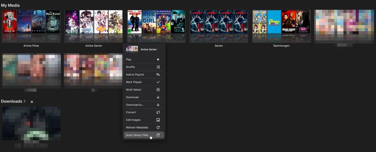

Happy2Play 9811 Posted December 9, 2024 Posted December 9, 2024 Simple library scan should see the changes, depending on actual setup RTM should see them also if working. But note you can add but not completely remove any given node as the DB will always repopulate.

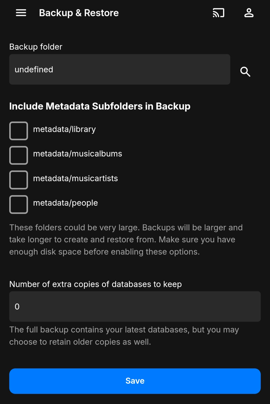

Luke 42241 Posted December 12, 2024 Posted December 12, 2024 On 12/9/2024 at 7:07 PM, DragonSkills99 said: The only thing still bugging me, is that some entries get resetted from time to time randomly and also the playstates, so I have series show up as "unplayed" that I already completely watched. And it's quite annoying to fix it... Is there maybe an backup of those anywhere? Hi, if you use the server backup process, then you will have a copy of your user data in there: Configuration Backup
DragonSkills99 4 Posted December 12, 2024 Author Posted December 12, 2024 2 minutes ago, Luke said: Hi, if you use the server backup process, then you will have a copy of your user data in there: Configuration Backup I've never set anything up, so that won't help me, but thanks for the tip... 1
