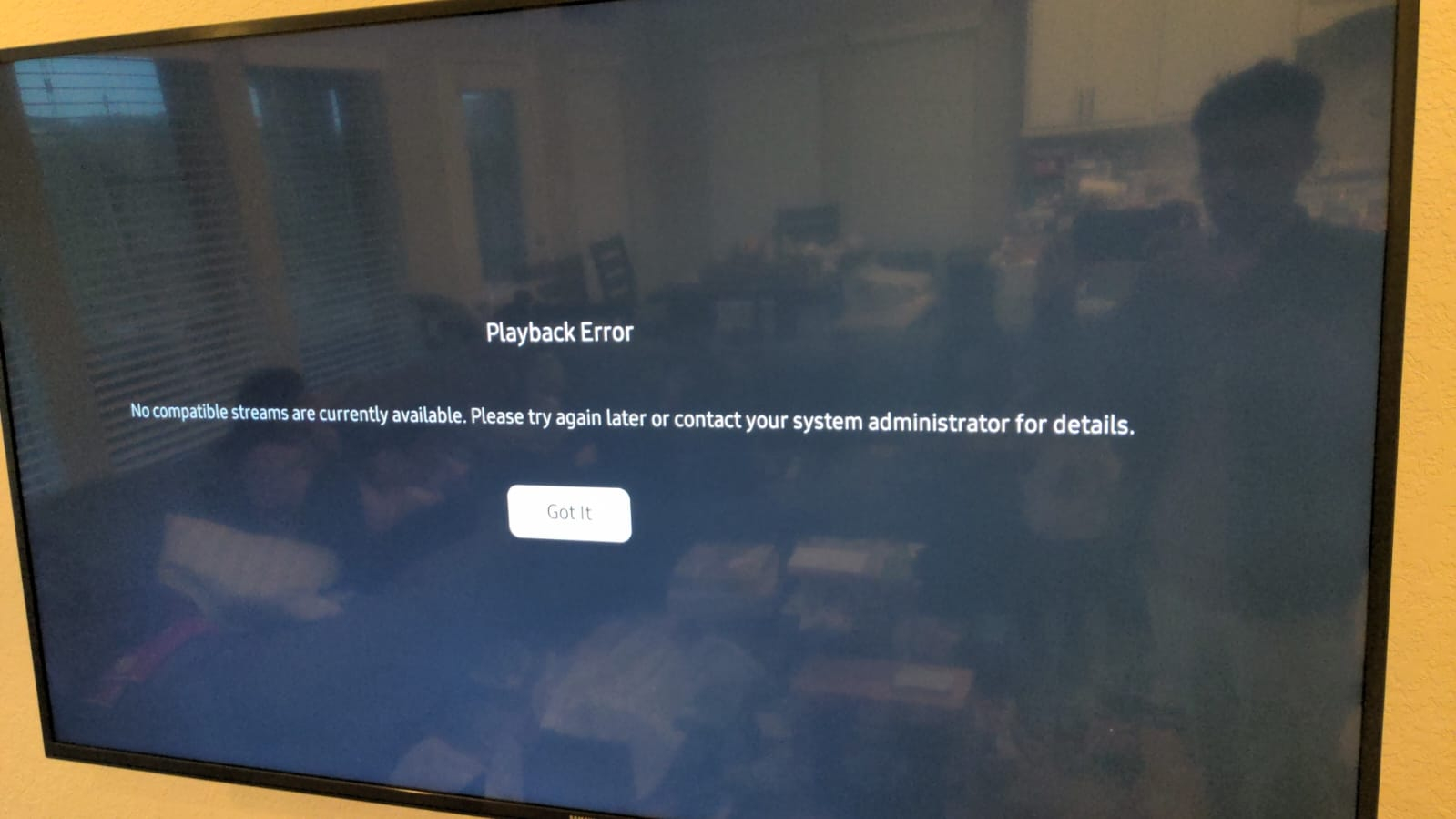

Azra3l 6 Posted December 9, 2024 Posted December 9, 2024 Hello! I've been constantly getting this error message on a single device in the family. For everyone else, its been working perfectly fine. The said device is a 2015 Samsung Smart TV with Emby App installed. Everytime I start a movie, I can see the notification on the Emby Dashboard and within seconds I get the attached screenshot. Please advise on how to troubleshoot.

Azra3l 6 Posted December 11, 2024 Author Posted December 11, 2024 One remote device won't play any videos, it says "playback error no compatible streams are currently available". It's only this one device, and this same account (through Emby Connect) can use other devices without issue. It's any video of any kind, and it worked until recently. It shows up for a split second in the dashboard and then disappears. The device is a Samsung Smart TV (UN55KU6300) running client Emby for Samsung 1.9.2. There is no ffmpeg log (it historically used direct play). There did not appear to be any debugging options in the client app. They uninstalled/reinstalled the app and signed out/in. The server is on Linux (Ubuntu Server 22.04.5 LTS), running Emby Server 4.8.10.0. I have reinstalled Emby, patched the server, and rebooted in an attempt to resolve this. Pleas find attached the logs. embyserver(1).txt
