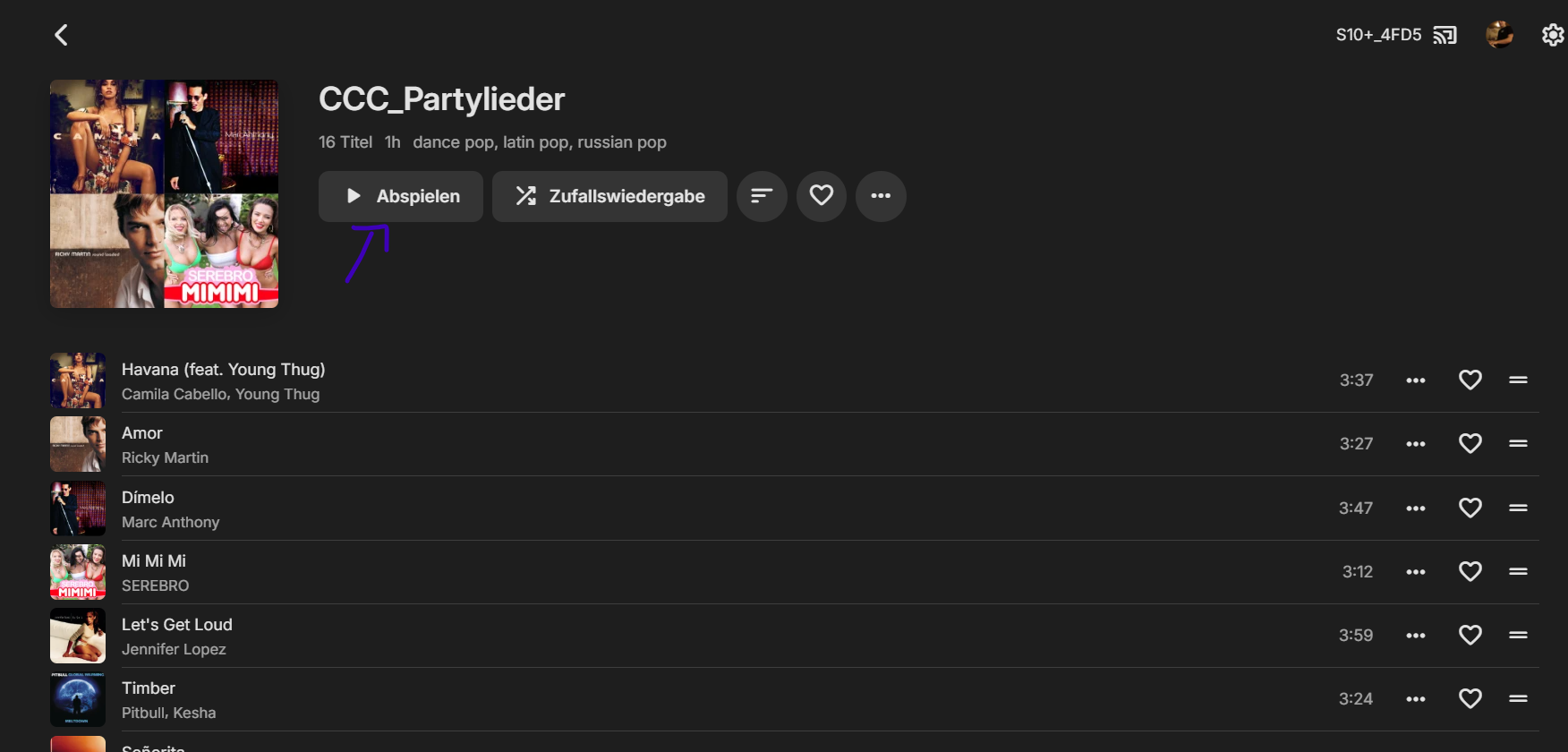

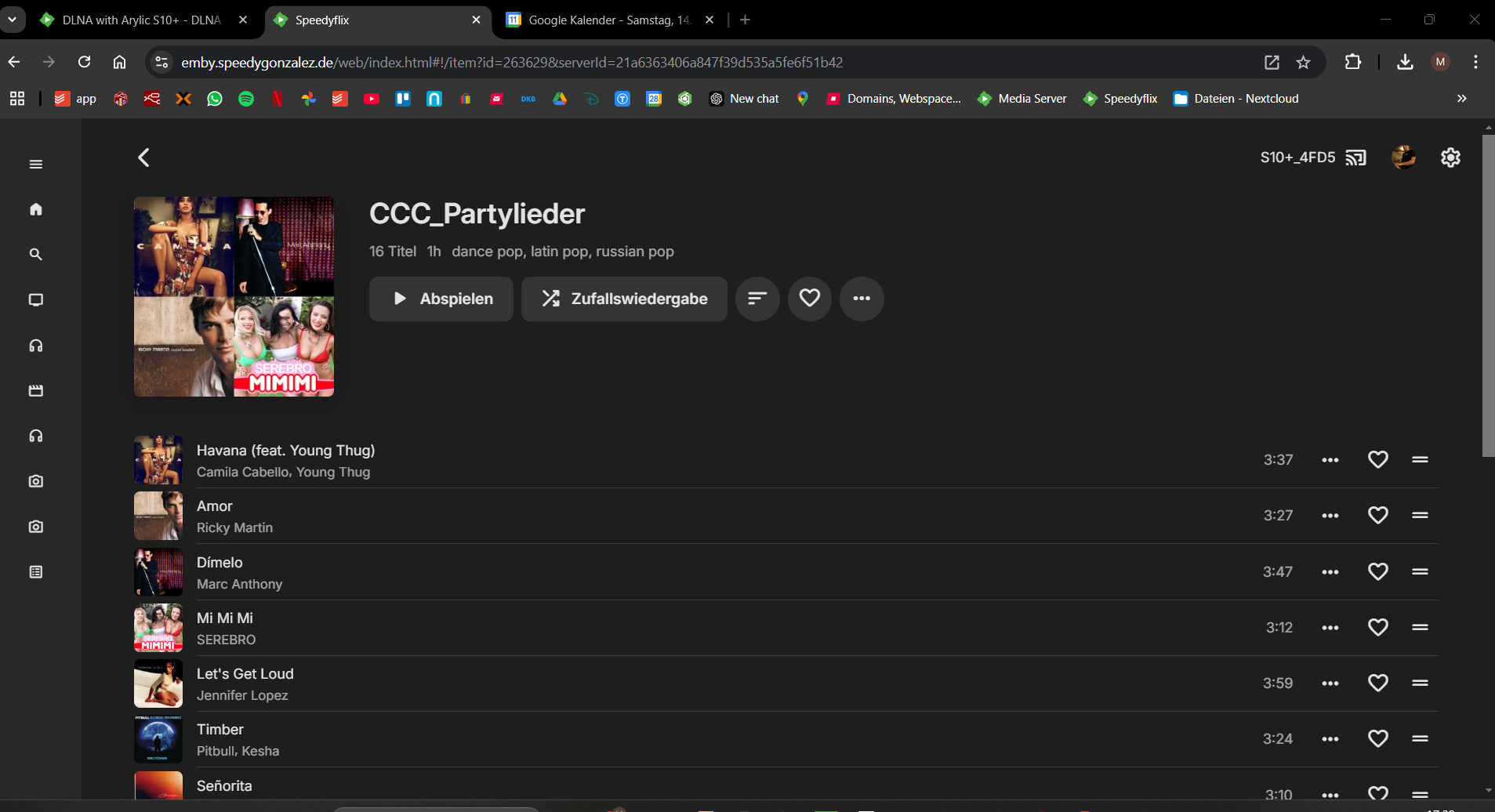

speedy0815 3 Posted December 11, 2024 Author Posted December 11, 2024 In this example with play the direcory the complete toolbar does not sow up. (the toolbar on the web, you see on the downside). As I wrote, if you want we can start an onlinesession. e.g. zoom or discord, or whatever software you want

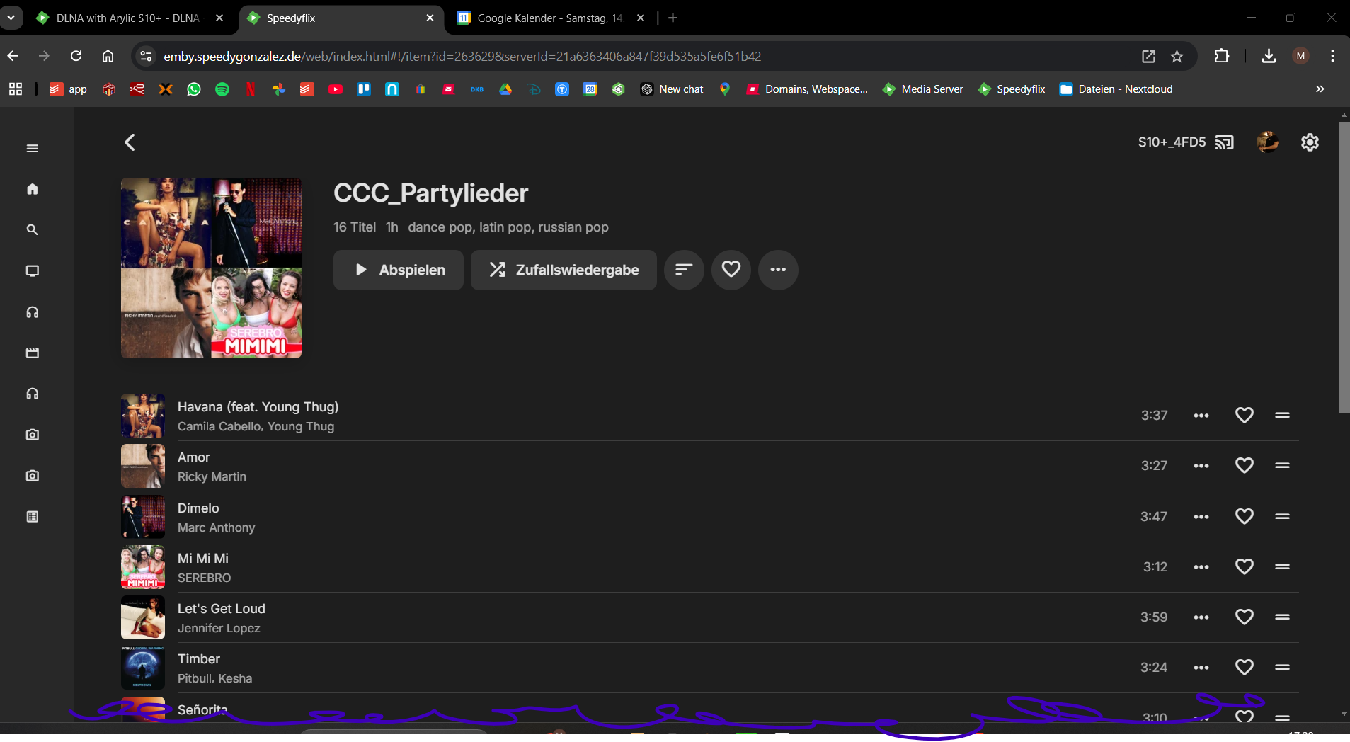

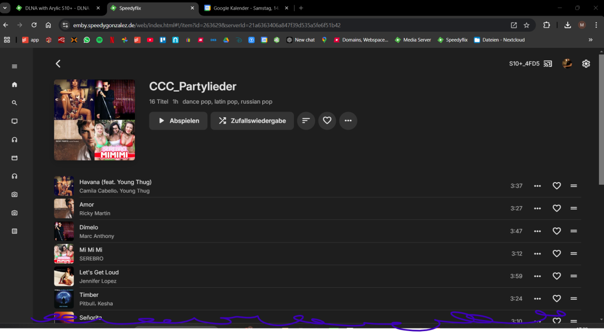

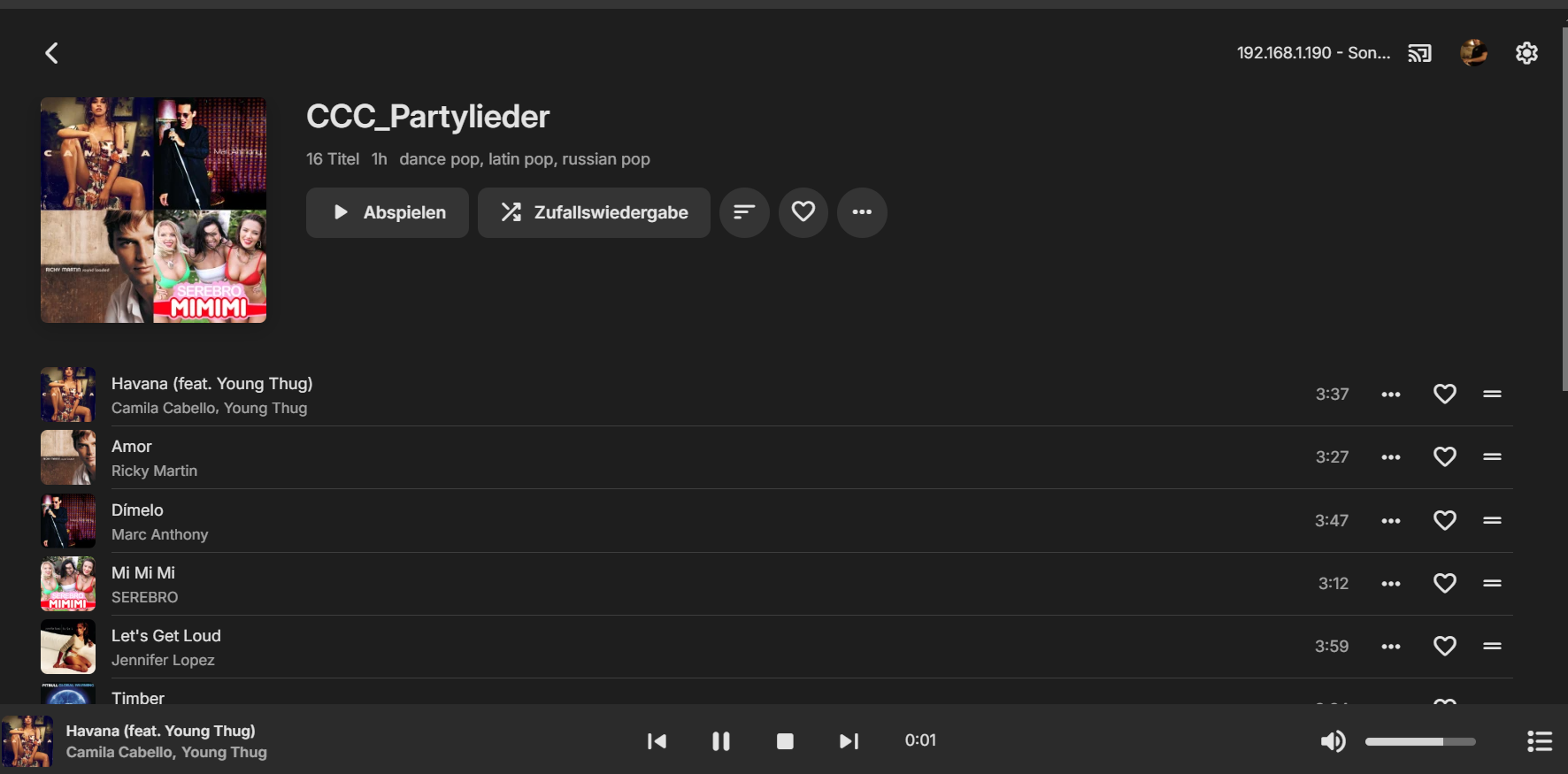

speedy0815 3 Posted December 11, 2024 Author Posted December 11, 2024 I'm sorry, I can not reproduce it everytime exactly. the behaviour is strange. picture 1: This Button I press on the bottom the toolbar is missing picture 2: (working, on Sonos device) sometimes the toolbar showes up.... than I press next title and nothing happens. I attache also the log from now. embyserver (3).txt
Luke 43719 Posted December 11, 2024 Posted December 11, 2024 15 minutes ago, speedy0815 said: I'm sorry, I can not reproduce it everytime exactly. the behaviour is strange. picture 1: This Button I press on the bottom the toolbar is missing picture 2: (working, on Sonos device) sometimes the toolbar showes up.... than I press next title and nothing happens. I attache also the log from now. embyserver (3).txt 203.13 kB · 0 downloads Hi, what does the play queue screen look like in emby server when this happens?
