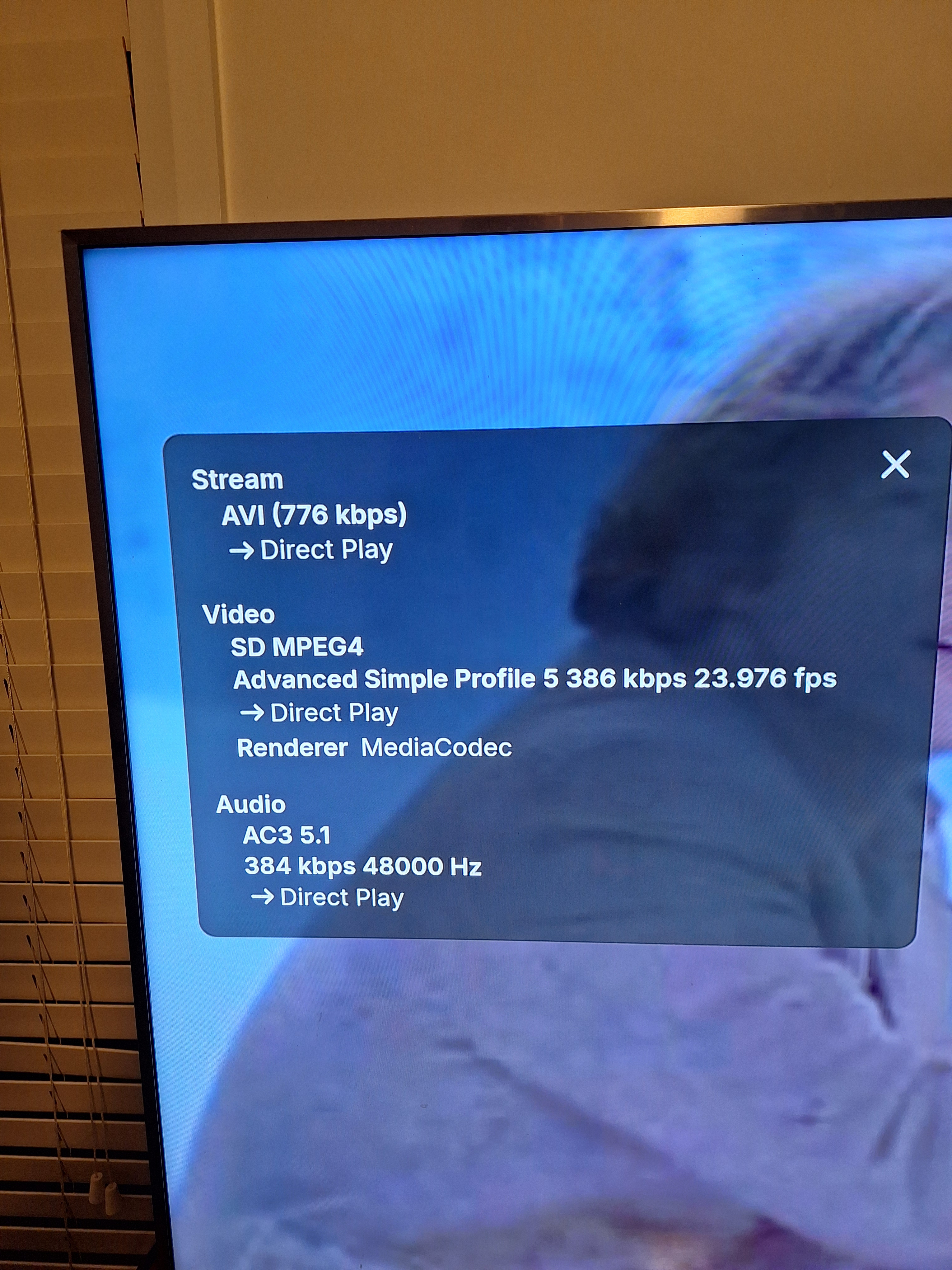

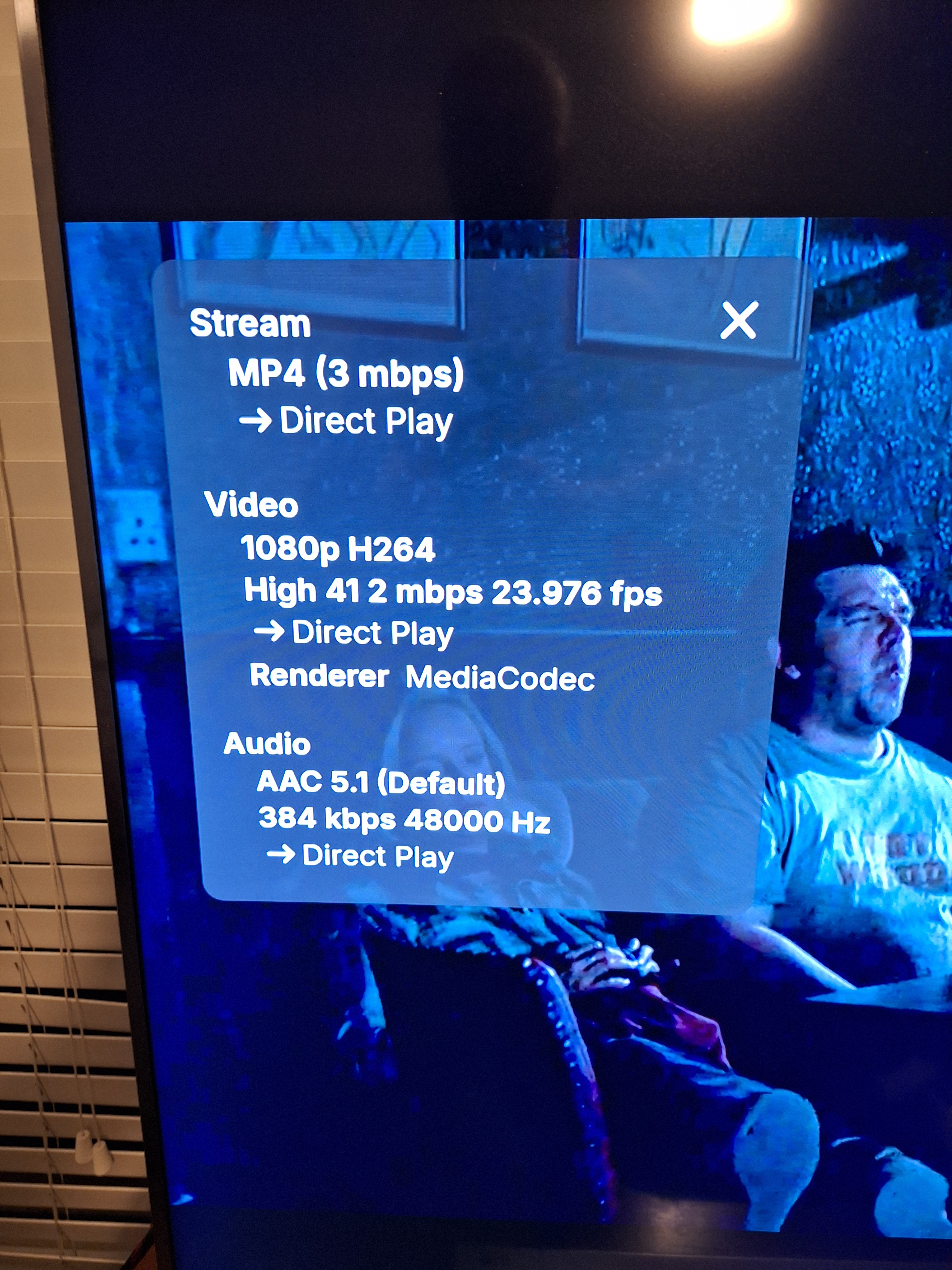

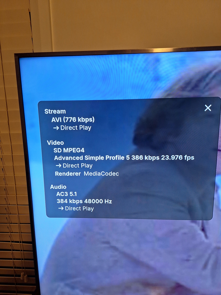

furnibird 6 Posted December 7, 2024 Posted December 7, 2024 Hi all, I am a complete noob to Emby, I have been using Kodi since the xbmc days and have decided to switch over to a server for in home and travel. So far so good, I gave plex and jellyfin a go and Emby is the best by far. At present I am testing, running the server on my main pc, with the server accessing media on the usb drive attached to my nvida shield (drive is network mounted). This is running well so far for both in and out of home streaming. The android app on my phone worked well and volume between files is fine. The issue I have found is, the standard android app and the android tv app when playing the same file play at very different levels. The android tv add seems OK and files play at the same level however, the standard app plays with very low volume on same files. AAC 5.1 file I have can be barley heard on standard app but fine on android tv on my nvidia shield. Now I know the solution is, use the android tv app however, I thought I would pass on the info and I do like the horizontal viewing options in the standard app. Otherwise well done to all.

furnibird 6 Posted December 13, 2024 Author Posted December 13, 2024 Yes both direct play. I just tested again. The file plays very different between apps. The volume is normal as are other files in android tv app but can't hear it in original app. All other files so far or OK.

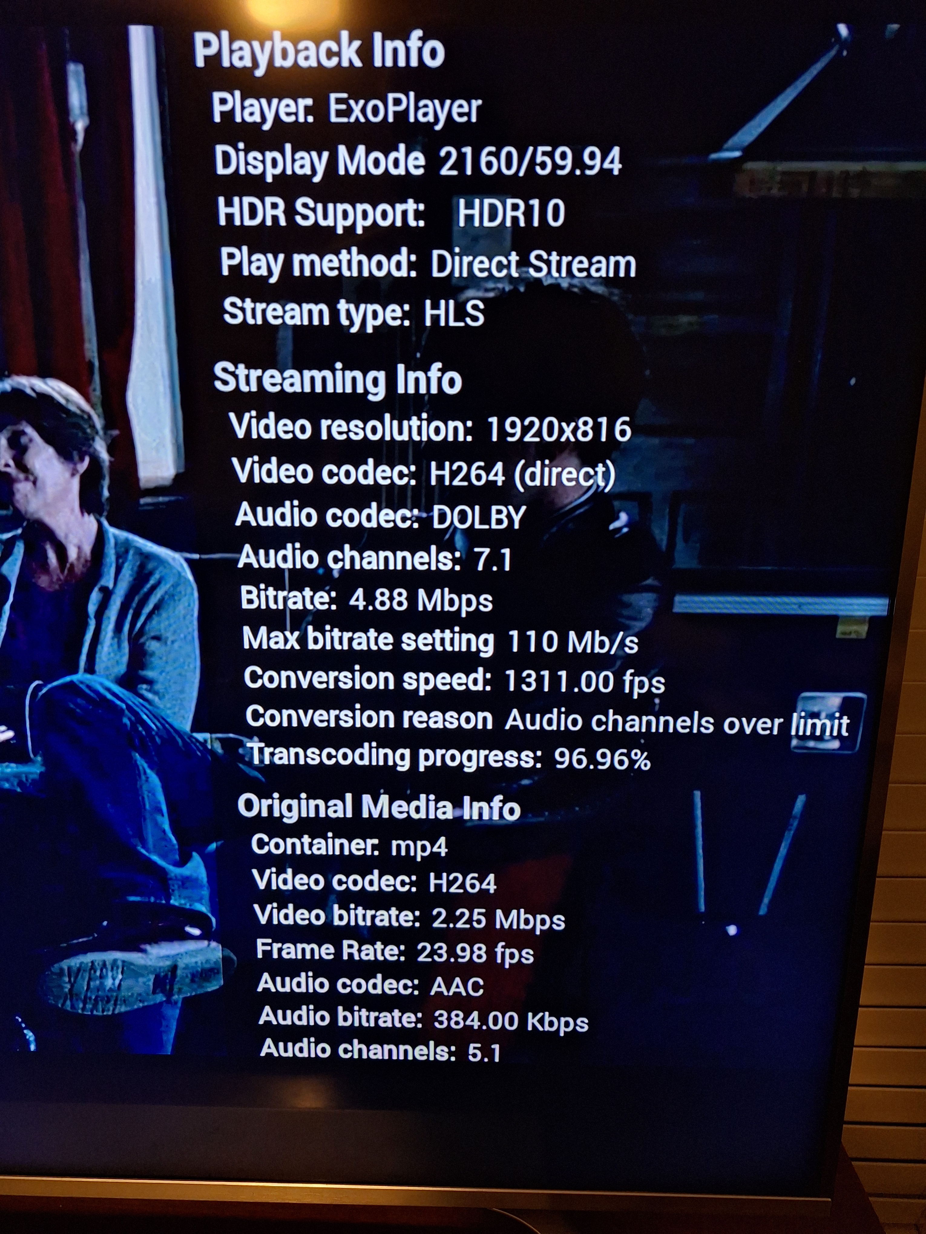

ALD76 26 Posted December 13, 2024 Posted December 13, 2024 (edited) The Android TV app is not direct playing it is direct streaming as the audio is being transcoded to AC3. Some devices like the Fire Cube 3 play AAC quietly so AC3 will be a lot louder. Edited December 13, 2024 by ALD76
Lessaj 484 Posted December 13, 2024 Posted December 13, 2024 These examples aren't the same video though, not sure how we're supposed to compare between the apps if you didn't use the same video for both examples. But try setting this to 1.5 under Transcoding and see if that helps.
ebr 16335 Posted December 13, 2024 Posted December 13, 2024 27 minutes ago, Lessaj said: These examples aren't the same video though Correct. The two examples are completely different formats, containers, streams, etc. They are also playing back differently. Please test with the exact same item. 28 minutes ago, Lessaj said: But try setting this to 1.5 under Transcoding and see if that helps. That won't help in this case as the one he says has low volume is not transcoding.
Lessaj 484 Posted December 13, 2024 Posted December 13, 2024 2 minutes ago, ebr said: That won't help in this case as the one he says has low volume is not transcoding. I agree that it won't make a difference if it's not transcoding but the examples provided were confusing and one of them looks like it's audio transcoding so it could be a factor. But really need to see a result for the same file in both apps.
furnibird 6 Posted December 13, 2024 Author Posted December 13, 2024 Sorry my bad, selected wrong photos. If you need anymore info I have time this weekend. Direct play volume as I said is fine in android tv app but very low in sideloaded original app on my nvidia shield. I have been using the android tv app with no issues.
Luke 42242 Posted December 18, 2024 Posted December 18, 2024 HI, one is direct playing and one is transcoding with the server. Usually most users want to direct play as much as possible and avoid conversions. So they're playing in two different ways. Are you able to just turn up the volume?
