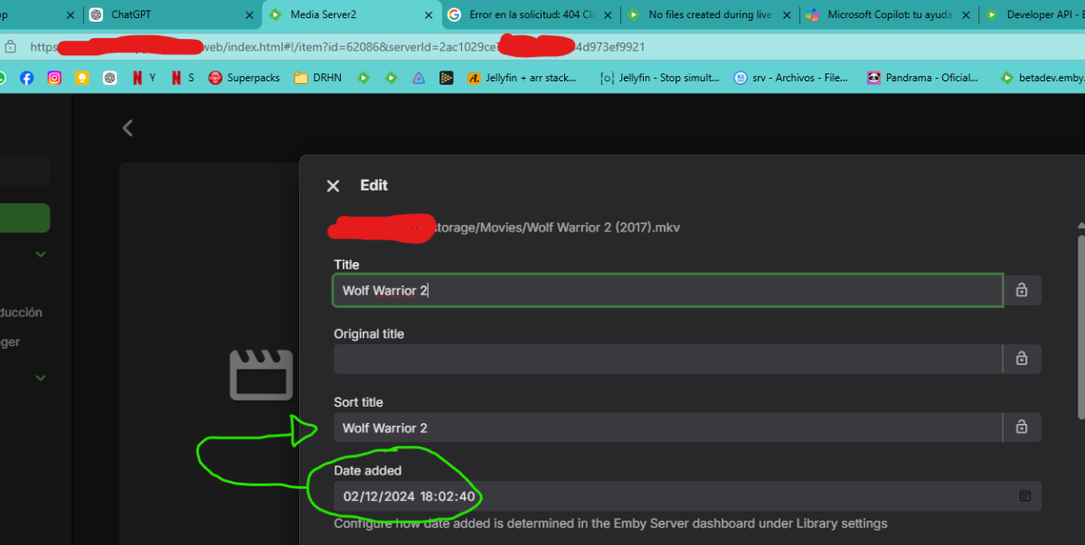

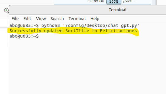

danielromerohn 0 Posted December 6, 2024 Posted December 6, 2024 I created a script in chatgpt because I don't know how to program, I don't speak English either, I use Google Translate. I want to make a script that gets the date an item was added and then stores that value in the sortname field. But for now I just want to change the sort title and when I manage to do that I will adapt the script for my final purpose. Can someone tell me what is wrong? Script python: import requests # Configura estos valores según tu servidor Emby EMBY_SERVER_URL = 'https://XXXXXXXXX.com' API_KEY = '5d95c9fa770e4fddbbd224db882aXXXX' USER_ID = 'c2e0b7e5700b4dad9fea3affe388XXXX' ITEM_ID = 62086 def update_sorttitle(item_id, sorttitle): get_item_url = f'{EMBY_SERVER_URL}/Users/{USER_ID}/Items/{item_id}' headers = {'X-MediaBrowser-Token': API_KEY} # Obtener el ítem actual response = requests.get(get_item_url, headers=headers) try: response.raise_for_status() item = response.json() except requests.exceptions.HTTPError as err: print(f"HTTP error occurred while getting item: {err}") return except requests.exceptions.RequestException as err: print(f"Error occurred while getting item: {err}") return except ValueError: print("Error decoding JSON response while getting item") return # Actualizar el campo SortTitle item['SortTitle'] = sorttitle # Enviar la actualización update_url = f'{EMBY_SERVER_URL}/Items/{item_id}?api_key={API_KEY}' response = requests.post(update_url, json=item, headers=headers) try: response.raise_for_status() print(f'Successfully updated SortTitle to {sorttitle}') except requests.exceptions.HTTPError as err: print(f"HTTP error occurred while updating item: {err}") except requests.exceptions.RequestException as err: print(f"Error occurred while updating item: {err}") except ValueError: print("Error decoding JSON response while updating item") # Llamar a la función para actualizar el SortTitle update_sorttitle(ITEM_ID, 'Felicitaciones') Sincerely
Luke 42234 Posted December 6, 2024 Posted December 6, 2024 Hi, you also need to lock the field or the server may end up changing it on you. Notice how when using the metadata editor, it auto locks any field you touch.
