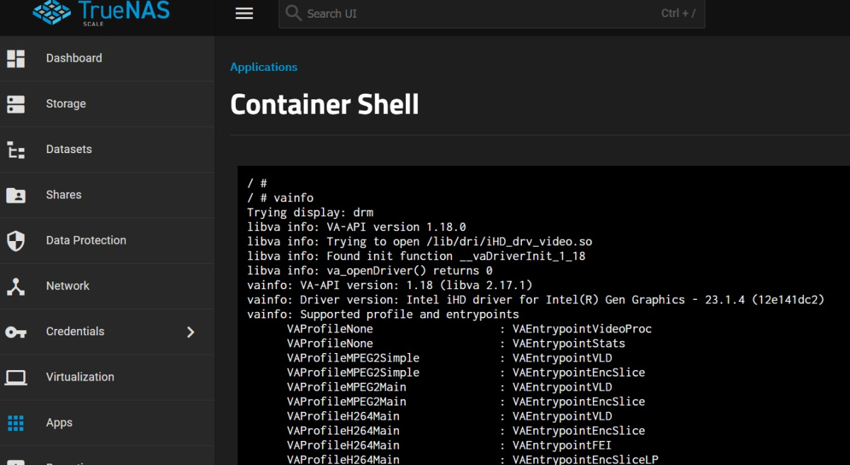

masterabc 1 Posted December 6, 2024 Posted December 6, 2024 I build a truenas system ElectricEel-24.10.0.2 with this processor i3-n305 I purchased emby premiere for one month. Emby still doesn't detect any hardware acceleration. However, if I connect to a shell in the emby container and run vainfo it detects many profiles. What I can do?
masterabc 1 Posted December 6, 2024 Author Posted December 6, 2024 Some additions: Container is running as root and the container has the device configuratio: Devices:[ { CgroupPermissions:"rwm", PathInContainer:"/dev/dri", PathOnHost:"/dev/dri" }

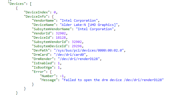

softworkz 5133 Posted December 7, 2024 Posted December 7, 2024 @masterabc - Can you please post the hw detection log?

masterabc 1 Posted December 8, 2024 Author Posted December 8, 2024 Here's the hw detection log hardware_detection-63869117889.txt.crdownload
softworkz 5133 Posted December 9, 2024 Posted December 9, 2024 Thanks, so it seems that it cannot open the device: Under which user account is Emby server running? You can check the owner of the hw detection log on disk for example to see this.
masterabc 1 Posted December 9, 2024 Author Posted December 9, 2024 In the container it's owner 568: apps. Then I gave apps the groups video and render in the truenas os outside of the container. But still no success in accessing the device.
softworkz 5133 Posted December 9, 2024 Posted December 9, 2024 10 hours ago, masterabc said: In the container it's owner 568: apps. Then I gave apps the groups video and render in the truenas os outside of the container. But still no success in accessing the device. How about inside the container? Doesn't it need those permissions inside the container rather than outside? And I'm not sure whether "apps" is the right user. Unfortunately I'm not the right one to help as I'm not familiar with TrueNAS and our package for it. @alucryd- Can you help?
