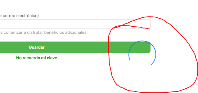

Juanrendon 4 Posted December 20, 2024 Author Posted December 20, 2024 3 hours ago, guunter said: Sí, si haces que todo sea exactamente igual, no deberías tener ningún problema. Por supuesto, solo tendrás que cambiar la configuración de transcodificación de hardware, ya que se trata de un hardware diferente. Thanks for your reply, everything went well except that I have a conflict with the Emby Premiere key since the same one from the previous server was saved. I bought a new Emby Premiere key for this server and it still keeps loading. It could be because the backup server key is still in the file system. Do you know where this Emby Premiere key will be stored so that I can delete the one from the other server and avoid a conflict?

Juanrendon 4 Posted December 20, 2024 Author Posted December 20, 2024 1 hour ago, Q-Droid said: No exactamente. Debes asegurarte de que el nuevo servidor se parezca al antiguo ANTES de intentar ejecutar Emby. La instalación iniciará el servidor automáticamente y, si falta algo o no coincide en este punto, no funcionará con la misma fluidez. La clave de estreno no es por servidor, es tuya. La misma clave se puede usar en varios servidores, por lo que no tiene sentido que veas un conflicto. Good morning, someone has reported this in the past as well. I share the forum link.
Q-Droid 1011 Posted December 20, 2024 Posted December 20, 2024 Two things. The thread you linked covers duplicate server IDs and problems it can cause with Emby Connect. This is true and the thread also instructs how to correct it. You don't need to buy a new premiere key for each server. They can be shared and barring conflicts like the one above they will operate as expected. The same server ID and same Premier key will not keep your servers from running. Only certain features might have problems.
