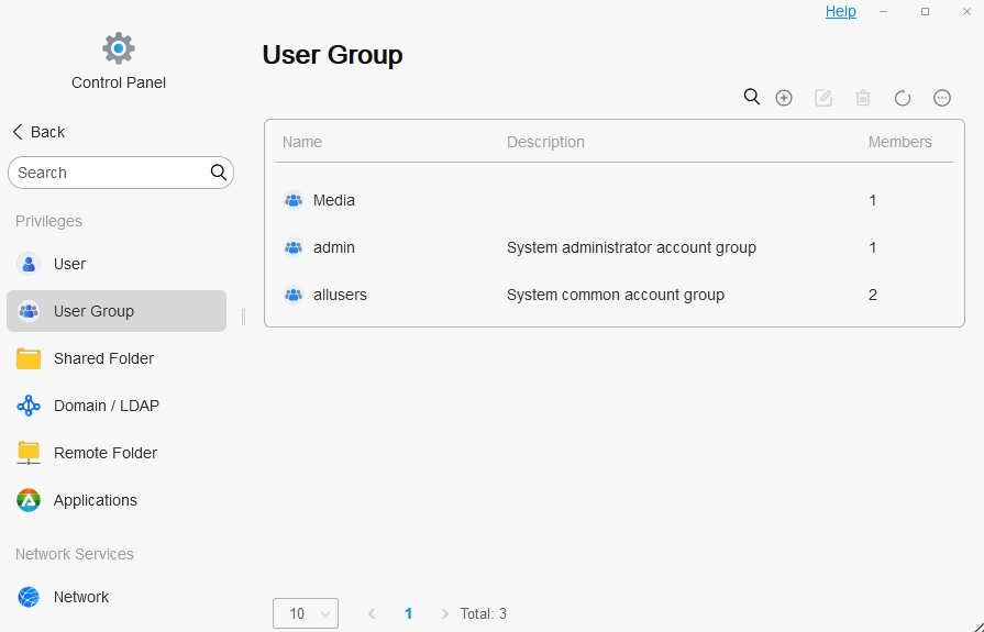

  1. Created a group named "media" in the TOS web UI
  2. Gave the "media" group access to the folders I designated for emby through the TOS web UI

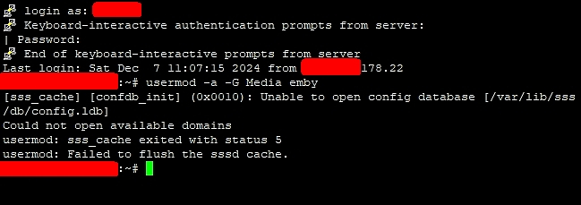

Many thanks for your reply! Unfortunately your suggested method doesn't work for me. I get this error message:

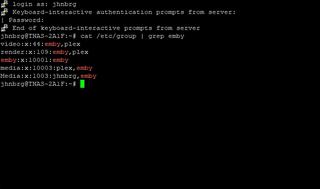

I see the failed to flush ssd cache error message as well.  Note that the emby account will NOT be displayed in the TNAS web UI, but if you go back to the ssh console and type in the following, you'll see that emby is now a member of the "Media" group at the OS level which is what counts for getting access.
cat /etc/group | grep emby
Yes, you're absolutely right. emby is now a member of the "Media" group.
