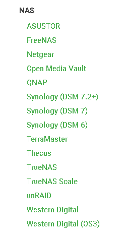

Carlo 4561 Posted December 31, 2024 Posted December 31, 2024 Hi @TecEmbryo Currently we support 3 different branches for Synology as you can see in the pic above taken from our download page. You're currently running the DSM 7 version of Emby, which is the second/middle branch shown above. For the 920+ NAS this is the latest version (as of this writing). Synology 7 (Use for DSM versions starting with 7.0 or 7.1) https://github.com/MediaBrowser/Emby.Releases/releases/download/4.8.10.0/emby-server-synology7_4.8.10.0_x86_64.spk That's the 4.8.10.0 version for DSM 7.0 & 7.1) for 64 bit CPUs. Check the current version of your Emby Server. If it's not 4.8.10.0 at present, download the above and install it via package manager before doing the DSM upgrade. This will make sure you're running the latest version. Go ahead and update DSM to the latest 7.22 version and restart the NAS. Once restarted, download and install the file below. Synology 7.2 (use for DSM 7.2 and greater) https://github.com/MediaBrowser/Emby.Releases/releases/download/4.8.10.0/emby-server-synology72_4.8.10.0_x86_64.spk This is the same 4.8.10.0 version of Emby Server, only it's built using the Synology 7.2 framework libs. Technically, you could probably just update DSM to 7.2x then install the 7.2 version of Emby above, but I prefer to make sure Emby Server is running the same version before and after the DSM update. Carlo
